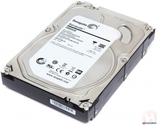

 Post subject: how to connect to terminal
PostPosted: October 30th, 2015, 11:12
Posts: 242
hot to connect with terminal

bsy error
 Post subject: Re: how to connect to terminal
PostPosted: October 31st, 2015, 17:45
Posts: 331
The 7200.11 BSY error fix is does not works on 7200.14 drives.
About terminal connections: Use two pins that nearest to SATA connectorand use 38400 kbps connection.

i connect but there is no response in it

if there nothing in the terminal log when you power on the the drive, then something is wrong with settings and or with the wiring

another hard disk(500gb) connected but 2tb is not connected
PostPosted: November 1st, 2015, 6:06
Posts: 242
its not show in bios

the drive spins at all ? do you hear any unusual noise, clicking, clunking, beeping Etc. ?

there is no noise like head damage
