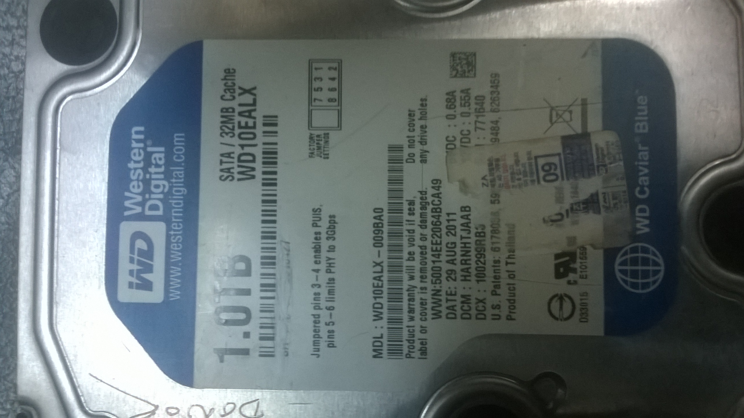

I want to find a donor (head swap) for drive WD10EALX-009BA.
i know that model and firmware must mach, but there is no firmware number indicated on the drive.
can someone explain, what numbers must match when finding Western Digital donor drives
WWN: 50014EE2B0F88183
DATE: 31 AUG 2011
DCM: EANNHTJCAB
DCX:3005998B2
FOTO
https://drive.google.com/file/d/0B9FnilkuXP4AY0VTdjd0bUJBb1k/view?usp=sharing

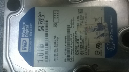

This Is what i have. Most close

 Post subject: Re: help to find donor drive for wd10ealx
PostPosted: November 19th, 2015, 16:33
Looks suitable to me
+1
i like the DOM
