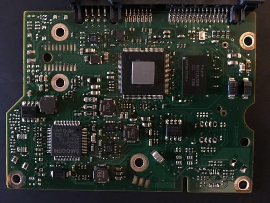

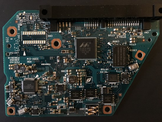

I got a second drive with same problem. I got pics of the PCBs here, let me know if it's good enough quality. Thank you!

Actually I'm pretty sure this one is a native Toshiba 3.5", not a re-branded Hitachi. So no NVRAM, just a ROM full of CP's.
 Post subject: Re: Toshiba 4 tb HDD does not spin
PostPosted: December 23rd, 2015, 18:24
The 8 pin chip located at IC10 is what you'd need to transplant to another donor PCB board to make it compatible. You might want to check the diode located at CN1 and the other one next to it with a multi-meter to see if it's short circuited. If it is, you can simply remove it.
As for the other Seagate PCB there, check the zero ohm resistors near the power connection to be sure they read 0 ohms. Then also check the two large diodes on the right side to see if they are shorted.
