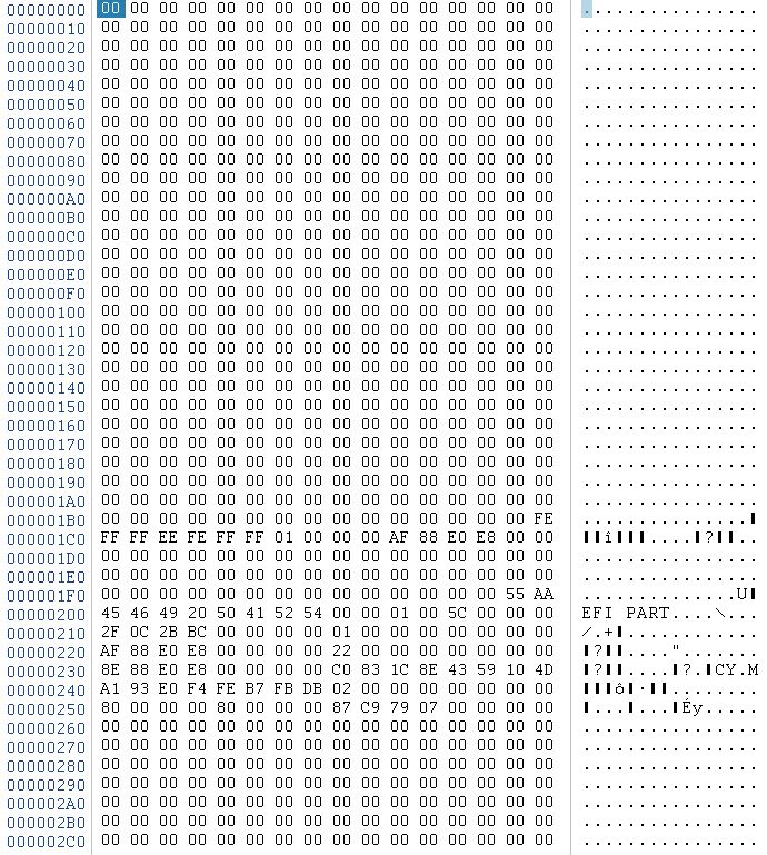

No water damage to the drives, they have been imaged. Will post pics of PCB. Not concerned about cost of replacing PCB, I just haven't been able to find the part, 4061-775137-003, anywhere.

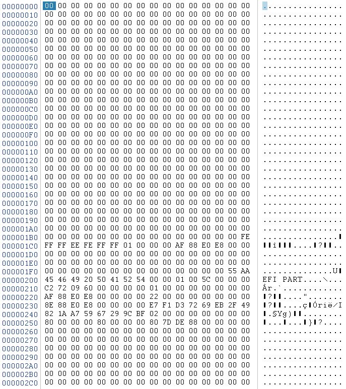

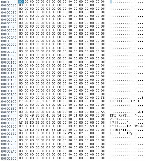

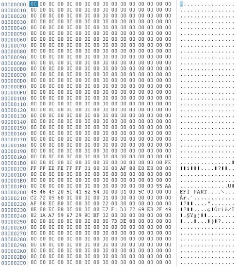

See pics
 Post subject: Re: WD Passport Pro 4TB recovery
PostPosted: December 18th, 2015, 13:27
So, it doesn't look like they're encrypted :-)

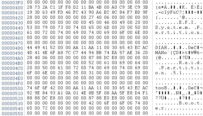

PostPosted: December 18th, 2015, 13:36
Joined: March 24th, 2010, 21:08
Posts: 111
Location: California
this too

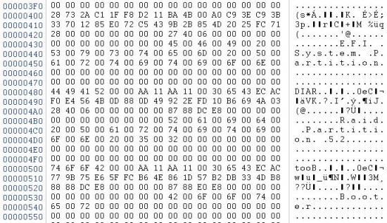

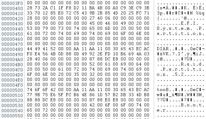

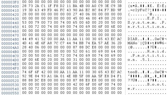

Yes, indeed, it is not encrypted. I hadn't done a hex search yet, had just finished imaging when I originally posted and was assuming it was encrypted like other Passport drives. UFS Explorer detects this

The RAID volume begins and ends at sectors 0x64028 to 0xE8DC8887. I would examine sector 0x64028 on both drives.

PostPosted: December 18th, 2015, 20:19
Posts: 111
Success! I've found the correct parameters and am currently extracting the data now. Block size was 32KB. Key to rebuilding correctly was ignoring the EFI partitions on each drive and building the RAID0 starting at sector 409640 on each drive. Oddly despite the correct settings UFS Explorer still wasn't able to detect partition contents but R-Studio loaded it up without any problems.
