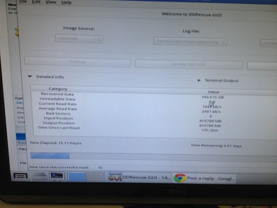

Now running drive clone using ddrescue in parted magic live cd.
Is that normal the process take 2 day for complete?
I'm using backward / reverse clone because with normal process is take time 14 days.

Hi this is the hdd gui result.
Sorry i don't know how to spoiler attached file.
Still wait until 4 days,
So the better way is stop the process?

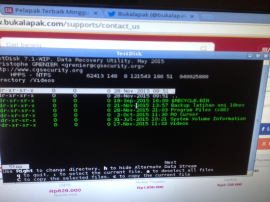

Failed using ddrescue, it's says the destination drive is full. But I already prepare 2 tb wd drive for backup.
I decide analyze using testdisk and get this result.
I try to copy but always failed.
Any suggestion for newbie like me, and sorry my english is very bad.
