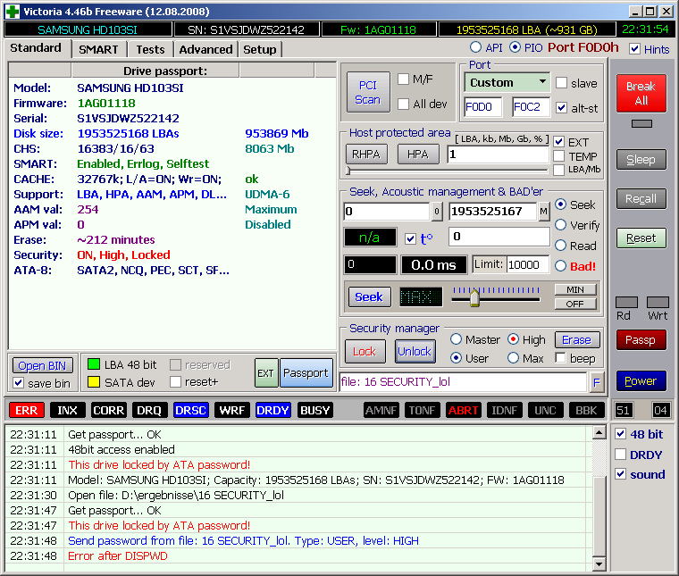

i have try to unlock two HD103SI Drives.
I dont know the password, i believe a virus may set to locked mode with random password.
I have a another bunch of WD green series drives that i could unlocked with a master password (wdcwdc...).
To unlock the two Samsung drives i have read a unlock thread about a HM160HC drive:
http://forum.hddguru.com/viewtopic.php?f=1&t=28590
I did the same steps and receive this data from the 16 Security Module via SHT2:

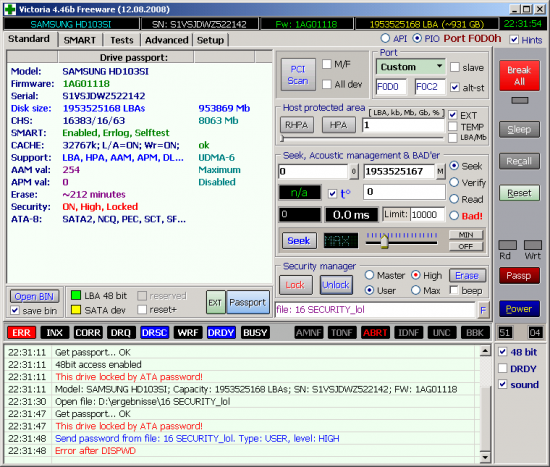

After reading the HM160HC thread i expect the password in offset 00000040 to 00000050.
I have tried this (and other variants e.g. 00000030 to 00000040).
Additionally to use Vicoria 4.46 b to unlock i used HDAT2 in MS-DOS.
The assumed password seems to be wrong (see attachment).

Nearly the same data pattern, i hoped i can see a bigger difference betwenn a locked drive and a an unlocked drive to figure out, where the password is.
Can anybody help me to locate the the password?

Password is encrypted. You need just write 0 to 0x10 and write module back to drive. That is it.
