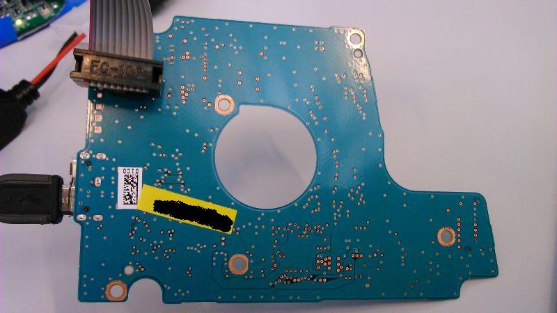

Hello to all the community!
do any of you have the pinout to connect the COM/terminal to the TOSHIBA MQ 2,5" USB boards?
If yes, can you kindly share it?
The goal is to read the ROM through terminal on TOSHIBA USB boards
thank you
Cor

Here you are
Mikippp

Have you soldered two pins in the first two holes of the row?
Thank you
 Post subject: Re: MQ01UBDxx0 TOSHIBA 2,5" USB terminal pinout wanted (if a
PostPosted: January 26th, 2017, 15:12
Posts: 17314
This would be my guess:

Yes confirmed

I'm waiting a reply from the support
I succeeded reading the ROM
But in both Toshiba and USB utilities I can't find the one to write it.
Apparently there is only the read command :-(

Hello Spildit
In other words?
My idea is to avoid heating donor boards moving and removing chips.
So my point of reading the ROM is next to write it in the donor board.
PostPosted: August 4th, 2021, 6:28
Posts: 4840
PC3k can read it but not write, i guess MRT can read it too (could somebody confirm?), writing is possible using a terminal prog (on most families).

Corsari wrote:
Hello
any update about read ROM through terminal on TOSHIBAs MQxxUxxx (USB)
then write the ROM on the corresponding SATA board?
Yes, to avoid heating the SATA donors boards
Thank you
Alternative is reading ROM in circuit via clip and programmer. Have not physically moved a ROM on a hardrive for years :)
