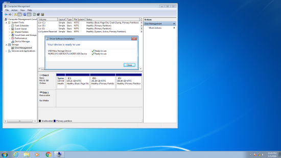

Hello.
I have a 1TB WD External HDD and when I plugged it, Windows show me "NORELSYS USB BOOTLOADER USB Device" and can't open, Format or...
I used some partition manger programs too but Failed.
What is your idea?
Thank you.

As Norelsys make USB charging/controller chips, I'd say the firmware in the USB board is bad, or there is some problem with the board. I guess the HDD could be the fault causing issues to the USB Board, but I would start with the board.
is it possible to put the HDD directly on a SATA port of a PC?

Could we see detailed photos of both sides of the HDD PCB?
I suspect that the board may have one of the following USB-SATA bridge ICs:
http://www.norelsys.com/uploads/soft/NS ... _Brief.pdf
Typically when there is a problem with the firmware for the bridge IC, or sometimes if there is a problem with the HDD behind the bridge, the bridge IC will identify itself with the Product ID and Vendor ID of the chip's manufacturer rather than the PID and VID of the HDD manufacturer.
Does the HDD spin up, or does it make any faint sounds that would suggest it is trying to spin? Did you drop it?
UVCView and USBDeview are two utilities that may tell us a little more about the bridge IC:
http://www.nirsoft.net/utils/usb_devices_view.html
http://download.microsoft.com/download/ ... ew.x64.exe
http://www.users.on.net/~fzabkar/USB_ID ... ew.x86.exe

Yes, When I plug the HDD it Spin and the LED is light.
