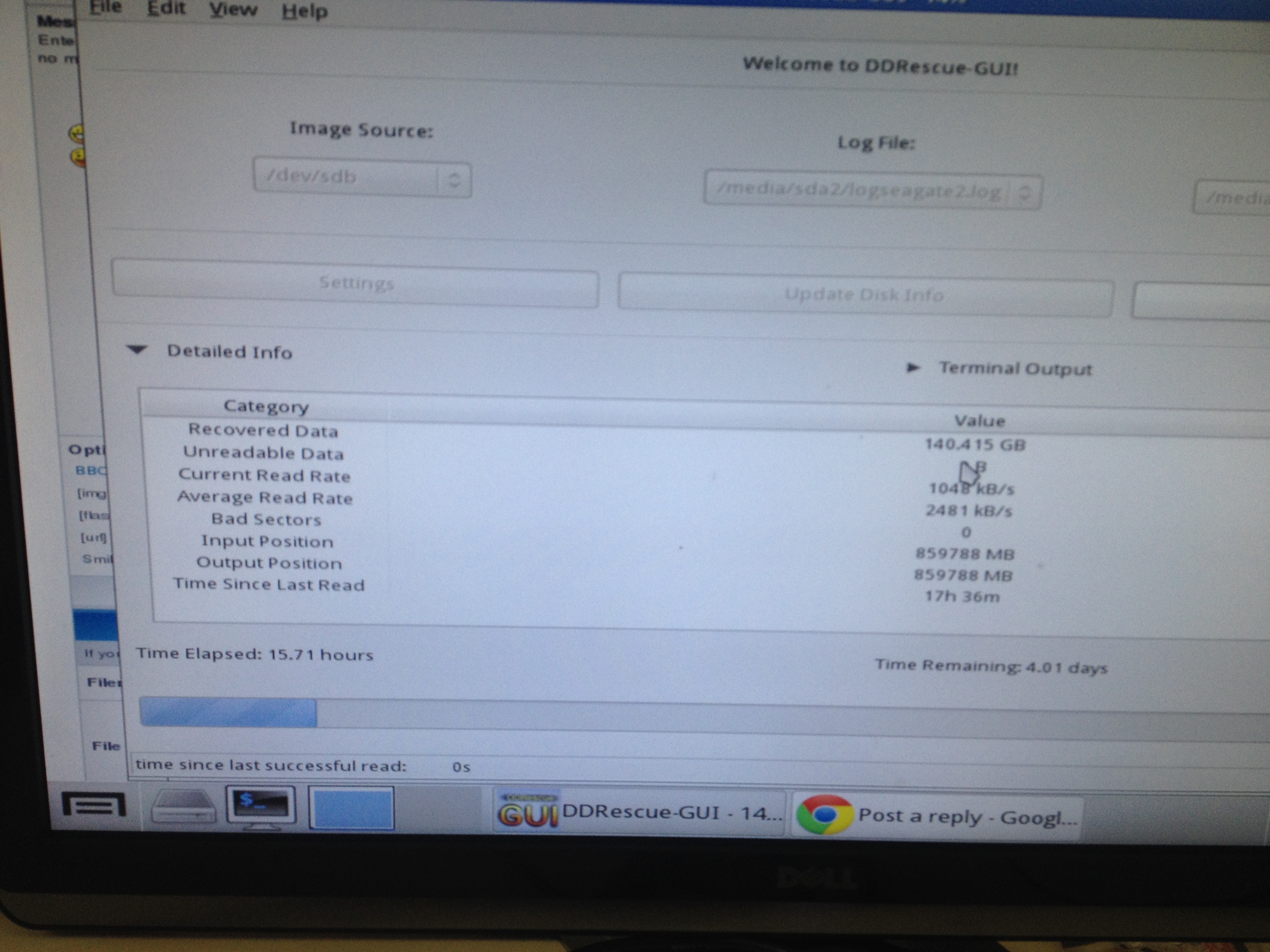

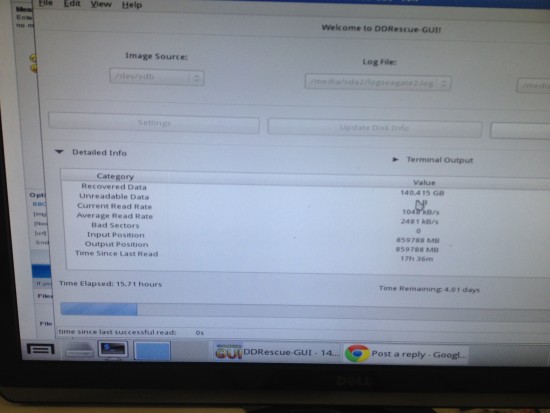

Posts: 17232
See http://www.hddoracle.com/viewtopic.php?f=83&t=557 but read the entire thread.

Hi this is the hdd gui result.
Sorry i don't know how to spoiler attached file.
Still wait until 4 days,
So the better way is stop the process?

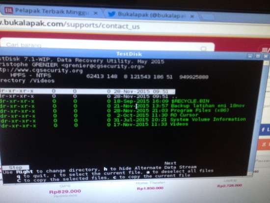

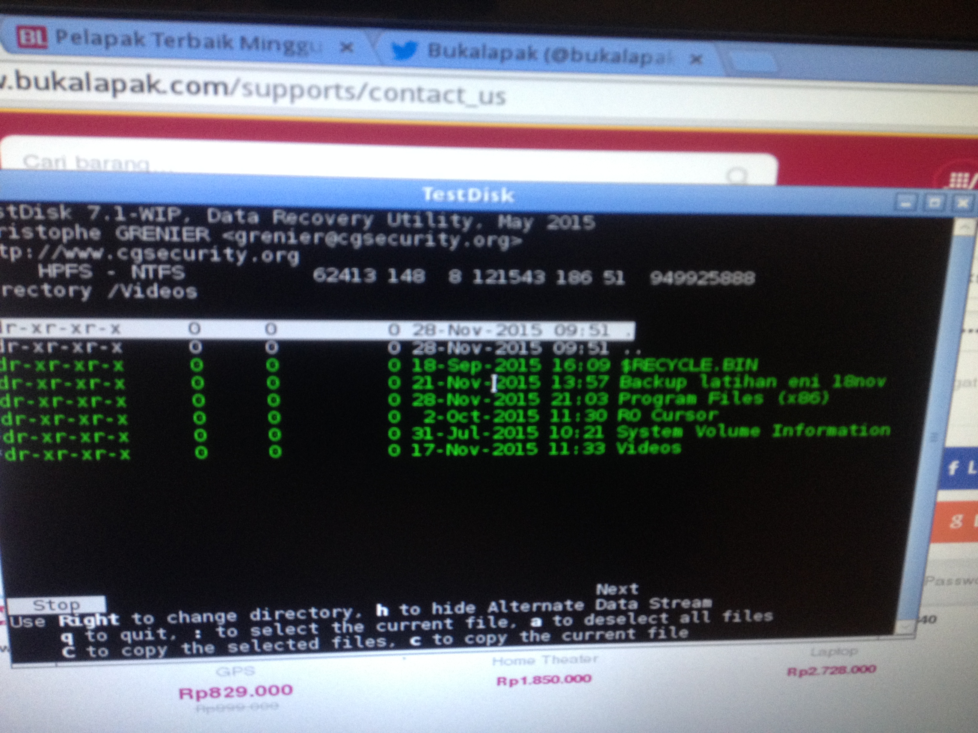

Failed using ddrescue, it's says the destination drive is full. But I already prepare 2 tb wd drive for backup.
I decide analyze using testdisk and get this result.
I try to copy but always failed.
Any suggestion for newbie like me, and sorry my english is very bad.

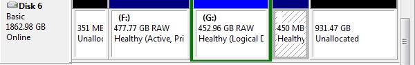

I Succeed clone the drive using clonezilla to my external wd 2 tb.
and the result is like this,
I try using ufs file recovery but can't read the data.
Try using testdisk right now. But still on 80 % in deep search.

Posts: 17232
What is the model number of the Seagate drive?
How many partitions are on the Seagate drive?
I would examine the clone with a disc editor in readonly mode. Could we see the Partitions window in DMDE (freeware disc editor)?
