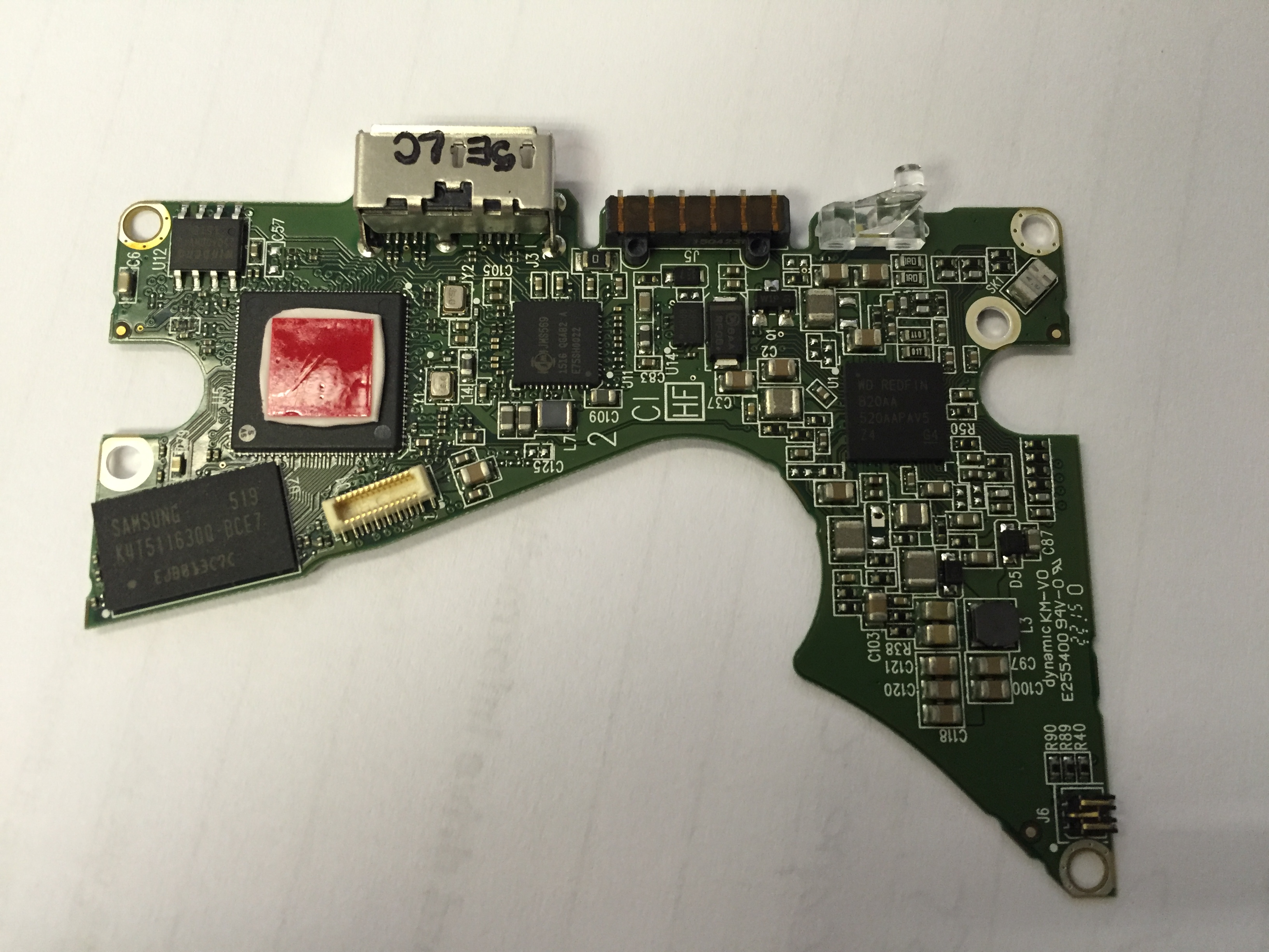

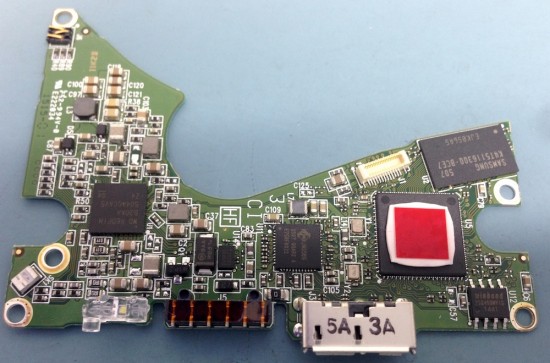

Have you guys had experience with this yet? New PCB layout and different terminal connection. MCU is 88i1047-NDB2

check if there is E71-75 (on the other side), and if there is check if it's the SATA Tx/Rx (probably yes)
 Post subject: Re: New WD 3TB 2.5" Passport
PostPosted: February 12th, 2016, 18:04
Posts: 17316
Obviously you should be looking for two pairs of capacitors and two sets of parallel traces. The bottom of your PCB would probably show them up better.
Here is my guess:
A Google search for PCBs with the 88i1047-NDB2 controller turns up the following candidates:
    2060-771978
    2060-771942
    2060-800001-002
Here is a low res photo of the 2060-771978 PCB:
http://g02.a.alicdn.com/kf/HTB1CYxsIXXX ... For-WD.jpg
You can see the SATA Tx/Rx pins of the MCU.

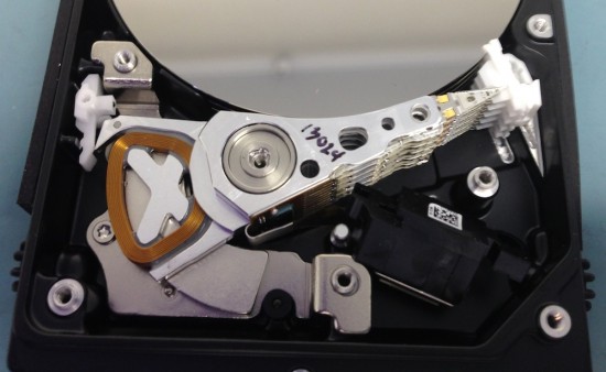

Joined: June 8th, 2006, 19:44
Posts: 3144
Location: Atlanta, GA

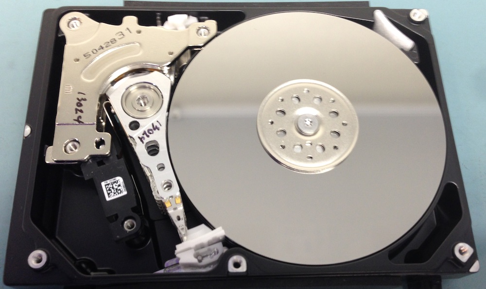

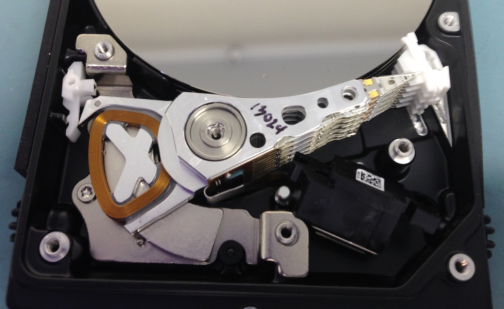

Here are some internal shots.
Note that there is not a lot of clearance for a head comb, due to the nearby post for the preamp connector. 5 platters and 10 heads.
I think the SATA data may be among the two pairs of caps shown going to the bridge IC.
This 3TB drive is from the Spyglass family.
Jon

Would a SATA drive from this series be compatible?
WD30NPRZ - http://www.wdc.com/en/products/products ... d=800#Tab3
PostPosted: March 21st, 2016, 14:38
I think I'd try one of these: http://www.ebay.com/itm/New-WD-Green-WD ... SwuAVW0Mz1
Probably will have the right PCB at least.
What's the board number of the USB PCB? Is it: 2060-800041 ?
PostPosted: March 21st, 2016, 16:29
Posts: 3144
In my case it is 800041.
Jon
http://www.datasaversllc.com
PostPosted: March 21st, 2016, 17:03
Posts: 3598
Location: Chicago
data-medics wrote:
It is compatible
Apparently its PCB is 800022
PostPosted: March 21st, 2016, 19:46
That's what I thought. Thanks for confirming the board number! I've updated my compatibility list: https://www.data-medics.com/forum/wd-pa ... 3.html#p26
