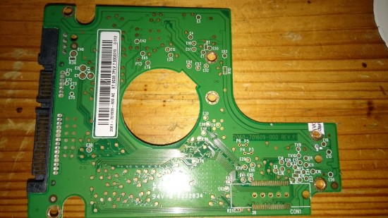

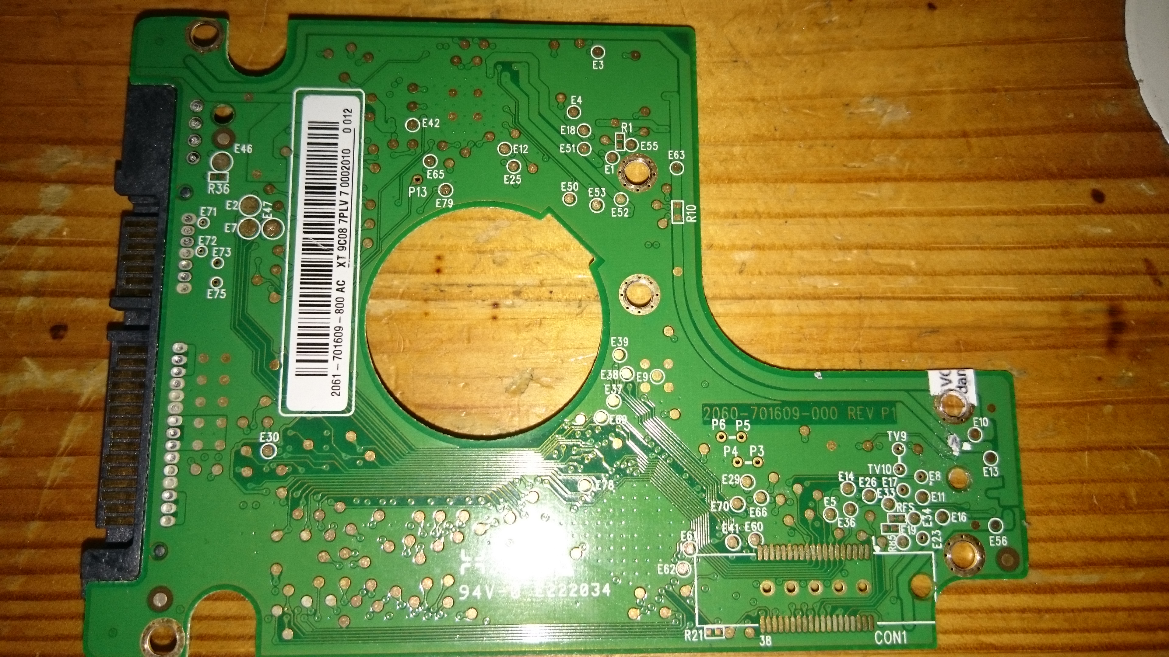

I have a WD 701906 PCB, and MRT Pro damaged the internal ROM (i don't know how) The PCB is worked on a WD5000BEVT-00A03T0 drive (Pluto).
My patient drive is a WD10TMVV-11A27S2 (Shasta) drive with head failure. I backed up the ROM content (i converted the USB board to SATA) and now i would like upload this drive ROM to donor PCB.
The question is, wich test points i have short, for upload ROM over TTL adapter with MRT Pro?
I tried short E61-E62-Ground, E47-Ground, P13-Ground, but no success.
Thanks for any help!

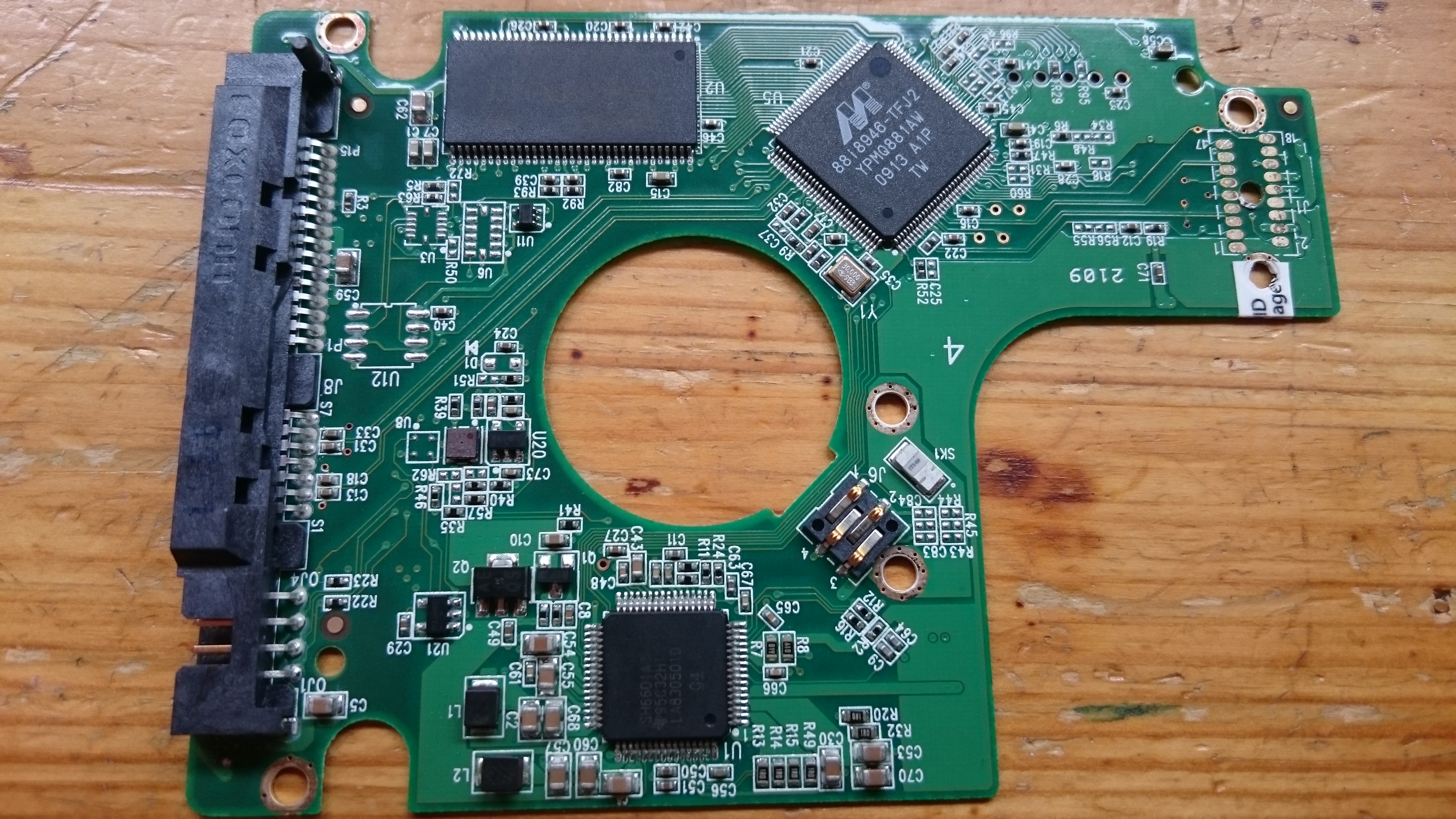

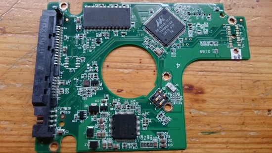

@saltwater, can you show us the component side of the PCB? There should be a group of configuration resistors, one of which determines whether the MCU should boot from an internal or external ROM. You can identify this resistor by comparing the MCUs of PCBs with internal and external ROMs.

fzabkar: Here it is a topic with a very similar problem, you may remember this, that using U12 chip will not works on this PCB:
https://forum.hddguru.com/viewtopic.php?f=1&t=32674&hilit=wd10tmvv
This is a component side of donor PCB:

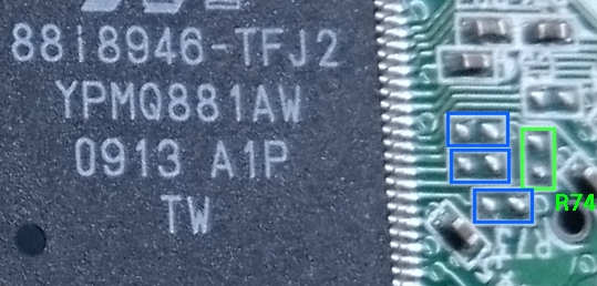

 Post subject: Re: Denali WD3200BEVT-60ZCT0 - internal rom Erased by mistak
PostPosted: March 30th, 2016, 16:23
Posts: 17223
Try connecting a 1K resistor between the pads I have identified as R74. If that doesn't work, then try each of the other three resistors one by one.
