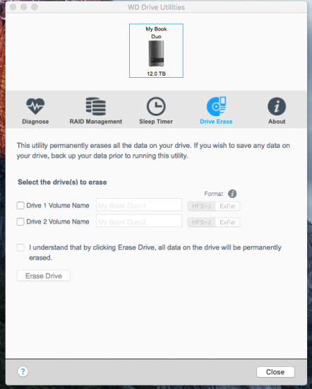

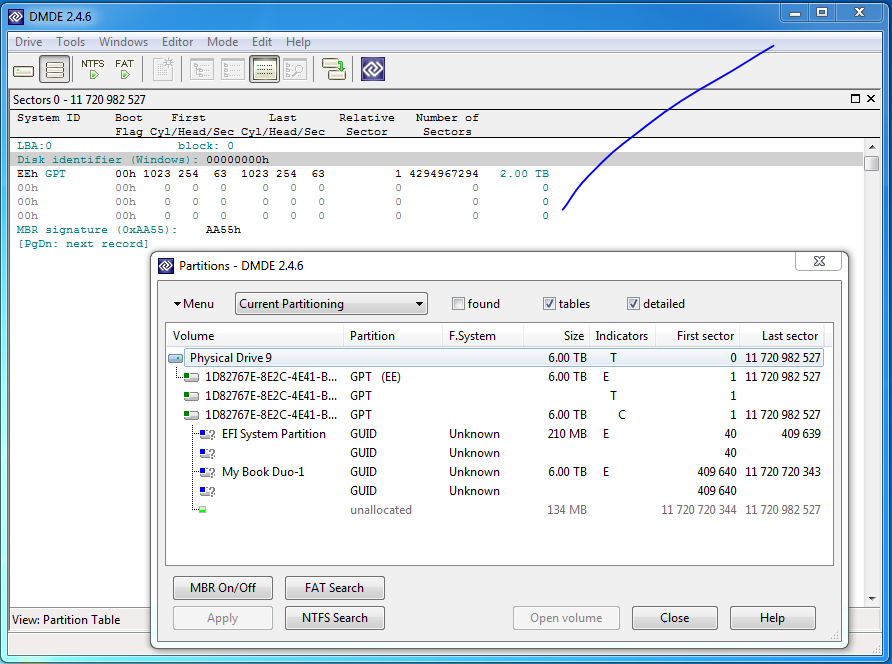

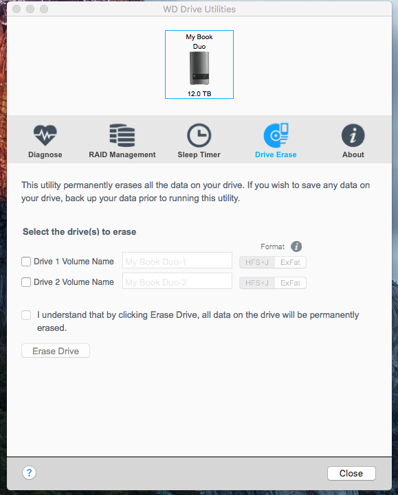

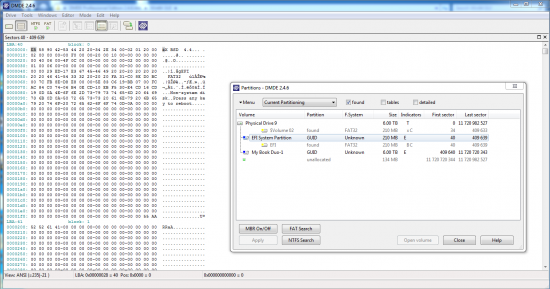

it's ok, here is a screenshot for WD utilities app showing the option that allow you to erase specific drive inside the enclosure and don't worry I have access to both Windows and Mac, and I'm attaching how DMDE see the drive too.

It appears that your WD tool is not the Quick Formatter I was thinking of. In any case your enclosure is presenting a sector size of 512 bytes, and this appears to be the default for this particular product.
DMDE doesn't understand HFS (and neither do I), but it appears to have found all the partitions. I would examine sectors 40 and 409640 (the first sectors of each partition), but the next step would be a learning experience for me.
BTW, I'm assuming that you did not repartition drive #1 or allow TestDisk or any other tool to restore any partitions. That is, I'm assuming that DMDE is showing the original, untouched partition structure.

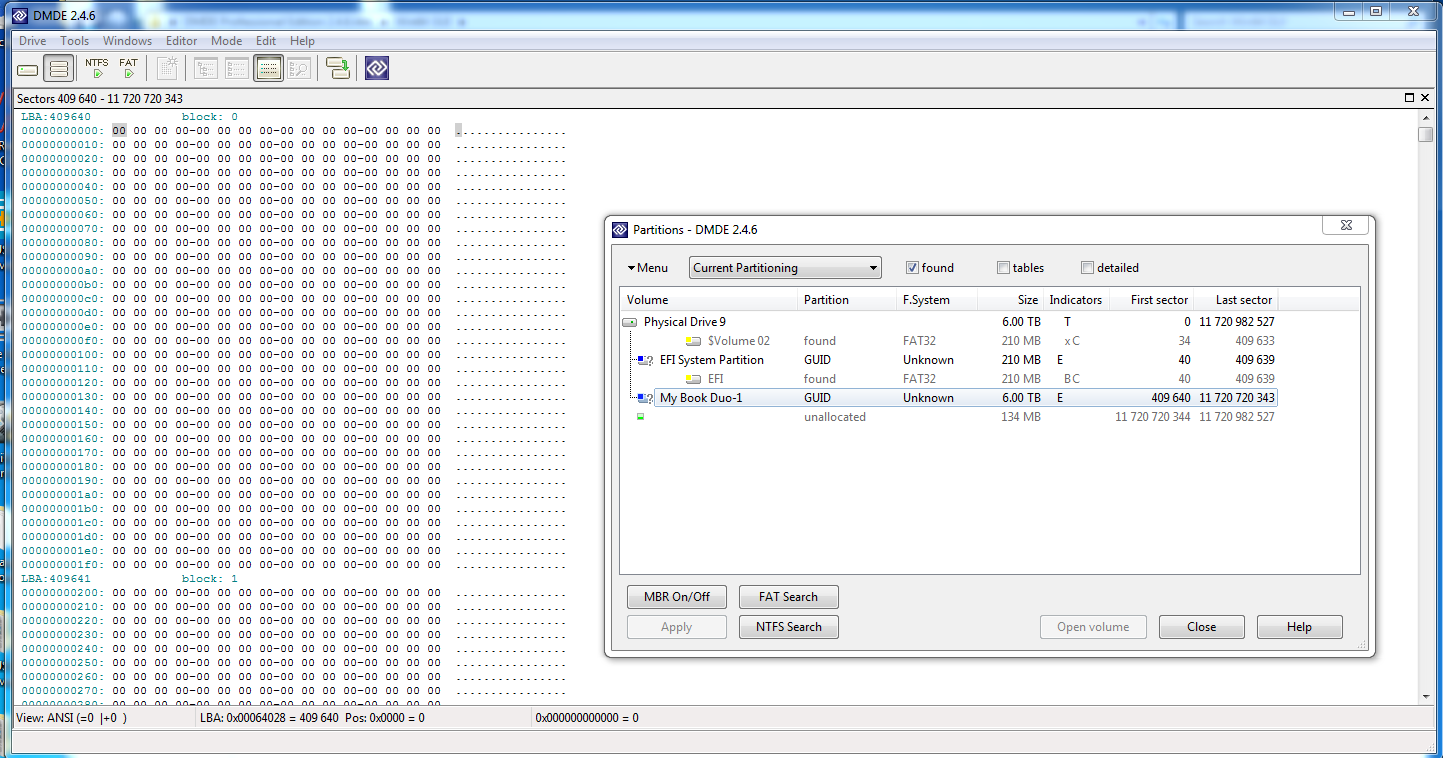

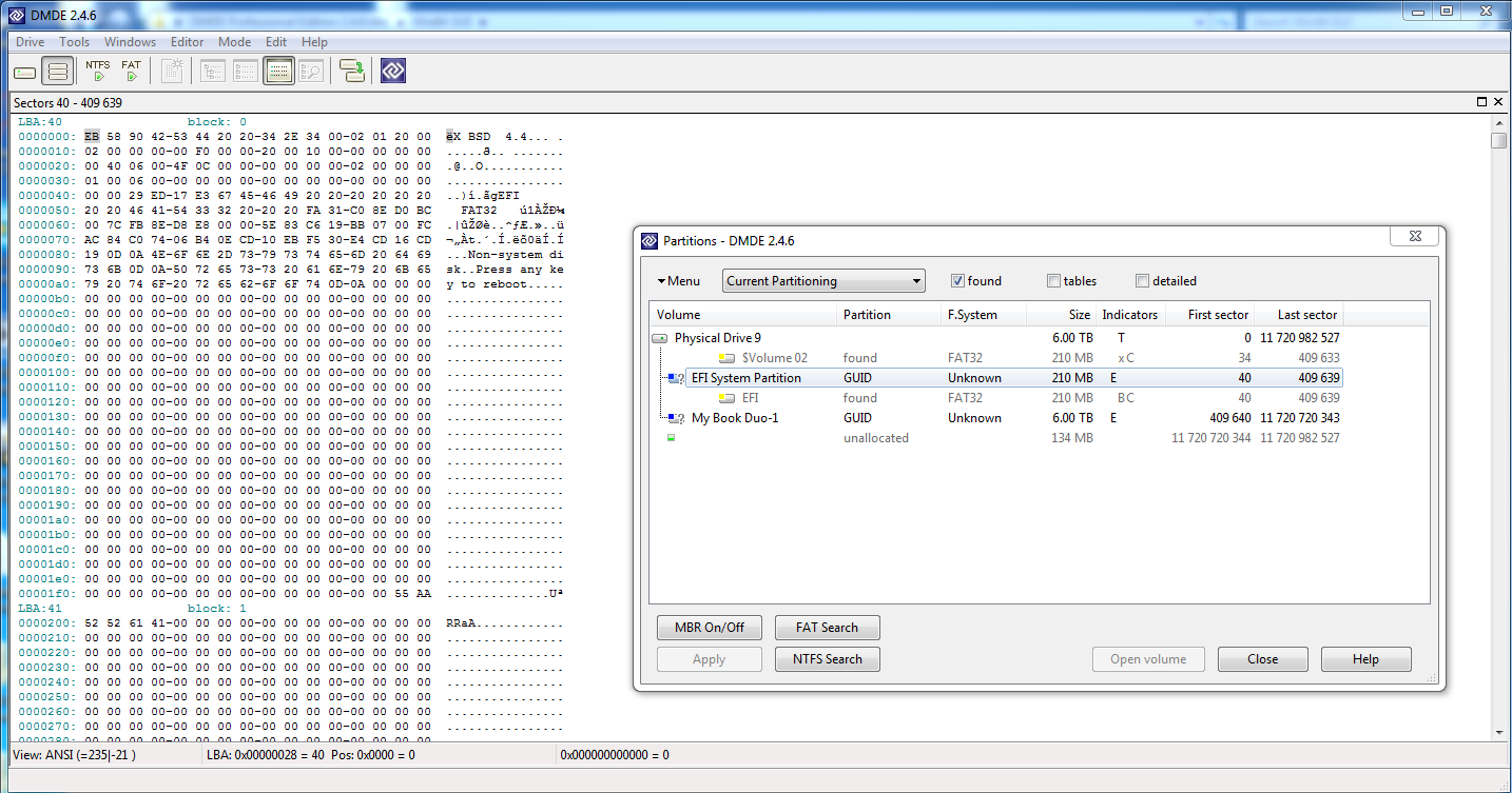

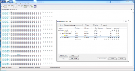

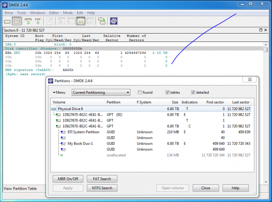

here is attached image for Sectors 40 and 409640

The EFI partition appears to be a FAT32 volume. No surprises there, but I would have expected that DMDE would have identified it as such. :?
The My Book Duo-1 partition has an empty boot sector. I have never examined a HFS+ volume, so I don't know what I should be looking for. However I would have expected that this sector would contain information about the volume. If you scroll down through the user area, do you see any non-zero sectors?

Yes, all the sectors after few lines shows non zero data that are giving the typical appearance of fully functional active drive that hold bunch of data files.

HFS often is blank for the first three sectors, so you'd actually need to look at sector 4 of it. Have you tried just scanning the drive using R-Studio? I don't think the duo drives actually do any encryption themselves, unless the Mac OS was encrypting it.
And you're certain it's not a RAID 0?
