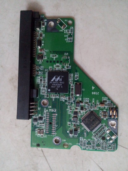

I have a WD1600AAJS-60B4A0 Sata hdd with PCB Burn with no ROM on the board and when I attach the donor PCB....paitient hdd motor spins continuously but not get detected.

what tools you have to work with ?

As we are working on PC-3000

Have you read the PC3000 WD manual?
is it legal pc3k from Acelab ?
there is a way to rebuild ROM on these Marvel drives in pc3k (original).
read your manual.
This is expected as the donor PCB is not compatible "as is".
