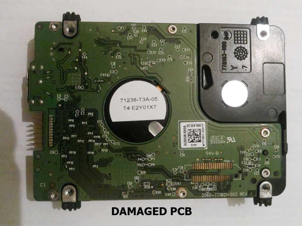

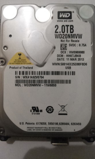

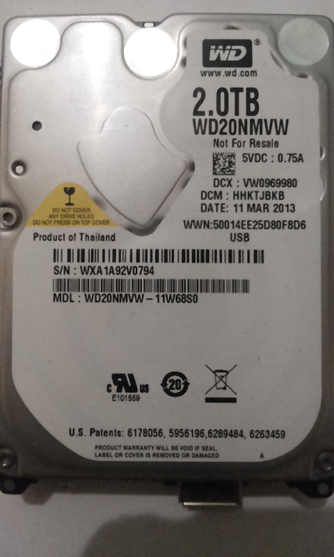

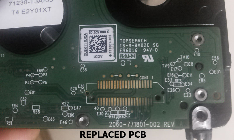

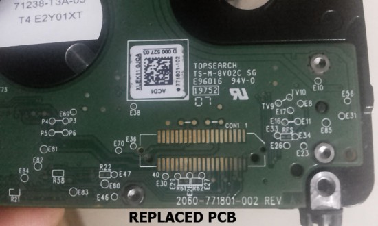

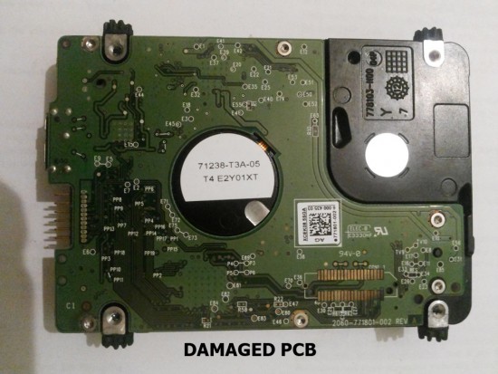

I am a newbie so I will post as much information as possible. I have WD20NMVW-11W68S0 external HDD which got water drops spillage and could not power on anymore (no white led). It used to show on the computer as 2 partitions: the 2TB drive HDD, and the virtual drive which contains the WD Unlocker software.

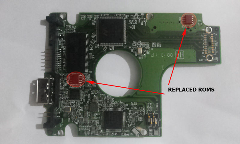

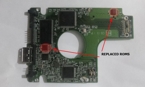

I decided to do a PCB replacement so I ordered for one with the same specs. I did the replacement of the 2 eeproms (see attached photos). The driver can now power correctly. The problem is, the WD unlocker virtual drive is not showing anywhere. The HDD is showing as an unmounted drive (I guess still locked and cannot mount??). Kindly assist on how to repair. Thanks.
Ps. Could anyone conversant with this PCB also highlight the component that could have been damaged by the water drops?
File comment: Original damaged PCB before replacement
File comment: Closeup of replacement PCB after replacement
File comment: Top HDD cover
File comment: Replaced ROMs

you have to disable smartware first which is not possible without usb pcb.
without ?
 Post subject: Re: WD20NMVW-11W68S0 PCB replacement
PostPosted: March 10th, 2016, 13:41
Posts: 849
Location: Pakistan
jermy wrote:
without ?
can you disable smartware on a passport drive with sata pcb ?
Data Recovery Pakistan
PostPosted: March 10th, 2016, 16:01
From the image, it seems clear that he replaced the PCB with another USB one. Both were PCB number 771801.
PostPosted: March 11th, 2016, 4:44
Posts: 849
Location: Pakistan
oh, i over looked it. sorry
