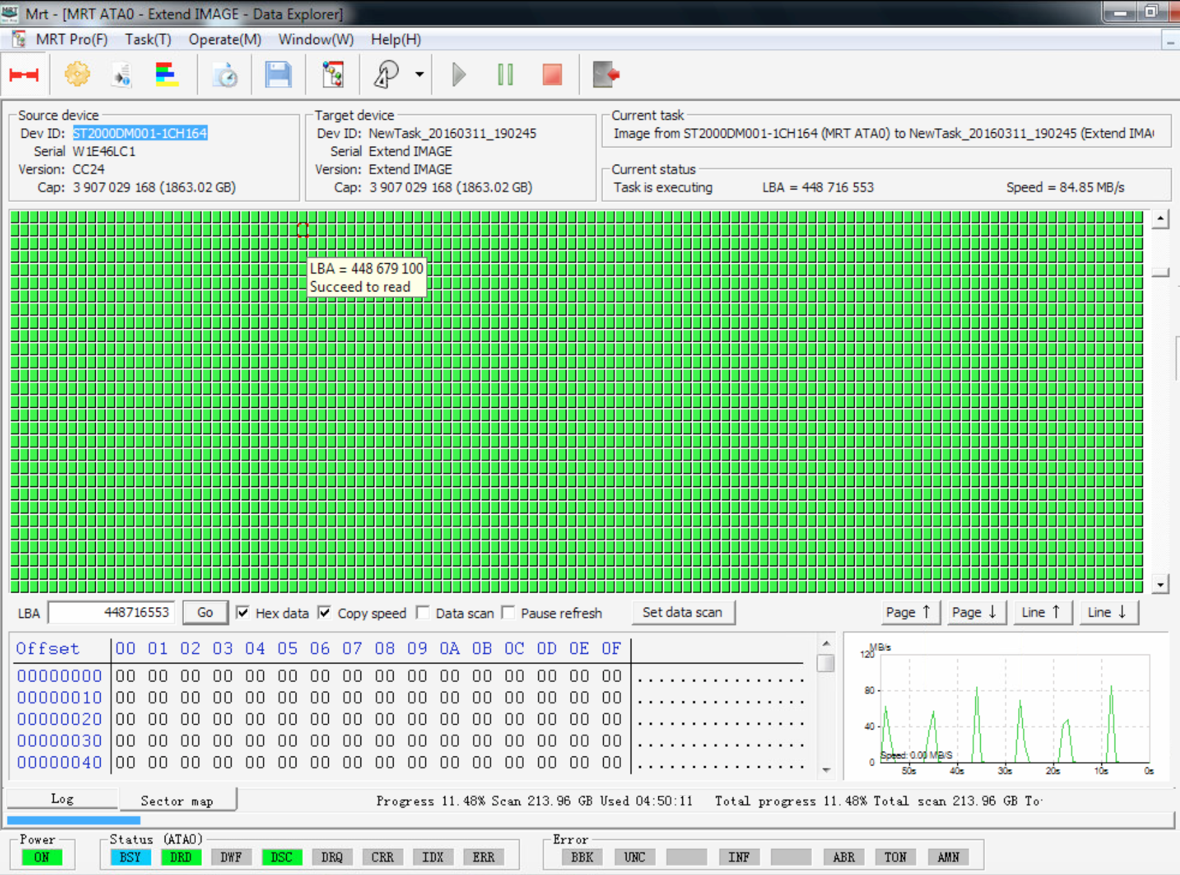

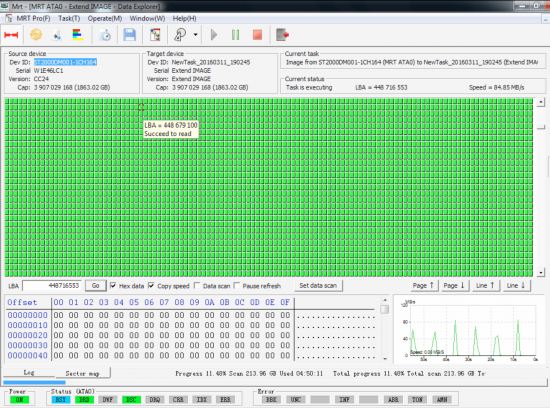

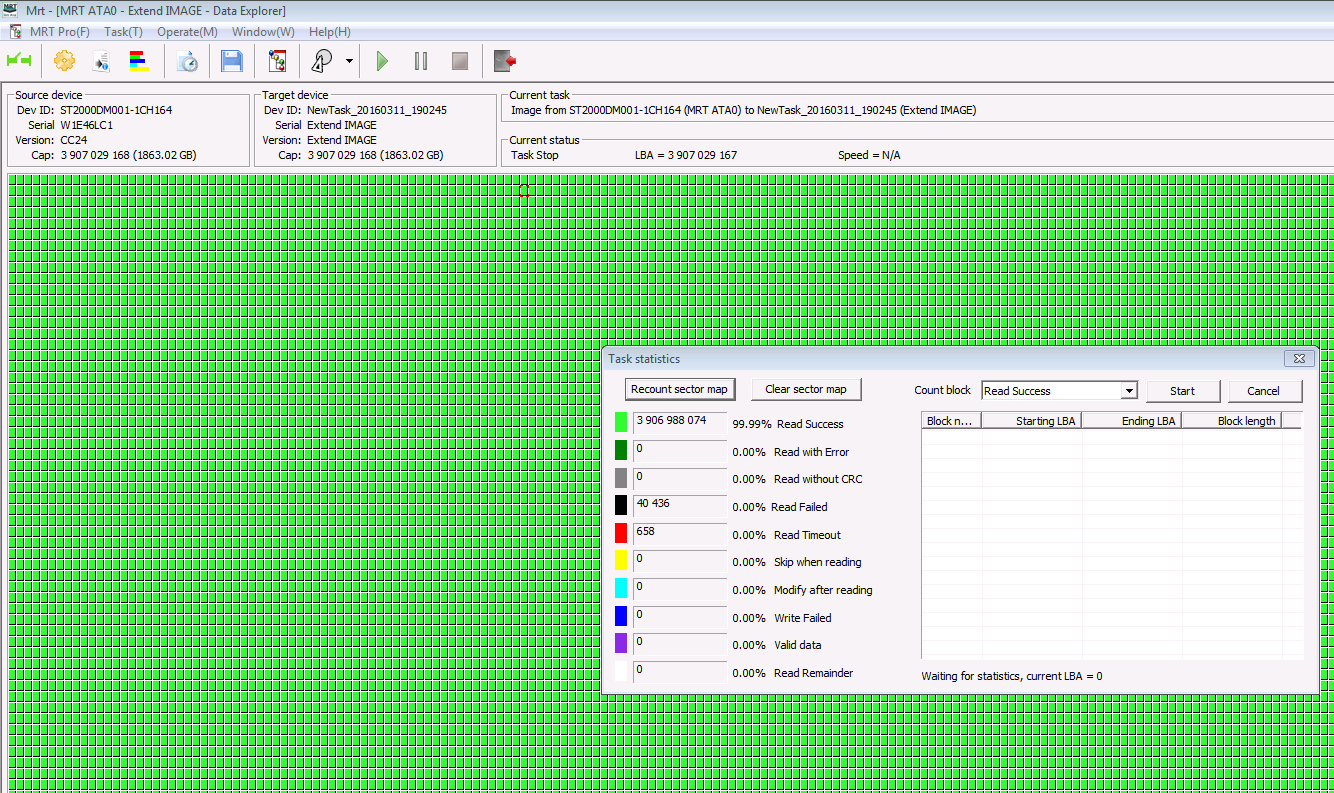

Hey guys,
a Buffalo Linkstation collapsed... inside two mirrored ST2000DM001. both imaging properly with MRT tool... Power Reset then imaging 100 MB (each 10 seconds) > BSY > Power Reset > Loop...
wondering if there is a fix to this BSY issue.. seems to be very common. Strange that the two drives seems to have the same issue.
Greetings
Benjamin

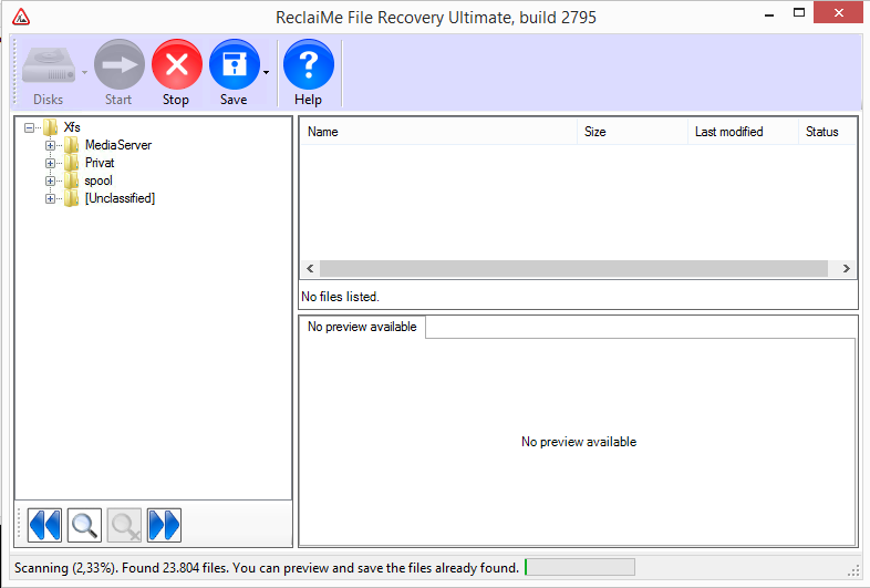

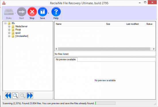

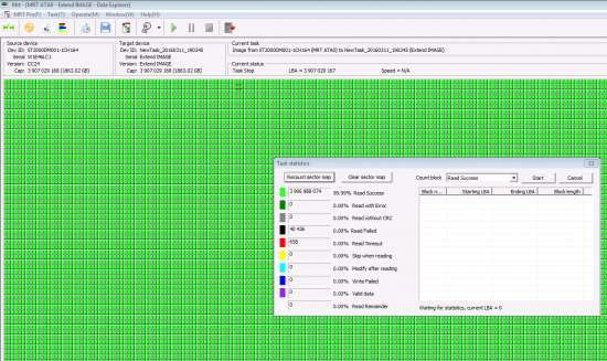

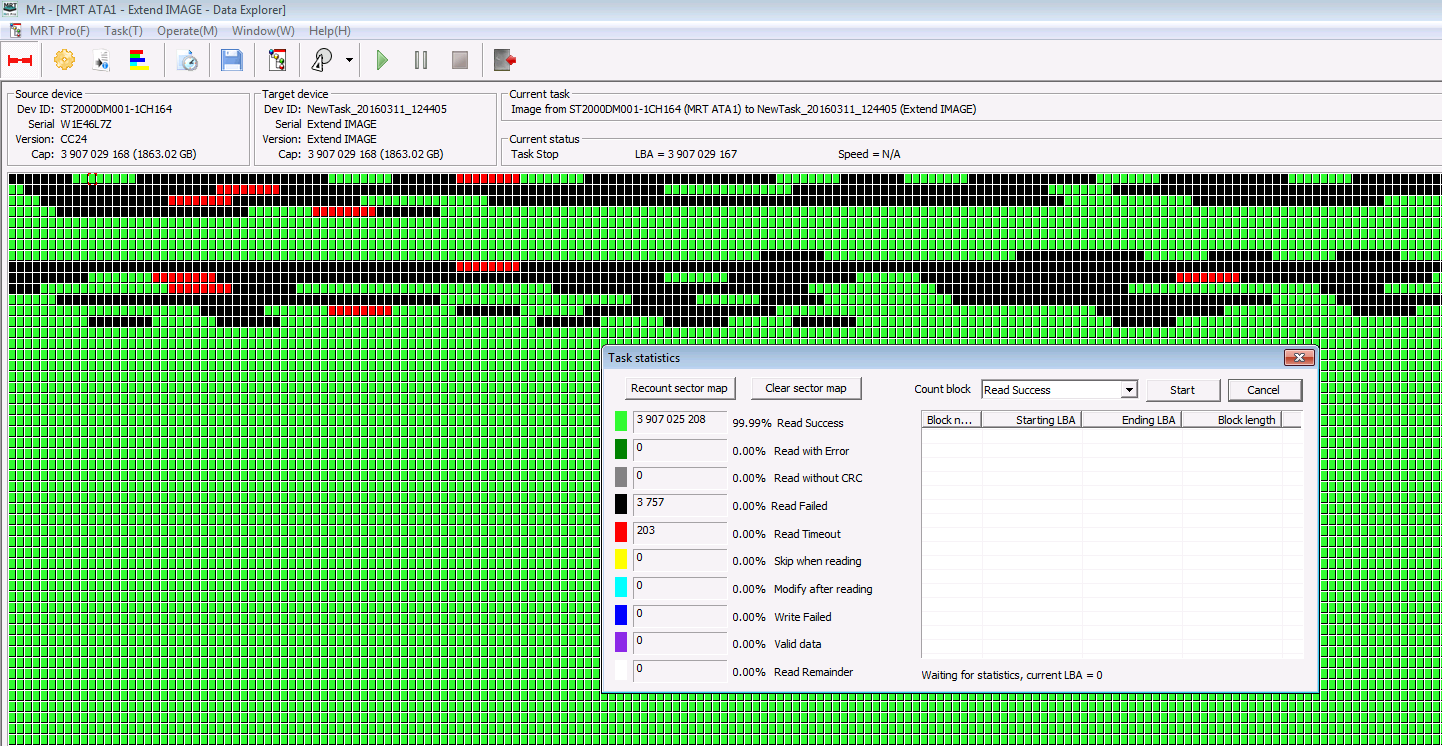

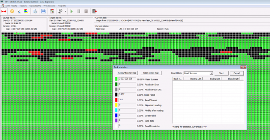

Hey guys,
I optimized the settings so that every 8 seconds 100 MB have been read by MRT-Tool. After Power Reset there was a small time frame where each of the mirrored HDs were accessible.
The second imaging process I used PIO mode that was very stable. at approx. 500 kb/s in that case.
1. HD 40000 errors (see screenshot below) - seems to be the HD "blown" first
2. HD 4000 errors (see screenshot below)
The XFS Filesystem seems to be recognized by Reclaime.
Maybe with the Sysfile 93 it the imaging process would have been more stable and faster?
Thanks for your help. The case ist technical successful. Now it should be economically successful too.. the customer took the hd after diagnosis and said he will double-check it.. a friend of him will try it.
Thank you for your impulses and greetings from Germany,
Benjamin

 Post subject: Re: Two ST2000DM001 BSY after imaging 100 MB
PostPosted: March 17th, 2016, 2:38
Spildit wrote:
Looks more or less good to me ...
Sysfile 93 would be the same as disabling reloaction, media cache, etc with cogen, same as explained here but saved on sys module - http://www.hddoracle.com/viewtopic.php?f=83&t=557
also : - http://www.hddoracle.com/viewtopic.php?f=83&t=557#p7383
Regarding cloning in PIO it does work great on those Seagates, despite the fact that it's ... sloww ....
Spildit ,
I too Think Its a JOB Done Fine .Wish Now He Gets The Money
