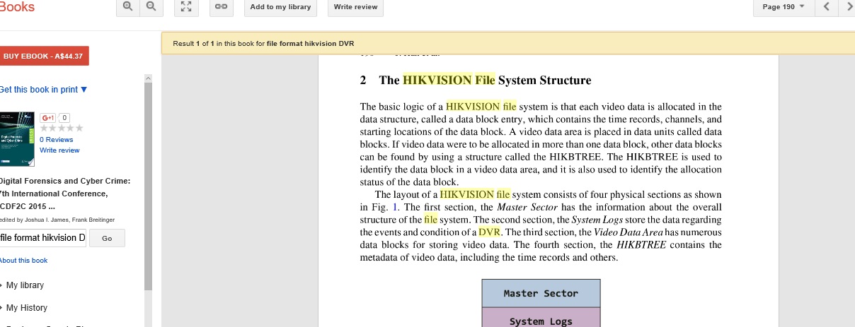

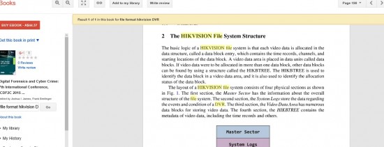

there is a format converter on this page that may lead to some answers:
http://overseas.hikvision.com/en/tools_82.html
possibly look through this software for copyright stuff or nuggets that say what format. looks like at least some of it uses fat32
also checkout:
http://www.cctvforum.com/viewtopic.php?f=1&t=40573
and
https://books.google.com.au/books?id=xp-oCgAAQBAJ&pg=PA188&lpg=PA188&dq=file+format+hikvision+DVR&source=bl&ots=xf5zYm3YBN&sig=7YAkl5FTc7M0rro9vIUF0a1Hbzo&hl=en&sa=X&ved=0ahUKEwid9YyyoNbLAhXCmJQKHcPCBlEQ6AEITzAJ#v=onepage&q=file%20format%20hikvision%20DVR&f=false
