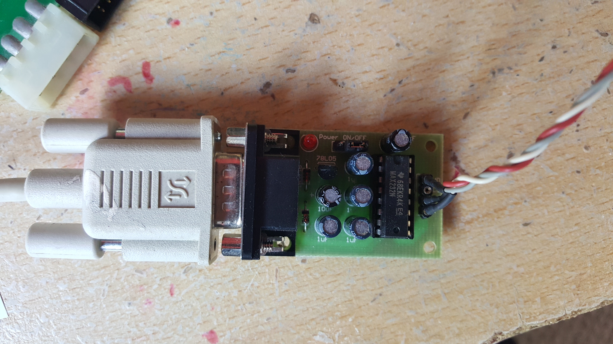

Tried with TTL adaptor ( my old max 232 for serial) - zoc gives the following error:
COMMUNICATION PROBLEM.SCRIPT STOP
Double/Triple checked settings and connections but still no luck.

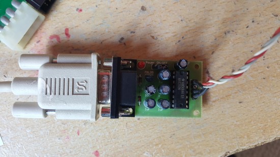

Tried Hyper terminal - no luck
Double checked all the contacts - all sound
Power to HDD -all ok
Swaped PCs - used my old desktop with win98 - no luck
it looks like the TTL is causing this issue - when checking the voltage it gives me 4.2 and 3.1 respectively. Could that be a case?
If yes, then I need to get another TTL...

Test the adapter by looping the Tx and Rx outputs. Every key should then be echoed in HyperTerminal.

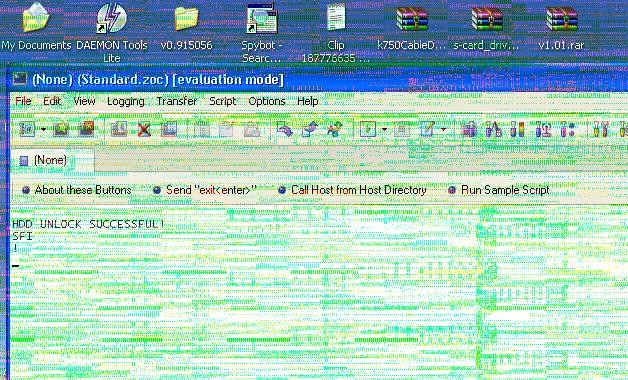

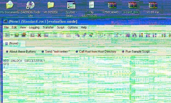

Thank you for your help - especially Spildit. It is unlocked. This hdd was a bit unusual -It was the matter of sequence and timing when connecting etc.. and few tries. TTL adaptor was ok (although it is old) - checked on other seagate hdds.
Kind Regards
Lyncex
