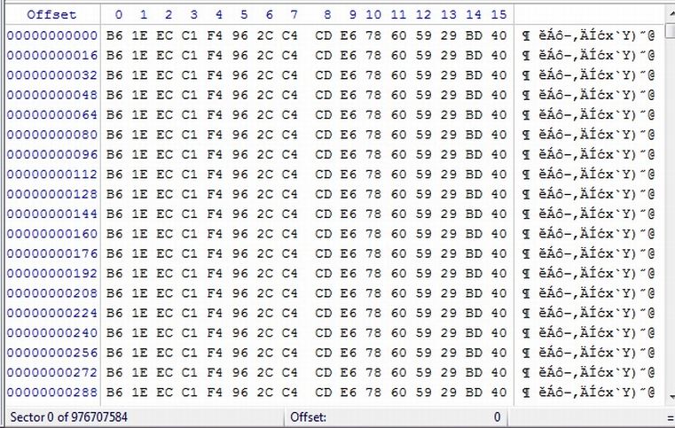

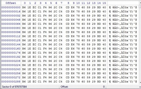

can someone identify what is this

Encryption...

is possible to identify type of encryption
 Post subject: Re: my passport essential
PostPosted: April 29th, 2016, 4:23
Posts: 17316
It's hard to find any WD docs that explicitly state the encryption algorithm, but I believe it is 256-bit AES.

Doesn't encryption usually have very high entropy? Are you saying this dump is part of the key, salt or some other part of the encryption itself? I don't see how this can be encrypted data.
PostPosted: April 29th, 2016, 20:18
Posts: 17316
The dump is sector 0. The repeating pattern of 16 bytes (= 128 bits) is consistent with encrypted zeros.
Thanks Franc, as you can see I know nothing about encrypted conventional drives :)
