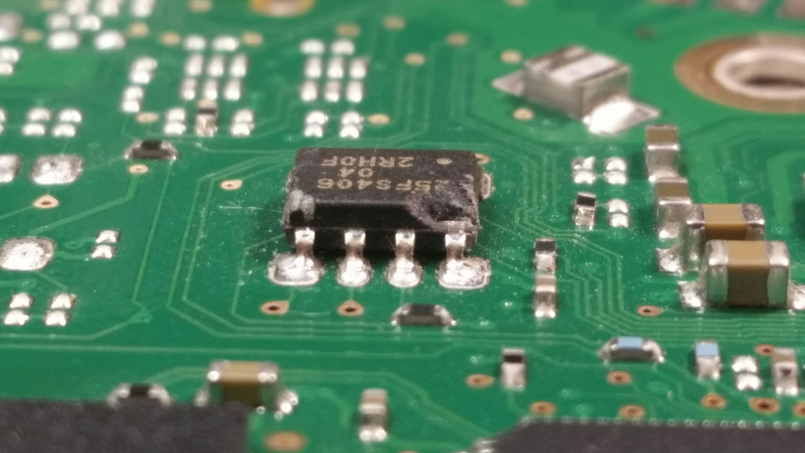

I have a ST1500DM003 where the client tried to remove the ROM with pliers. The ROM is physically damaged. I have an exact matching board (model/part/fw) but the drive gives servo errors. Is there anyone out there who can rebuild a ROM on an F3. If so please PM me.

 Post subject: Re: Seagate F3 ROM Rebuild
PostPosted: May 13th, 2016, 5:13
Posts: 186
Location: Germany
Too many unique adaptives in the ROM to recreate it.
Your better to try an repair the damaged ROM and read the contents in a ROM reader.
Post a pic of the damaged ROM.

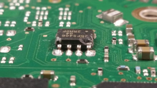

Here is a picture of the ROM. Just had confirmation from the client that he wants to pursue this so I will see if we can read it today. Its a little more than just a leg that's been damaged. But you never know.
PostPosted: May 13th, 2016, 12:34
To me, it just looks like the outer shell is damaged and it likely okay.
PostPosted: May 13th, 2016, 13:18
Posts: 1777
Location: Phoenix, AZ USA
You were quite right Luke. The ROM did read so the board was also dead. Not sure what the client did but looks like he shorted the board at the same time. Now getting preamp failure message.

The logical approach would be to determine what is wrong with the original PCB. The failure mode may then shine a light on the current problem.
PostPosted: May 13th, 2016, 15:11
Posts: 1777
The board has multiple issues such as a removed TVS and smooth chip failure.
PostPosted: May 13th, 2016, 15:20
Posts: 17333
If the 5V TVS diode has been removed, then most probably there was an overvoltage on this supply. The user then most likely powered the drive without protection, resulting in failure of the preamp and damage to the 5V side of the SMOOTH chip.
If you read the ROM to file, take a look and see if the serial number matches up with the drive.
PostPosted: May 13th, 2016, 16:03
Posts: 1777
lcoughey wrote:
Yes it did match, did some checking at several points of the ROM and it doesn't seem like its corrupt or a ROM from another drive.
PostPosted: May 13th, 2016, 16:11
Posts: 17333
If the ROM were corrupt, ie bad checksum, then the drive wouldn't start.
PostPosted: May 13th, 2016, 17:12
That's correct. Looks like toasted preamp.
