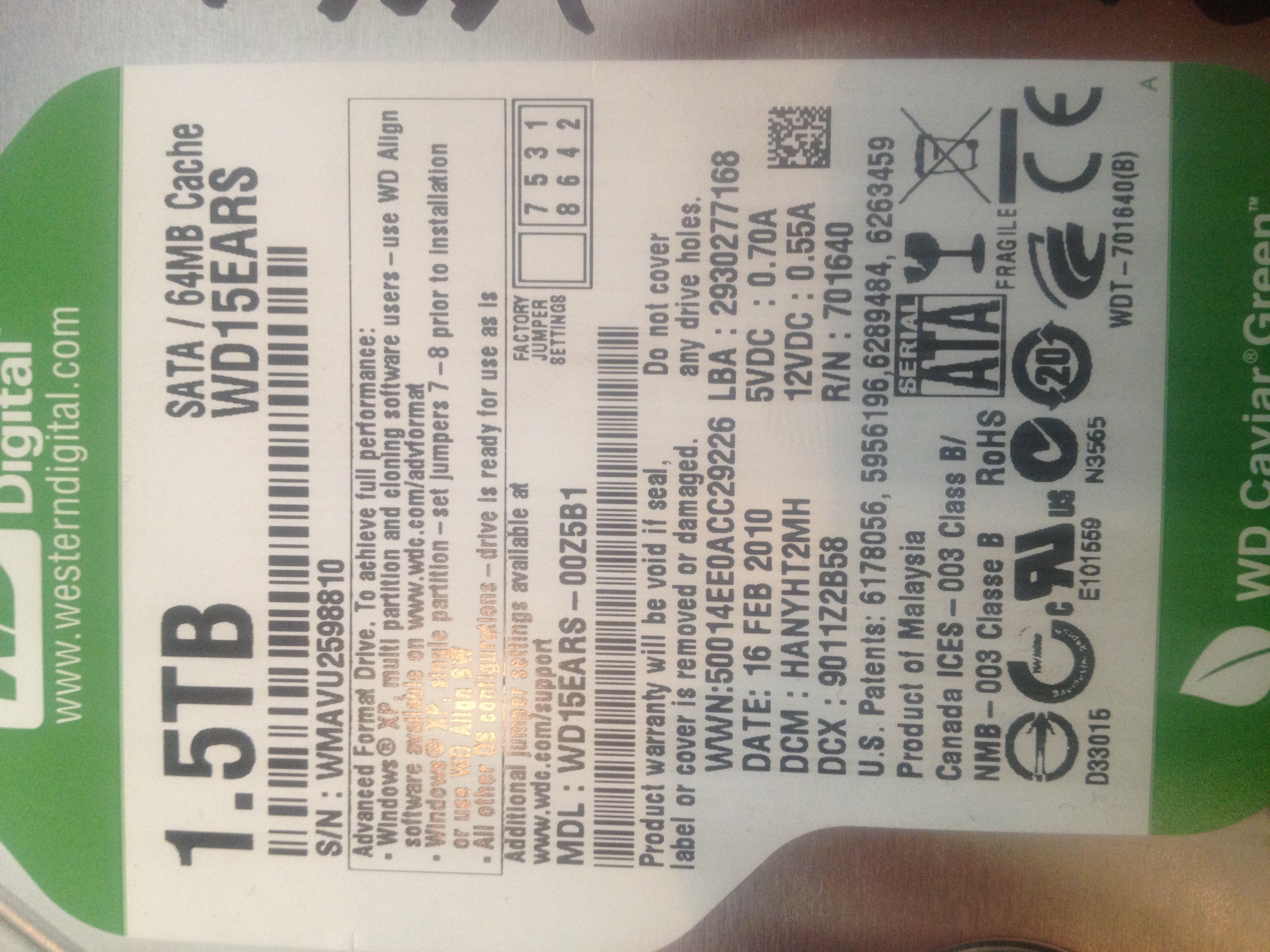

hi!
I have WD Caviar Green and i want to clear SMART in it. I have USB TxRx terminal which i used on Seagate. Is there any chance i can use it to clear smart on WD with this?
Thanks in advance!

I would say it's not possible for you even it's only some not serious SMART problems. Drive use special protocol for terminal mode that not the same like Seagate. I doubt you can solve it without special tools/utilities. And better to work via SATA interface, some utilities like WDR could help you. Or ask some profi guys in Poland (they there are) to help you, it is not expensive or even can be done for free. Good luck.

NO NEED To Terminal HERE
if you have good knowledge to work with HDD
you can work with Free WDR 5.3
if you didn't have it , i have good modified version
you can use it
1- Back UP HDD Firmware
2- try to hit Clear smart Button ( check smart after that , if not cleared go to next step )
3- Merge G To P
4- Clear and Regen translator
and your Problem will be fix 100 % after this step
if you can't do that , i can remotely help you
and don't play with HDD before you backup firmware
