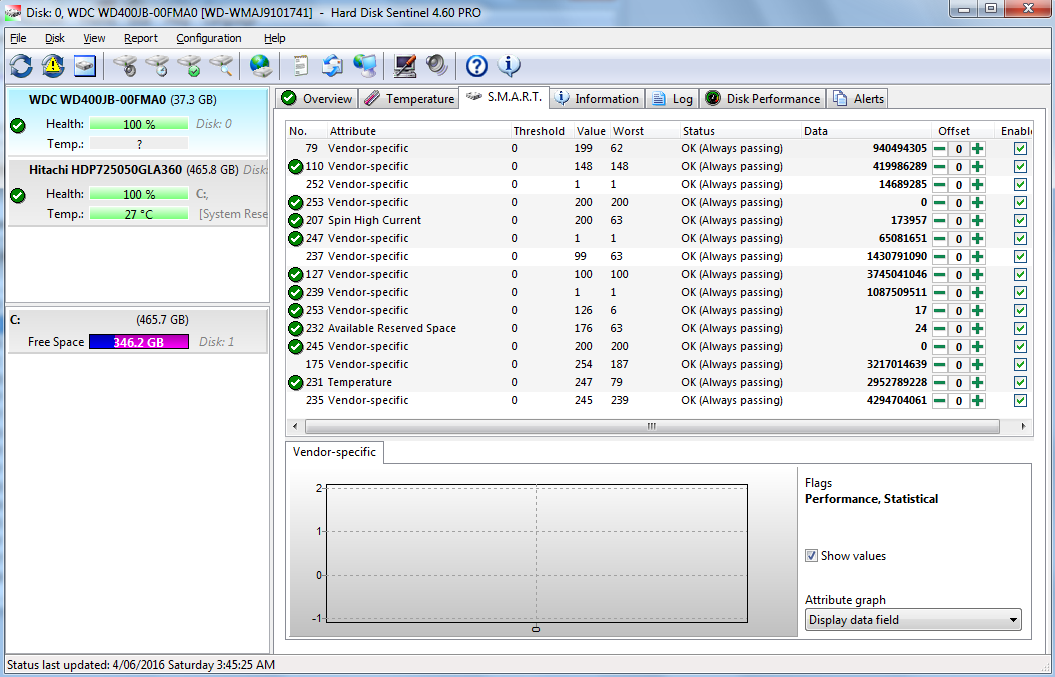

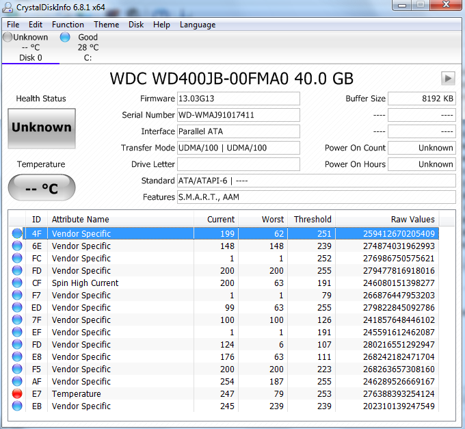

I've attached photos of the SMART output from HD Sentinel and Crystal disk. Definitely doesn't look like its reading it correctly.

Try to dump the drive's ROM and firmware modules using NazYura's tools.
http://www.hddoracle.com/viewtopic.php?f=22&t=28&p=826
