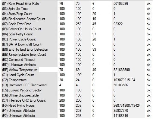

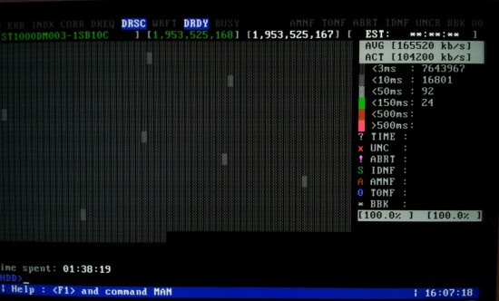

Heres SMART and MHDD

What do the SMART data look like now, after the 1TB surface scan?
The Raw Read Error Rate and Hardware ECC Recovered attributes look bad. The ideal normalised value for the RRER should be 120. The Seek Error Rate data are not yet statistically significant (the drive hasn't yet executed 1 million seeks).

No, that is normal for seagate hard drives. SMART not showing this properly. (u can check other seagate smart on google images)
After surface scan still looks same

A value of 75 for the RRER is not normal for your drive, unless Seagate has changed something.
Seagate's Seek Error Rate, Raw Read Error Rate, and Hardware ECC Recovered SMART attributes:
http://www.users.on.net/~fzabkar/HDD/Se ... R_HEC.html

Show us the SMART data now. Your surface scan was very good, so maybe the numbers will be much better after the scan.
