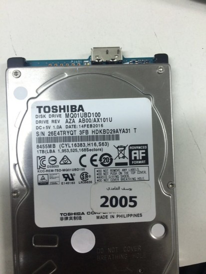

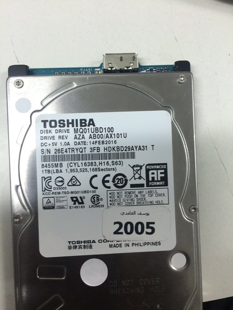

 Post subject: Is this a good donor for Head replacement ?
PostPosted: June 18th, 2016, 2:03
Joined: December 23rd, 2013, 9:56
Posts: 202
Location: Saudi Arabia

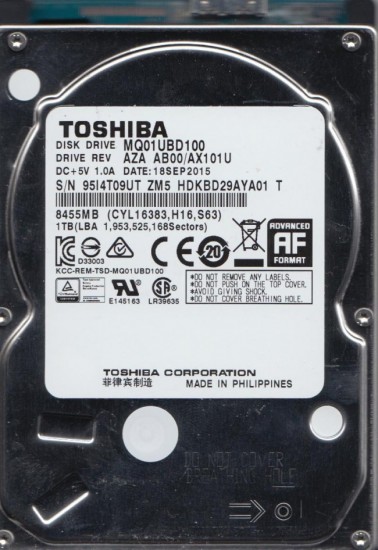

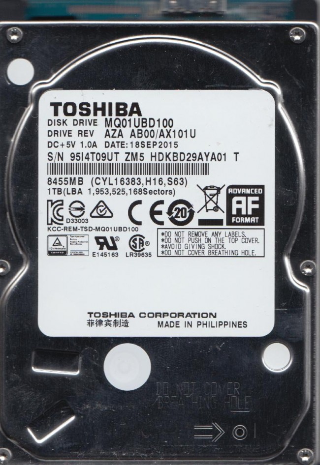

Is this a good donor for head replacement
File comment: Customer Drive
File comment: Donor

It should be....

For me ... YES

what about the date ?!
there is chance it not matching ..
better to be same year
goodluck

Should be suitable, Toshiba aren't too fussy :-)
 Post subject: Re: Is this a good donor for Head replacement ?
PostPosted: June 19th, 2016, 7:22
Close enough. Would definitely go for it.

yes very close

Drives look compatible. But i would have chosen the Sata variant MQ01ABD100 which is also compatible and will give you a Sata PCB to convert to.
Unless you have USB imaging tools like DDI USB add-on etc.
