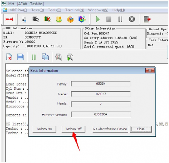

I have a drive in for recovery. I have successfully imaged around half of the drive using MRT with DE and reading the drive through the utility program (not directly through DE). Now the drive is giving all black blocks, even though I am using all of the same params as before. Here is what I have done so far:
1. Tried clearing G-list (has 4 entries) but they are still showing up
2. Cleared SMART
I initially used the tutorial on the MRT website for imaging with corrupt G-list and that was how I successfully got have of the drive imaged, but now I am stuck.
Any thoughts (besides getting a better tool....I have heard that one before)?

As a follow up...I CAN get single sector access using the utility alone, my problem is when I switch to DE to do the imaging.
You need to clear the G-list and Techno off as shown below

I have tried clearing G-List (although nothing changes - values stay) and turned Techno off and built a head map but nothing has worked.
Is there a way to image from a particular spot in DE or do a reverse copy? It seems like I should be able to, but I can't change any of the values for a start sector/reverse image.
