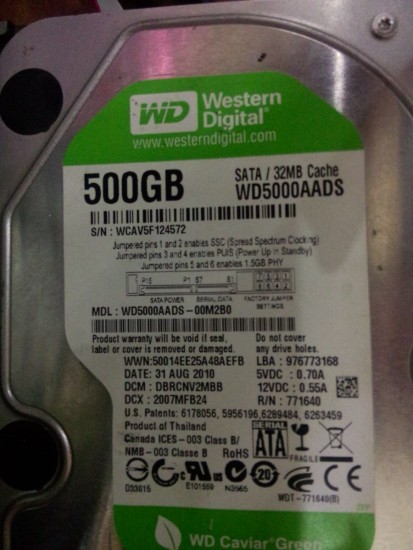

Hello friends i need firmware help me
Model : WD5000AADS-00M2B0
Firmware : 007700BJ
Serial : WCAV5F124572
Date : 2010-08-31

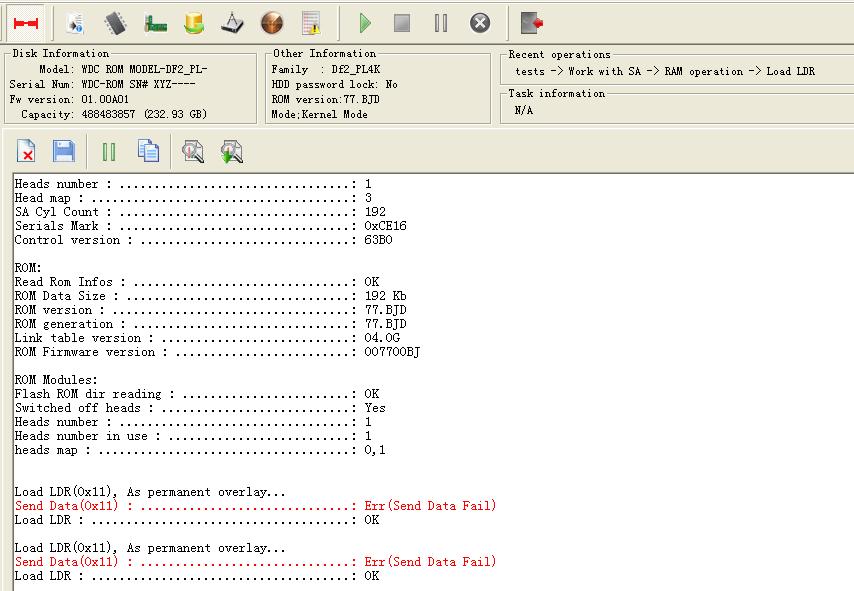

 Post subject: Re: Fix firmware hard drive WD500Gb
PostPosted: August 8th, 2016, 18:15
Banned User
Joined: May 28th, 2016, 1:40
Posts: 48
Location: Viet Nam
pclab wrote:
wow not work because other serial
Help me
Are you for real???
The same serial number, you already have :mrgreen: :mrgreen:
wow no
I no have need your help

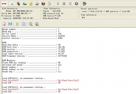

1. You have access to SA ?
If so
2. Everything is OK there ?
If not
3. Have you tried a LDR ?
Edit: just noticed the pic. You have uploaded, what's going on with the settings of heads ? (4 heads in RAM, 1in ROM and HM 0,1)

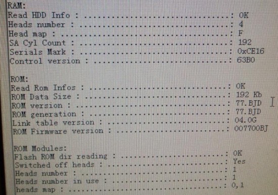

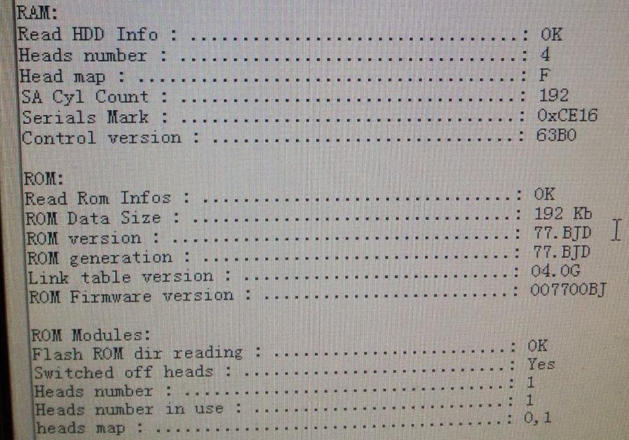

PostPosted: August 8th, 2016, 19:08
Banned User
Posts: 48
Location: Viet Nam
If so
If not
Help me
I am from cuudulieuocung.org and I am currently banned from this forum for creating multiple accounts to promote my crappy website.
PostPosted: August 8th, 2016, 19:34
Posts: 1388
Location: isreal
I think the HM supposed to be 2,3
PostPosted: August 9th, 2016, 2:54
Posts: 3549
500GB Dragfly2 can have 2 3 or 4 heads in any combination of 0,1,2,3.
PostPosted: August 9th, 2016, 3:49
Joined: July 12th, 2010, 4:38
Posts: 1454
You have depoped heads.
It was you that depoped them? Or someone did it before?
ACELab partner
