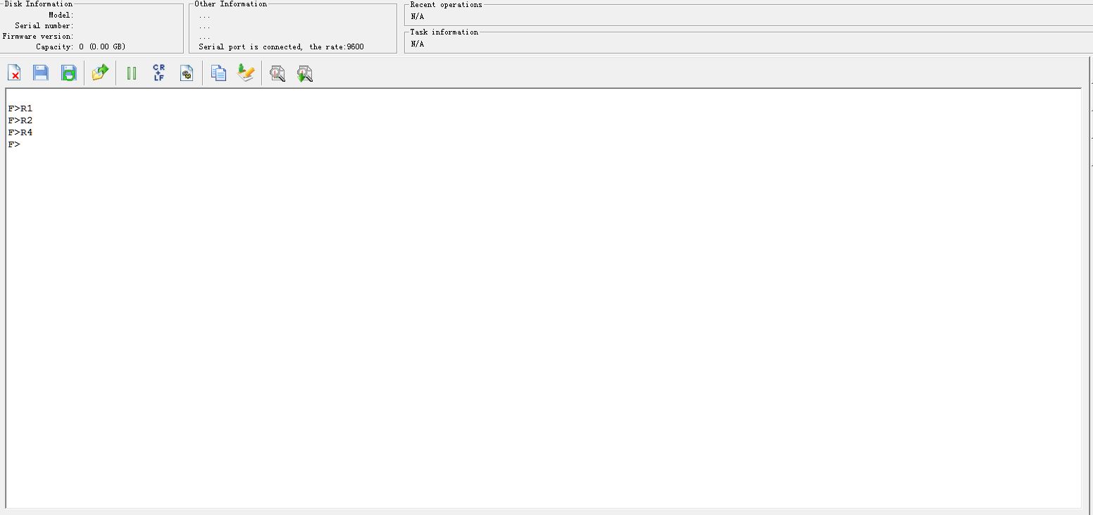

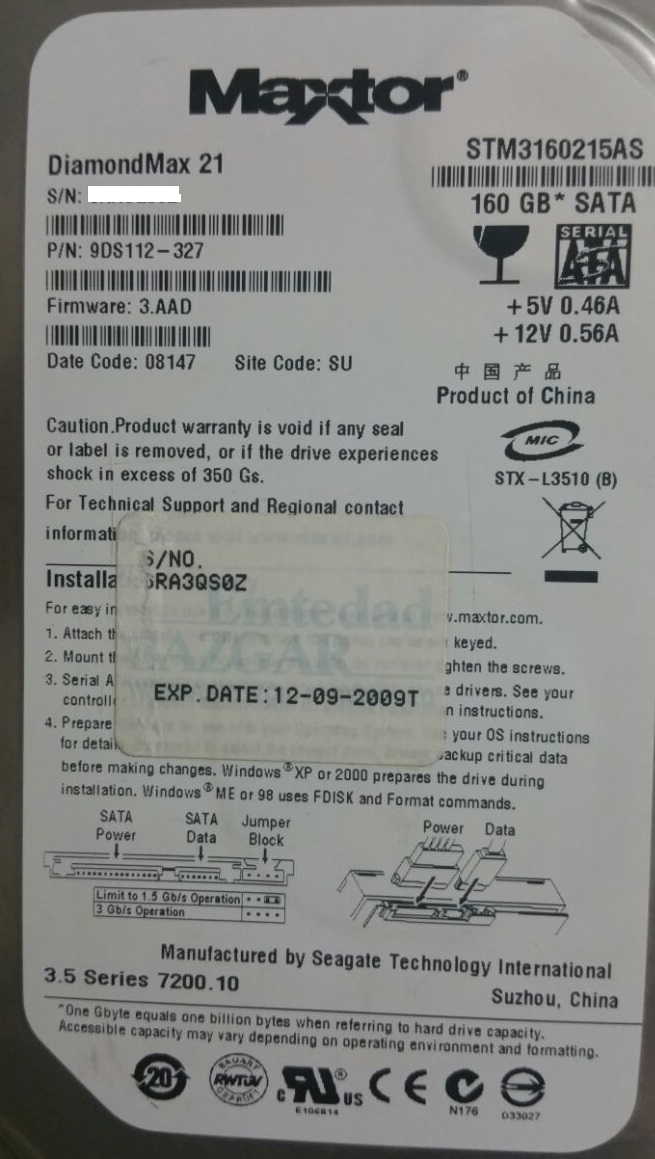

Hello all
This HDD get busy and no more clicking and any other head noise.
How can I access to resource?
Any jumper should set?

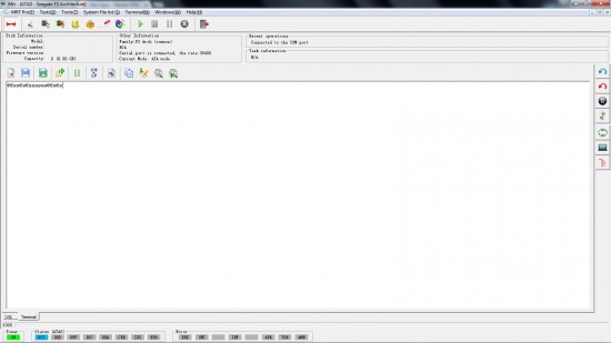

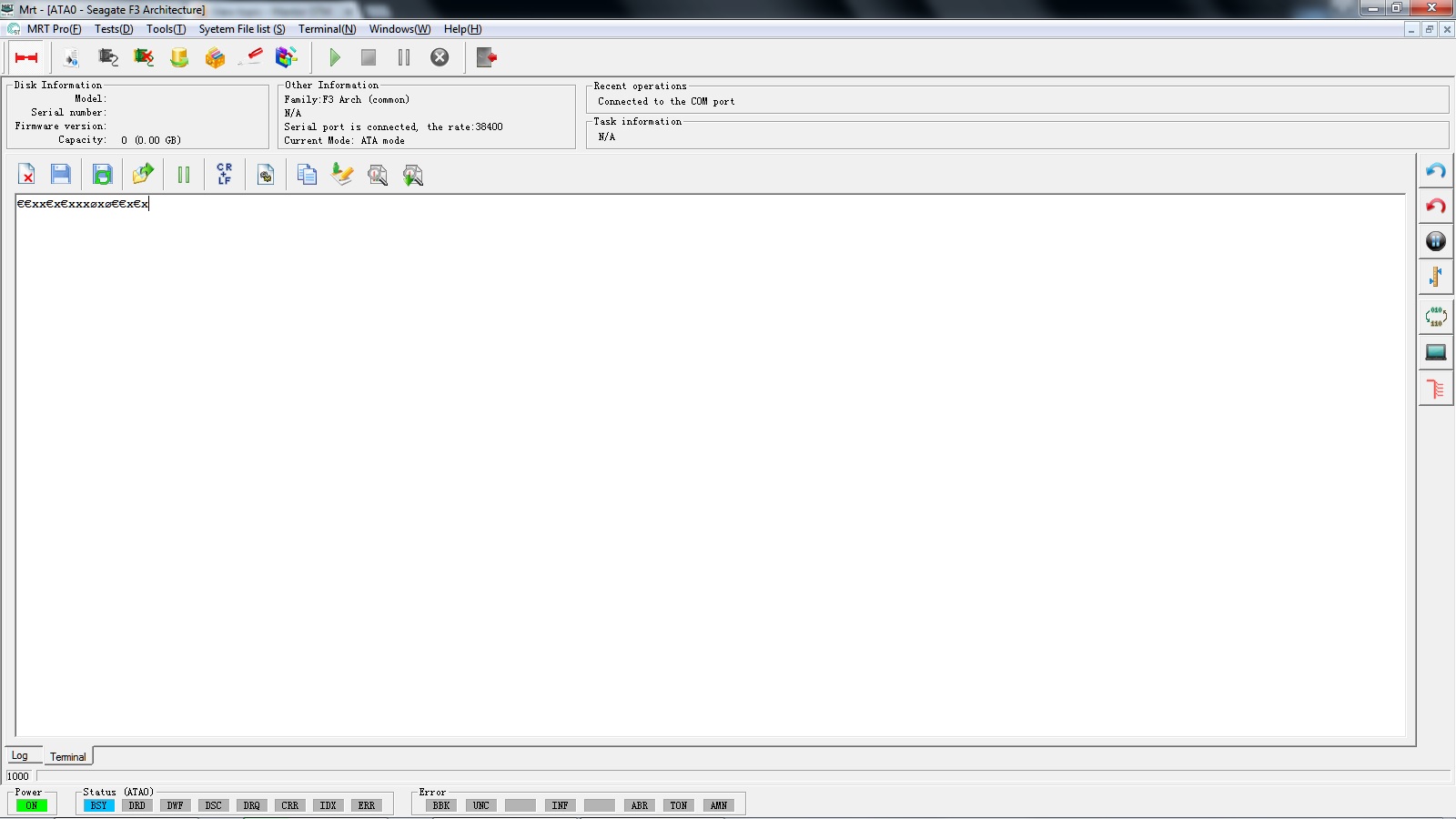

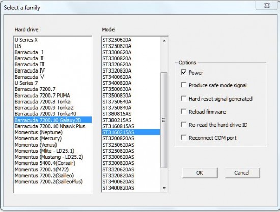

Show terminal
 Post subject: Re: Maxtor STM
PostPosted: September 5th, 2016, 2:59
Joined: February 13th, 2014, 12:13
Posts: 166
Location: Isfahan
MRT terminal
Phoenix Computer Forensic Laboratory
http://www.databack.ir
PostPosted: September 5th, 2016, 3:43
It's not an F3 drive.
PostPosted: September 5th, 2016, 3:46
Posts: 166
Location: Isfahan
Yes I know, but I can not find other way to access terminal with MRT!!!
What you suggest?

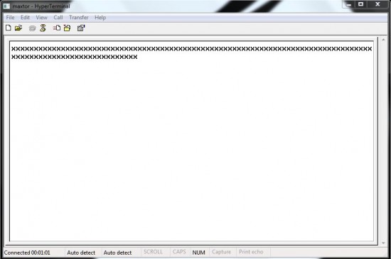

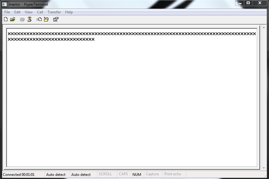

This is log with hyperterminal
PostPosted: September 5th, 2016, 4:36
Posts: 186
Location: Germany

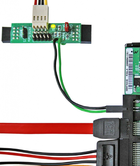

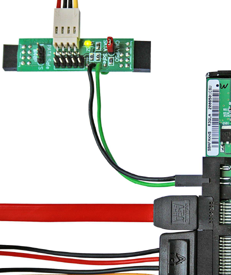

Most likely its from the Maxtor Shasta family.
You need to put the drive into safe mode.
PC3K uses a special adapter for this (see picture).
So I'm not sure how you can do it in MRT

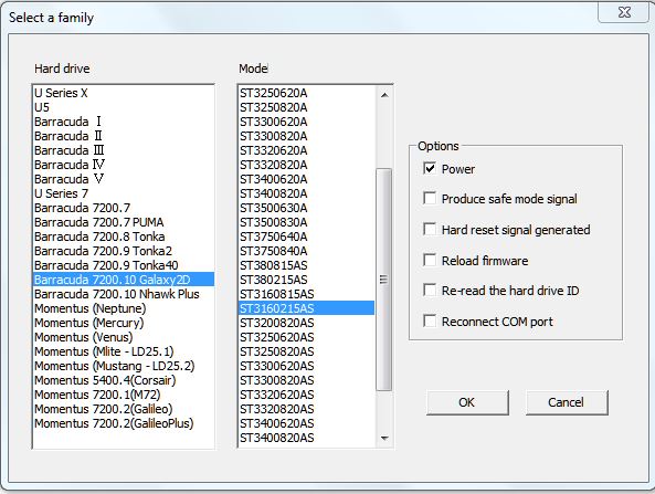

PostPosted: September 5th, 2016, 9:37
Posts: 242
YOU CONNECT WITH BAUDRATE 9600 AND GET TERMINAL
PostPosted: September 5th, 2016, 11:46
Posts: 242
databack, set baudrate 9600 and you got T/ not f3T
PostPosted: September 5th, 2016, 11:52
Posts: 166
Location: Isfahan
Can not load T level or else, only F level

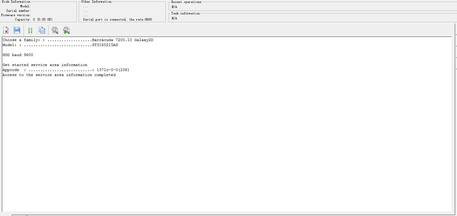

PostPosted: September 6th, 2016, 1:16
Posts: 166

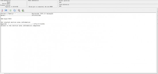

Location: Isfahan
Thanks Spildit
output log:
PostPosted: September 6th, 2016, 10:44
Posts: 166
Location: Isfahan
Solved!
This is a head problem and change it!
