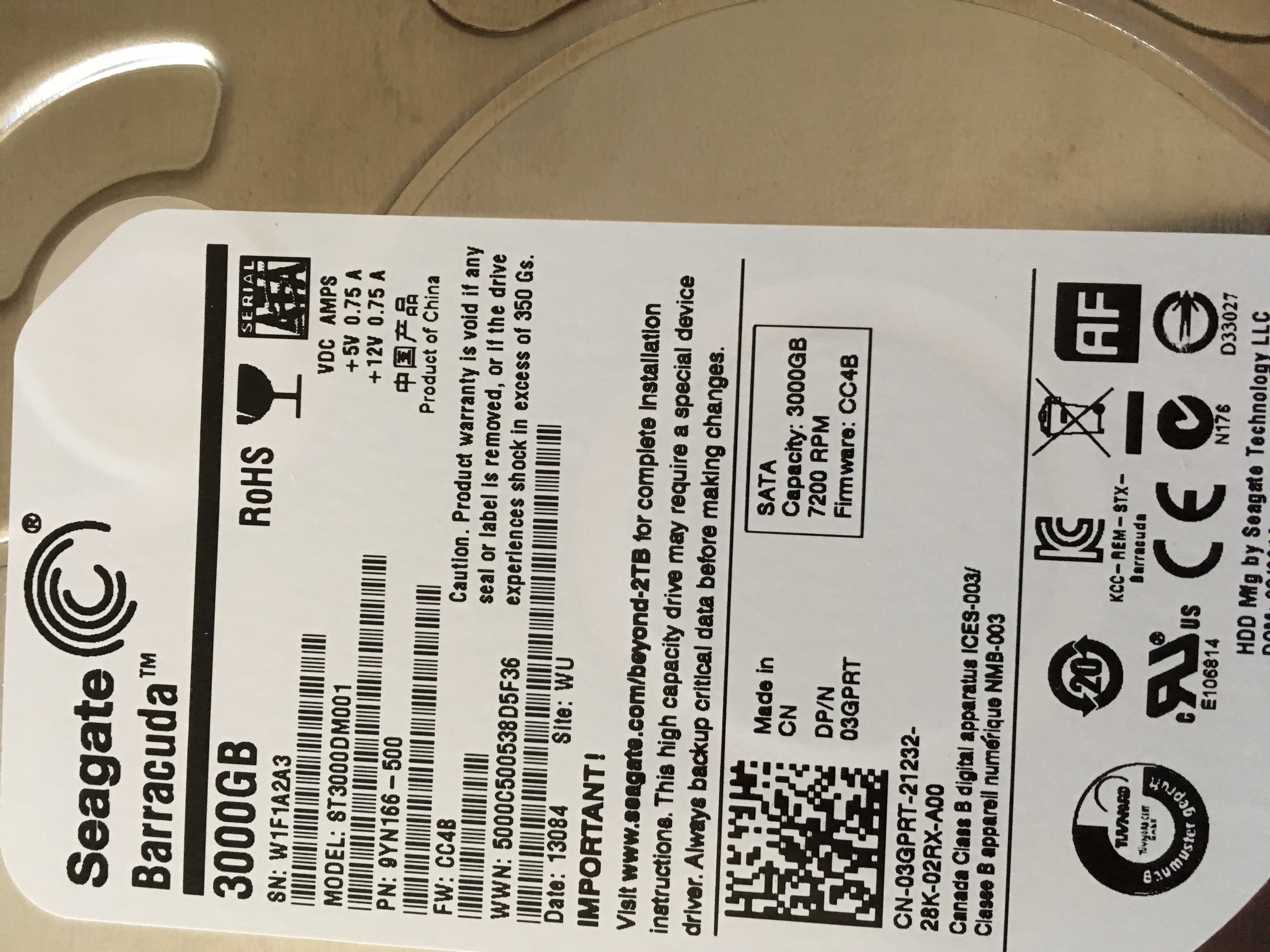

hi, im' trying to recover data from hd of 3tb, split in two partition (the smallest for backup the system and one for the data). windows seven is on a ssd. i use it to dw from emule so the pc run day and night. one day i wake up and the pc recognise only the partition with the backup.
chkdsk /f don't fix and returm me corrupt master file table
I have tried with various partition/data recovery softwares but only diskdigger show me files.
the real problems comes when diskdigger during saving some file crash, now the pc don't see anything.
what can i do now?????

here's the label. i try to start pc with the hd pluged in but it won't start

If data is important you should go to pro immediately. Common problem for this model is head crash and very often even pro can't recover data in this case.

it'spossible to change some machanical parts?

Hi! Yes it is, but should be done by a data recovery proffesional with skills and experience, in a clean room, and with special equipment. After a mechanical part change, hdd should be treated with special care to extract the information on it.
