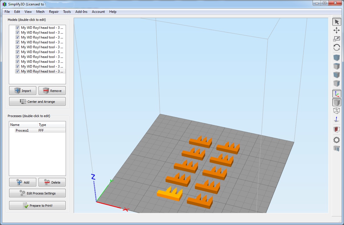

any one try head swap for 2.5 3tb PEBBLEB family can help me out WD30NMVW, there is no tools from hddsurgery yet and it's too narrow here inside between heads ans heads connector if you open it before . so any clues ,,, it's 10 heads

Nothing CAD software and a 3D printer can't solve. :wink:

pcimage wrote:
I can do these in 10 minutes, with "home-made tools" :-)
+1, easy bake oven!
Tawfeek ,
Take a Good Quality 90 Degree Bent Tweezer And Use Precision Nose Plier To Bent The Front Holding Arm Of This Back To 90 Degree ,This will give you a Custom Tweezer That Can Go To Any Depth In Any Drive .Then Use Wire Sleeves Slightly Pressed Making a Oval Shape .Take Heads Out Of The Patient .Then Check The Heads HGA Area is Precise 90 Degree ,If Not Change Your Sleeve Size Or Your Pressed Oval Shape ,Once You Perfect This on Your Defective Head Take a Donor Head Out and Swap To Patient ,Its a Piece of Cake ,Before I Had ERTools I Used The Same Technique But Perfected It .
PS : Nikola You Should Not Make a Few Head Unstuck Tools for 2.5" Drives and Sell It To These European And US Data Recovery Companies ,They Are The Only Once Who Can Really Afford Them .I Am Not Trying To Make Fun Or Poke You This is The God Damn Reality Of Pricing In India . We Cannot Afford Your Tools Simply Put Together
