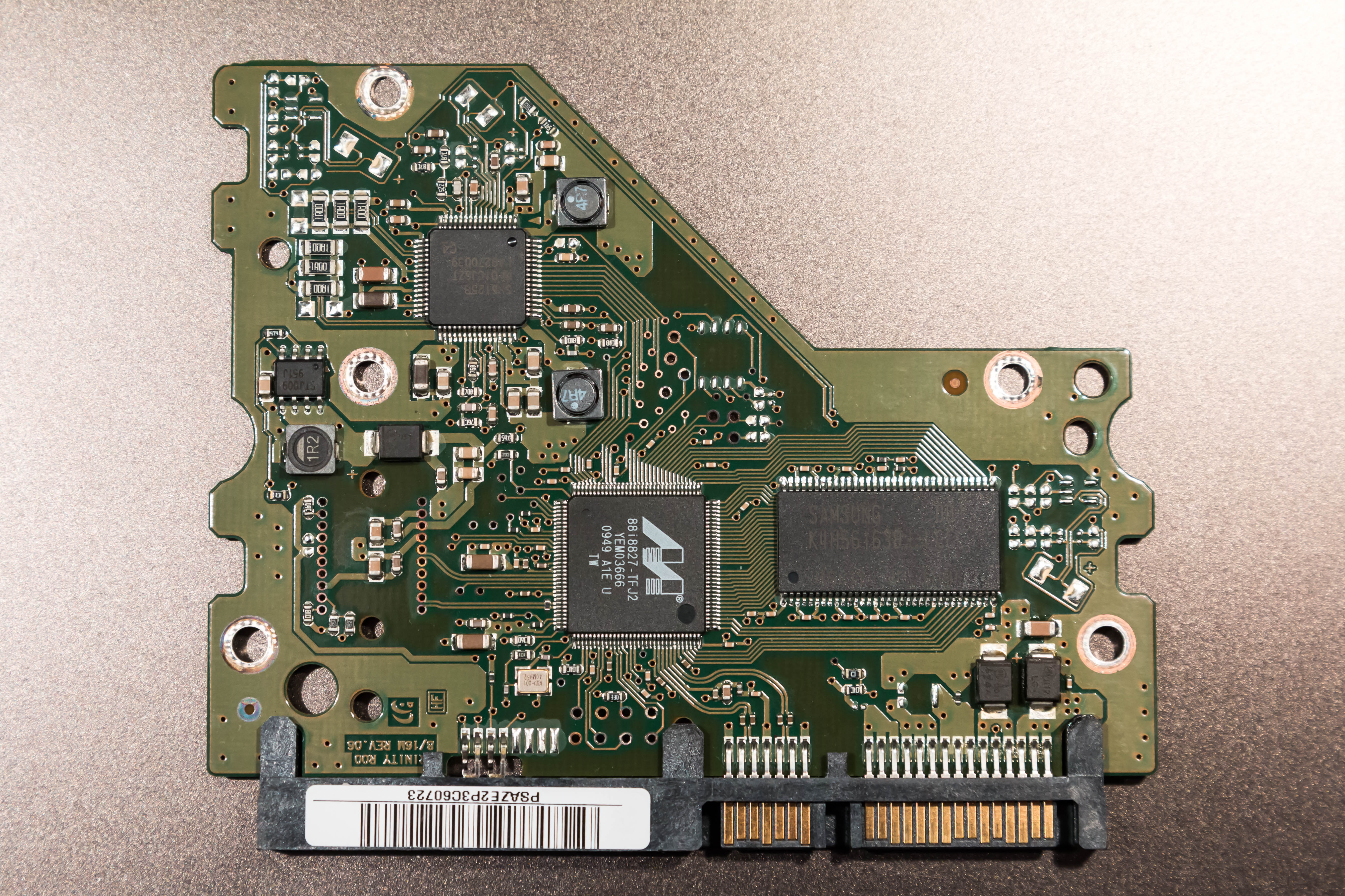

This time I have disk Samsung HD103SI. After connecting power from computer power supplier to disk computer is restaring. Also connecting only PCB still computer restaring.
At the begging I check diodes, so I replace one of them. But after that still is the same problem.
Could you help me with diagnose this PCB? I attached photo my PCB.

@lasek, "restarting" suggests that the computer is in some kind of boot loop. A shorted TVS diode would cause the PSU to shut down. Could you clarify what you mean?

OK. I have working computer with windows. So after when I connecting power to disk from power supplier this computer then computer shut down in the moment. This problem only with this one disk.

Then you need to follow Spildit's advice.
http://www.users.on.net/~fzabkar/HDD/HD103SJ_TVS_2.jpg

Once again thank you for your help. I replaced both diodes and now pcb and disk works.
