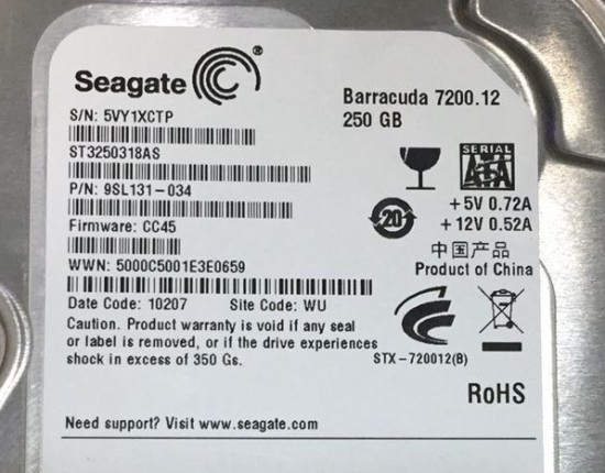

I have Seagate ST3250318AS it stuck on BSY
the terminal keeps giving me this over and over:
LED:000000CD FAddr:00258A17
I replaced head and still the same issue ??
HDD label attached

head was damaged but after replaced head this happed
it clicks several times then comes to ready
after running utilities i can read model and SN good but firmware showing CC44 which is the firmware of the donor drive and the size is MB ()
when i try to do anything it stuck on BSY DRD DSC.
I have terminal access while it is ready
i am using pc3k
here is log:
