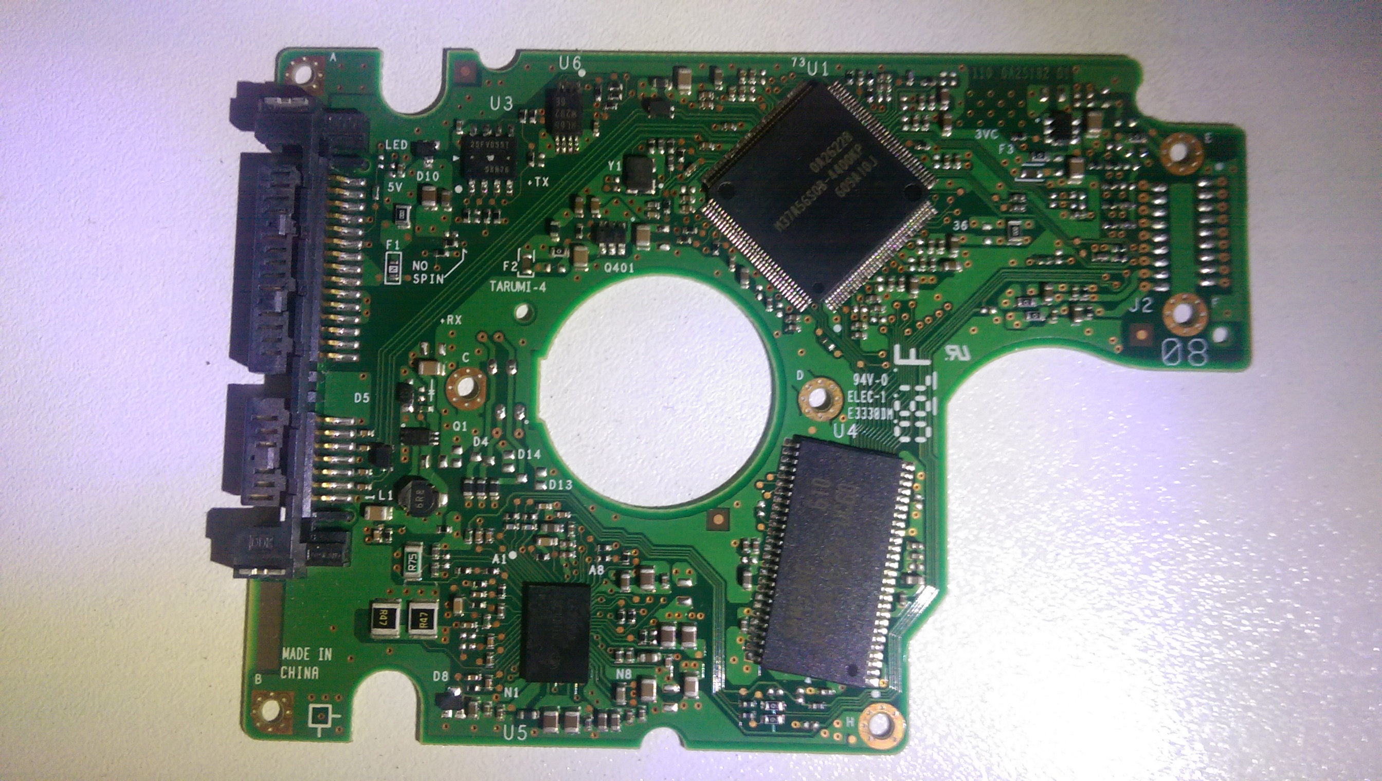

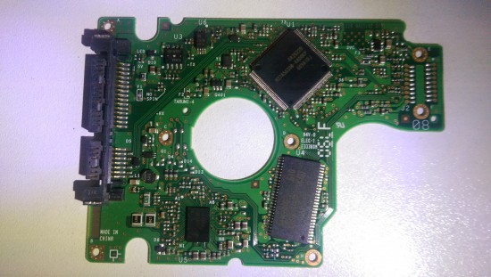

when ever it comes to Hitachi drive i feel depressed even before i start troiubleshoot the issue !
i have this HTS54060G9SA00 , which is not spinning .. initial diagnostics of PCB shows nothing unusual , client claims that drive was used in old laptop , never dropped , never anyhting ..
luckly i have an identical donor , but it doesnt spin as well , and its PCB shows nothing important to notice at all ..
i tested the fuse , its OK
please be kind enough to take a look at the PCB and point me in case you have experience with this model ..
thanks in advance

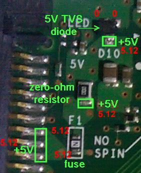

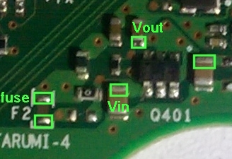

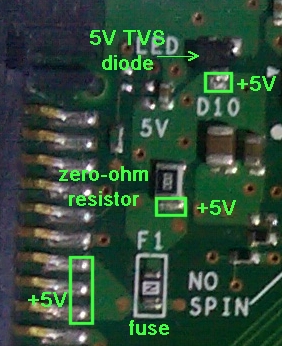

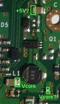

The photo is unclear, but I would measure these points:
The attachment Vcore.jpg is no longer available
The attachment TVS_fuse.jpg is no longer available
The attachment Q401.jpg is no longer available
The attachment F3.jpg is no longer available

appreciate your kind support in this matter ..
please find below the requested measures ..

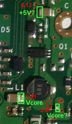

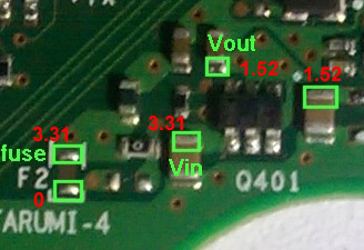

It appears that the DC-DC converter which I assumed was the Vcore supply is in fact a +3.3V Vio supply. Therefore I now suspect that Q401 is the +1.5V Vcore pass transistor. The other +1.5V linear regulator could be involved with the preamp.
In short, ISTM that the 3 supply voltages are probably OK.
