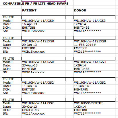

I don't think that the OP gave enough info to render a helpful opinion.
Here is a small sampling of successful head swaps. I guess to give a full picture I should have documented the cases where the swaps don't work.
I haven't 100% confidence what is going to work ahead of time, but I suspect that the manufacturer might be important.
