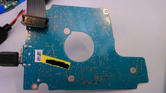

Hello to all the community!
do any of you have the pinout to connect the COM/terminal to the TOSHIBA MQ 2,5" USB boards?
If yes, can you kindly share it?
The goal is to read the ROM through terminal on TOSHIBA USB boards
thank you
Cor

Here you are
Mikippp

Have you soldered two pins in the first two holes of the row?
Thank you

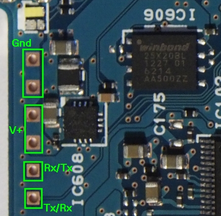

 Post subject: Re: MQ01UBDxx0 TOSHIBA 2,5" USB terminal pinout wanted (if a
PostPosted: January 26th, 2017, 15:12
Posts: 17314
This would be my guess:
PostPosted: January 26th, 2017, 15:28
Joined: June 25th, 2006, 13:51
Posts: 143
Location: Italy
Yes confirmed
