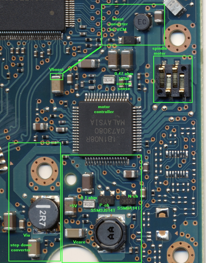

I have a 2TB Hitachi 5K3000 that has an annoying issue of not always spinning up. No mechanical clicking or anything, it just doesn't spin up. Tried with both 3.3V and 5V supplies, this doesn't seem to make any difference. When the drive spins up, it works just fine for as long as it's not spun down. It's a rather fresh drive (<1000h on) but was cast aside due to this issue.
Anyone encountered this before, and is there a remedy?

Alternatively, if there is a problem with the PCB, then there may be a way to fudge a "solution", provided that the motor controller uses external current sense resistors. Could we see a photo of the component side?

I'll open her up.

Here's a CCD scan: http://imgur.com/a/9tkvz

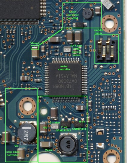

I couldn't find an external current sense resistor for the spindle motor, so I expect that sensing is done internally. There is an 0.47 ohm sense resistor, but it appears to be for the VCM circuit. The other sense resistor (0.1 ohm) is in the Vcore circuit.
It may be worth checking Vboost. This voltage is used by the high-side MOSFETS in the VCM H-bridge. These MOSFETs are involved in head positioning.
Just FYI, the following device is used in a particular Seagate SCSI drive. It enables the MOSFET to monitor its own current, without the use of a resistor.
NIMD6302R2, ON Semiconductor, Dual N-Channel Self-protected FETs with 1:200 Current Mirror FET, 30V, 5A, SOIC-8, marking N6302:
http://www.mouser.com/catalog/specsheet ... 02r2-d.pdf
SSM3J314T, Toshiba, P-ch MOSFET, -30V, -3.5A, 54mohm RDSon, marking KDU:
https://toshiba.semicon-storage.com/inf ... ?did=10375
SSM3K14T, Toshiba, N-ch MOSFET, 30V, 4A, 39mohm RDSon, marking KDK:
http://www.maoye-smd.com/canshu/pdf/201 ... M3K14T.pdf
http://datasheet.octopart.com/SSM3K14T(TE85L,F)-Toshiba-datasheet-13716475.pdf
MX25U4035, Macronix, Serial Multi I/O (MXSMIO) Flash, 4Mbit, 1.8V:
http://www1.futureelectronics.com/doc/M ... MI-25G.pdf
K4T56163QN-HCE7, Samsung, DDR2-800 5-5-5 SDRAM, 1.8V, 256Mbit, 84FBGA:
http://www.mt-system.ru/sites/default/f ... rev103.pdf
