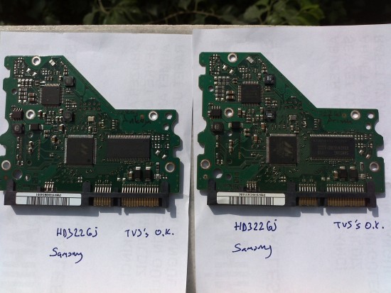

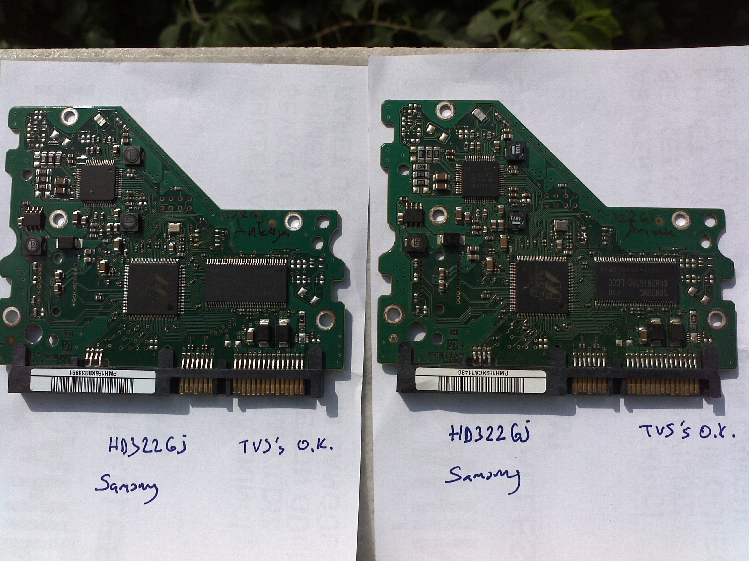

i recovered app 10 HD322GJ that all of PCB faulty
it doesn't spin. And there is no visible error on PCB.
TVS's O.K.
What should I suspect part?

Thanks for reply.
i desolder rom chip from faulty pcb as you can see...
i recovered disks via rom transfer. Disk spins normally.
i 've five HD322GJ that needs pcb for this common problem...
Maybe main chip or easy problem?

Measure the Vcore, Vio and Vneg voltages:
http://www.users.on.net/~fzabkar/HDD/HD103SJ_regs.jpg
thanx for reply.
i have 3 broken boards of hd322gj.
at diode mod
vio(up) vio (down) Vneg
A 0,646V 0,082V 0,180V
B 0,635V 0,068V 0.180V
C 0,685V 0,108V 0,190V

bad motor controllers

ok what are the expected value?
 Post subject: Re: Another Samsung HD322GJ Problem
PostPosted: June 19th, 2017, 3:10
Posts: 17323
2.5v, 1.2v (?) and -5v
confirm 12v and 5v at diodes

Well,
Sometimes The Zero Ohm Resistor in Series From Main Supply is Open ,Please Check That Too ,Very Common In These PCB 's

he probably measured voltages without supply, in diode mode across the tvses, so it is not very meaningful
