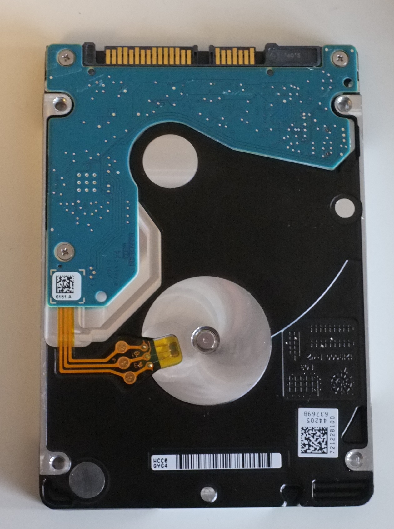

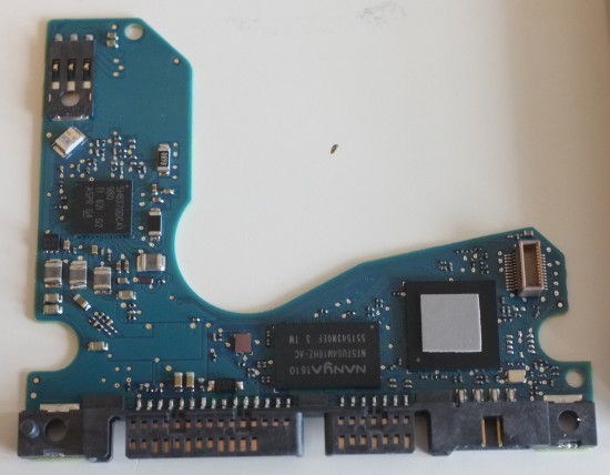

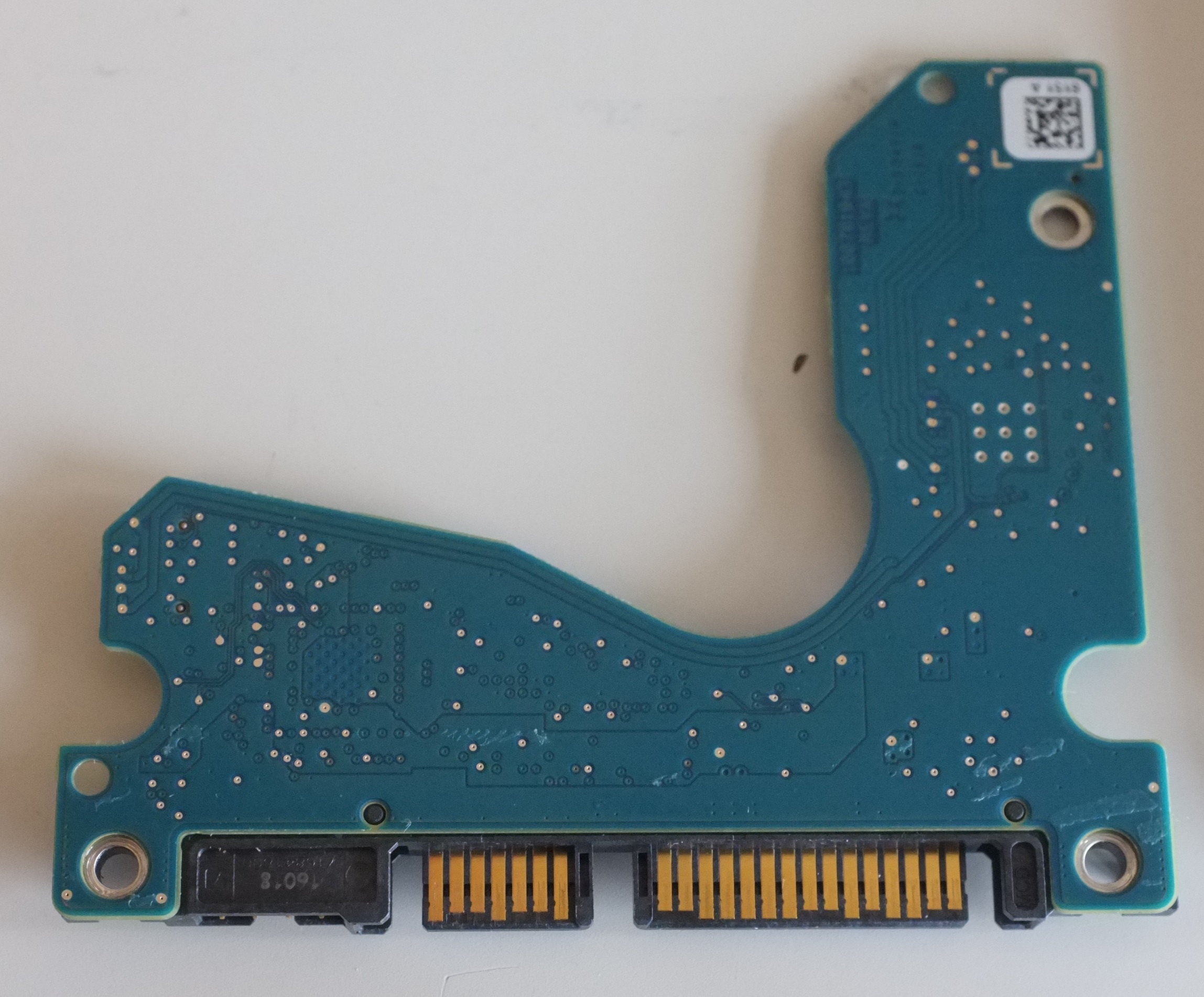

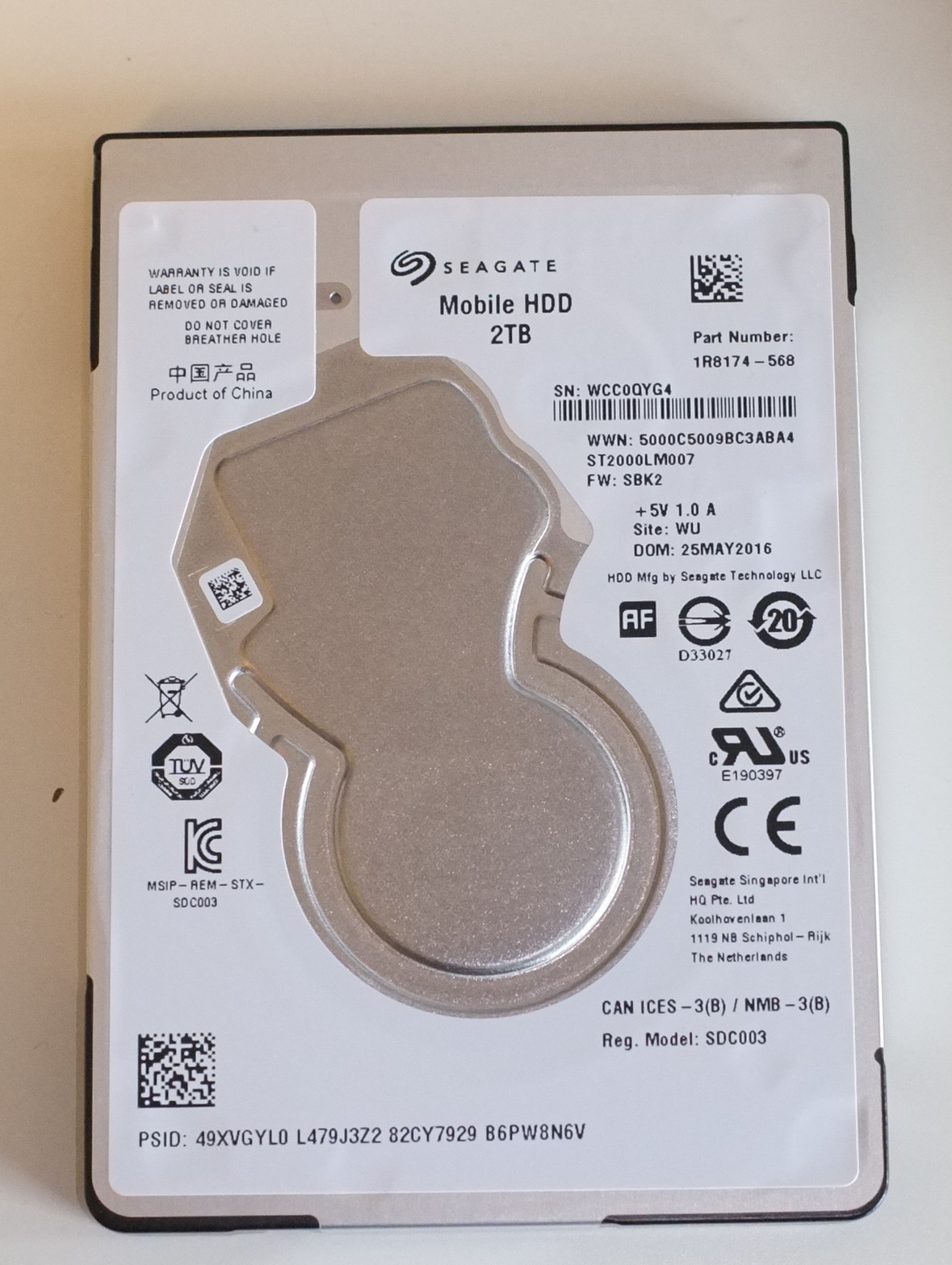

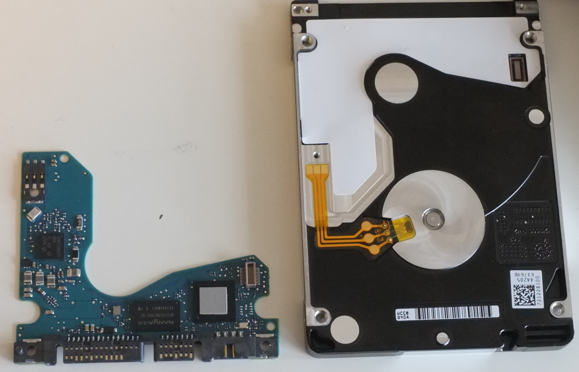

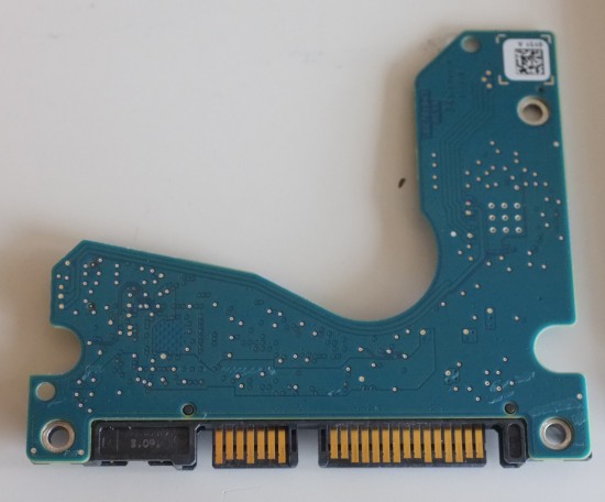

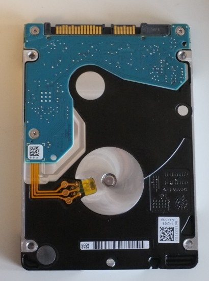

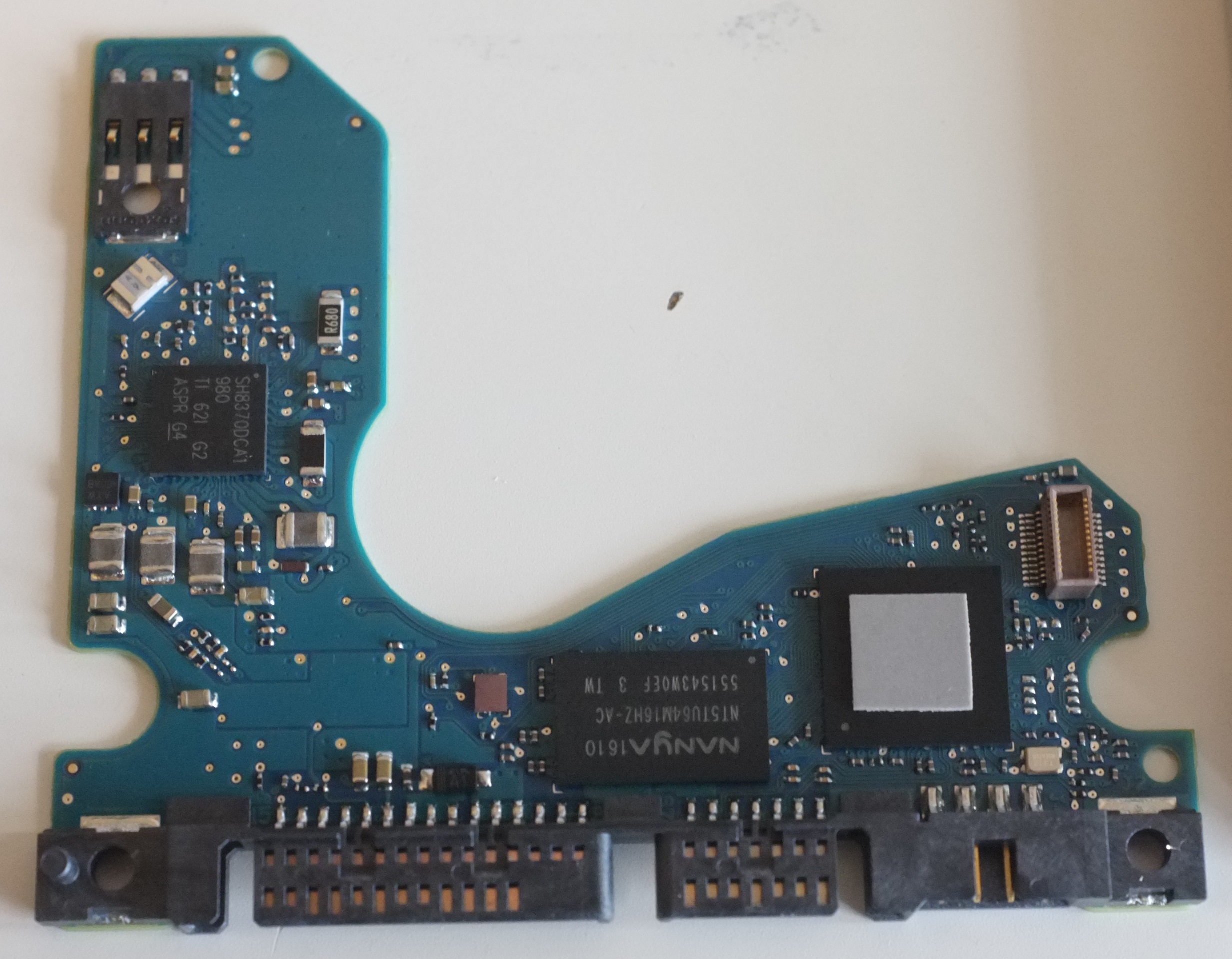

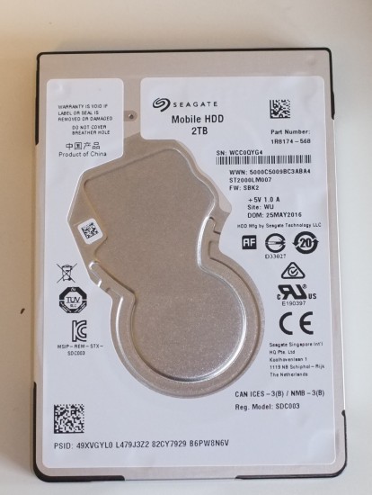

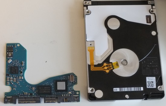

Can you please upload a picture of hard disk and its pcb picture also, may be its possible to unlock ROM.
 Post subject: Re: ST2000LM007 - MCMT table is corrupted
PostPosted: November 15th, 2016, 7:09
Posts: 306
Location: Manchester, UK
Images of drive and PCB are attached. ROM content looks like it is integrated in MCU.
PostPosted: November 15th, 2016, 11:01
Posts: 791
Yes, can repair FW issues on that drive with FW SBK2.
https://www.mjm.co.uk/
