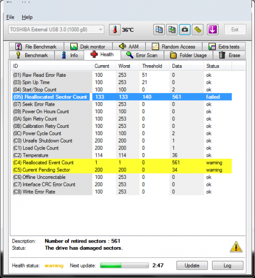

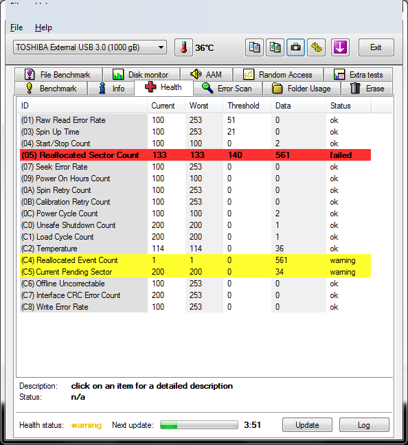

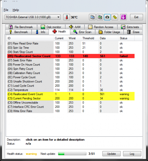

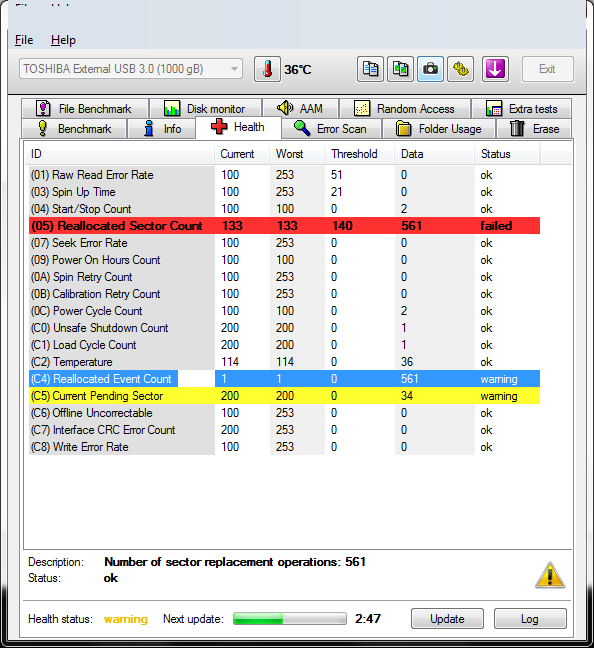

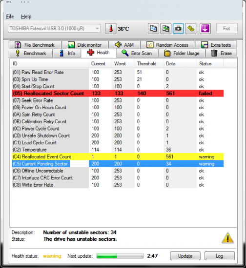

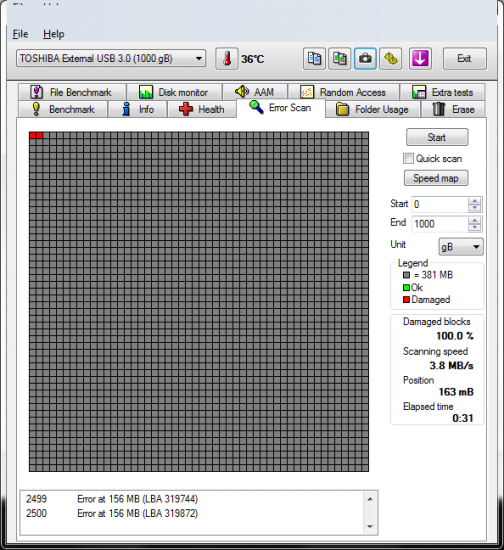

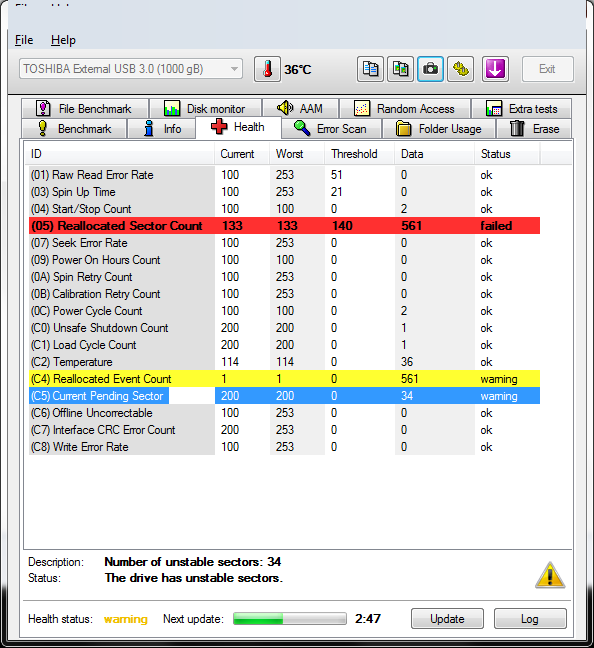

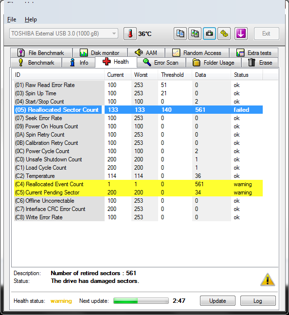

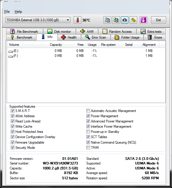

I have a WD LiveTVHub mediaplayer with an internal 1 Tb 2,5 inch Western Digital Scorpio Blue harddrive (type WD10TPVT)
For some reason the disk is not detected anymore in the mediaplayer.
As the drive contains a lot of useful information I want at least to recover the data.

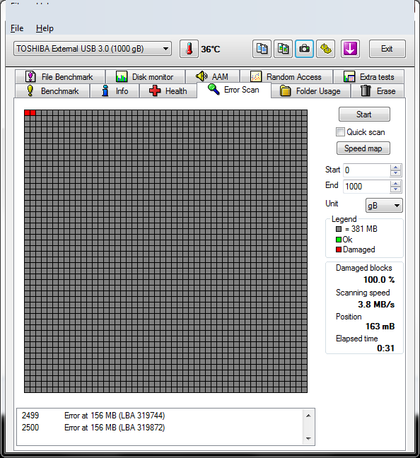

I used a program called 'HD Tune' to diagnostic the HDD.
Attached you will find a log from the error scan and here are some printscreens from the software.
Hopefully it is usefull and you can tell me how to proceed with the repair:
P.S. If I have to use other software or you want other information please instruct me

File comment: Error Scan
Many thanks for your help !!!

Toshiba =/= Western Digital Scorpio Blue harddrive (type WD10TPVT)

@Studijo, I would use HDDSuperTool to read the firmware modules. Then I would try the "slow fix". Finally I would attempt to clone the drive with HDDSuperClone.

@Moltke, the harddrive is a Western Digital but this drive has a SATA interface.
I used a laptop and a SATA to USB converter from an external harddrive from Toshiba.
This is the reason you see in the software and in the logging 'Toshiba External USB 3.0'

The drive could be detected if you wait lo-o-o-ng enough. The heads are OK and the surfaces are damaged only in the beginnig. Most of the data can be recovered, but not by you. The name of the problem is "Slow responding" and it's typical for the modern WD drives. To solve it you need S/W able to modify the configuration module in a suitable manner. Good luck.
