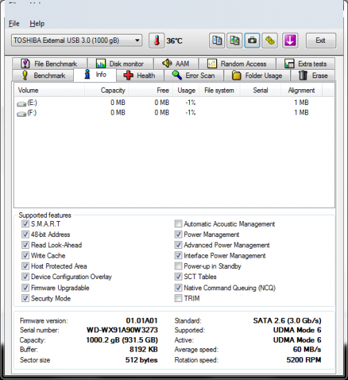

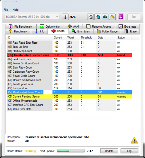

 Post subject: How to proceed with repair of WD Scorpio Blue HDD
PostPosted: June 21st, 2017, 13:10
Joined: June 21st, 2017, 7:39
Location: Belgium
I have a WD LiveTVHub mediaplayer with an internal 1 Tb 2,5 inch Western Digital Scorpio Blue harddrive (type WD10TPVT)
For some reason the disk is not detected anymore in the mediaplayer.
As the drive contains a lot of useful information I want at least to recover the data.
I used a program called 'HD Tune' to diagnostic the HDD.
Attached you will find a log from the error scan and here are some printscreens from the software.
Hopefully it is usefull and you can tell me how to proceed with the repair:
P.S. If I have to use other software or you want other information please instruct me
File comment: Info
Info.png [ 38.65 KiB | Viewed 12198 times ]
File comment: Health
Health.png [ 44.32 KiB | Viewed 12198 times ]
File comment: CPS
CPS.png [ 46.71 KiB | Viewed 12198 times ]
File comment: REC
REC.png [ 46.87 KiB | Viewed 12198 times ]
File comment: RCS
RSC.png [ 46.79 KiB | Viewed 12198 times ]
File comment: Error Scan
Error Scan.png
Error Scan.png [ 32.9 KiB | Viewed 12198 times ]
Many thanks for your help !!!
File comment: Error Scan Log file
Error_scan_log.txt [84.36 KiB]
Downloaded 782 times
 Post subject: Re: How to proceed with repair of WD Scorpio Blue HDD
PostPosted: June 21st, 2017, 13:13
Joined: October 24th, 2005, 17:04
Posts: 242
Toshiba =/= Western Digital Scorpio Blue harddrive (type WD10TPVT)
 Post subject: Re: How to proceed with repair of WD Scorpio Blue HDD
PostPosted: June 21st, 2017, 15:31
Posts: 17336
@Studijo, I would use HDDSuperTool to read the firmware modules. Then I would try the "slow fix". Finally I would attempt to clone the drive with HDDSuperClone.
http://www.sdcomputingservice.com/hddsupertool/download
http://www.sdcomputingservice.com/hddsupertool/scripts/wd_royl_dump_mod_all?attredirects=0&d=1
http://www.sdcomputingservice.com/hddsupertool/scripts/wd_royl_patch_mod02?attredirects=0&d=1
http://www.sdcomputingservice.com/hddsupertool/scripts/wd_royl_patch_mod32?attredirects=0&d=1
http://www.sdcomputingservice.com/hddsuperclone/download
 Post subject: Re: How to proceed with repair of WD Scorpio Blue HDD
PostPosted: June 21st, 2017, 15:42
Joined: June 21st, 2017, 7:39
Location: Belgium
@fzabkar, thanks for your reply but HDDSupertool runs on Linux. I have computers running on Windows and Mac but none on Linux.
Any alternative?
 Post subject: Re: How to proceed with repair of WD Scorpio Blue HDD
PostPosted: June 21st, 2017, 15:44
Joined: June 21st, 2017, 7:39
Location: Belgium
@Moltke, the harddrive is a Western Digital but this drive has a SATA interface.
I used a laptop and a SATA to USB converter from an external harddrive from Toshiba.
This is the reason you see in the software and in the logging 'Toshiba External USB 3.0'
 Post subject: Re: How to proceed with repair of WD Scorpio Blue HDD
PostPosted: June 21st, 2017, 16:25
Joined: June 21st, 2017, 7:39
Location: Belgium
When the disk was working well, some months ago, I already connected the harddrive to my laptop using the same SATA to USB convertor.
I tried this because the mediaplayer was slow and with the converter I could access the drive through USB 3.0 When I did I could see the filestructure in Windows Explorer. Later on I reinstalled the drive in the Mediaplayer and updated and downgraded the firmware from the mediaplayer (not from the harddrive). After downgrade of the mediaplayer the HDD was no longer found in the player so I connected again to my pc but same problem...
 Post subject: Re: How to proceed with repair of WD Scorpio Blue HDD
PostPosted: June 21st, 2017, 16:32
Joined: May 21st, 2007, 16:10
Posts: 1592
Location: Gothenburg/ Sweden
Hi, contact member Marc at http://www.datarecuperatie.be He will be able to help you.
http://www.rescue-it.se
 Post subject: Re: How to proceed with repair of WD Scorpio Blue HDD
PostPosted: June 24th, 2017, 15:23
Posts: 849
The drive could be detected if you wait lo-o-o-ng enough. The heads are OK and the surfaces are damaged only in the beginnig. Most of the data can be recovered, but not by you. The name of the problem is "Slow responding" and it's typical for the modern WD drives. To solve it you need S/W able to modify the configuration module in a suitable manner. Good luck.
