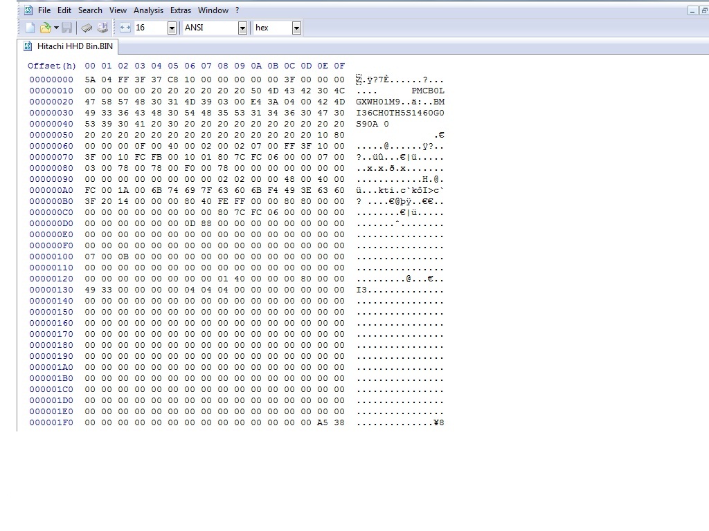

With this dump file which i got with HDAT tool from my HITACHI sata laptop drive which is locked with ATA password i try the master password but no luck.
Here Is Dump File.

The HDAT2 file is the Identify Device info block.

Spildit wrote:
The "DUMP" file of HDAT will not help you at all.
As already stated on the mentioned posted articles I can unlock your drive but you would have to ship it to me (Portugal) and pay shipping costs + unlocking fee ....
Maybe someone near you can unlock the drive as well for a cheaper price ?

I try to use MHDD to get dump file bt no luck use zu its say not supported device
is there any other tools tat i can get dump with it ? and to sending the drive
will be costy bcoz its just a 60.gb driver and its avalible here 800.pkr rs its just from a frnd want
to use it as external drive kindly tell me is serdev etc is easy to use so i can buy and use.
Zu supports G9. Only the correct order of action is needed (and dot-specifier)

Spildit, thx i got it but i ask u another question which software get a dump file from hard drive then MHDD ? which is easy to use i face many drive every WD SEAGATE TOSHIBA ETC so kindly let me know if you got some one. and how can i buy sediv ?
