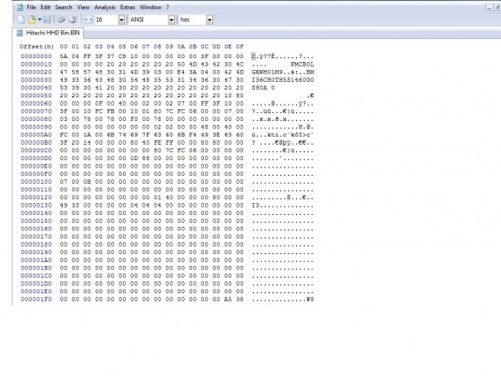

 Post subject: PLZZZZZZ EXPERT HELP ABT THIS DUMP FILE
PostPosted: June 22nd, 2017, 2:28
Joined: June 22nd, 2017, 2:07
Posts: 20
Location: pakistan
HELLO
I am a new user and join this forum with believe tat i will find my way here so plz guide me
With this dump file which i got with HDAT tool from my HITACHI sata laptop drive which is locked with ATA password i try the master password but no luck.
Here Is Dump File.
Untitled.jpg [ 253.71 KiB | Viewed 9642 times ]
 Post subject: Re: PLZZZZZZ EXPERT HELP ABT THIS DUMP FILE
PostPosted: June 22nd, 2017, 5:34
Joined: February 22nd, 2016, 6:39
Posts: 114
Location: india
viewtopic.php?f=1&t=35402
Read this artical
 Post subject: Re: PLZZZZZZ EXPERT HELP ABT THIS DUMP FILE
PostPosted: June 22nd, 2017, 16:09
Posts: 17230
The HDAT2 file is the Identify Device info block.
 Post subject: Re: PLZZZZZZ EXPERT HELP ABT THIS DUMP FILE
PostPosted: June 22nd, 2017, 18:39
Posts: 842
Location: Pakistan
Spildit wrote:
The "DUMP" file of HDAT will not help you at all.
As already stated on the mentioned posted articles I can unlock your drive but you would have to ship it to me (Portugal) and pay shipping costs + unlocking fee ....
Maybe someone near you can unlock the drive as well for a cheaper price ?
yes we can also do it for a cheap price. :)
Data Recovery Pakistan
 Post subject: Re: PLZZZZZZ EXPERT HELP ABT THIS DUMP FILE
PostPosted: June 24th, 2017, 19:46
Joined: June 22nd, 2017, 2:07
Posts: 20
Location: pakistan
Thx All
I try to use MHDD to get dump file bt no luck use zu its say not supported device
is there any other tools tat i can get dump with it ? and to sending the drive
will be costy bcoz its just a 60.gb driver and its avalible here 800.pkr rs its just from a frnd want
to use it as external drive kindly tell me is serdev etc is easy to use so i can buy and use.
 Post subject: Re: PLZZZZZZ EXPERT HELP ABT THIS DUMP FILE
PostPosted: June 25th, 2017, 19:09
Joined: October 24th, 2005, 17:04
Posts: 242
zu its say not supported device
Zu supports G9. Only the correct order of action is needed (and dot-specifier)
 Post subject: Re: PLZZZZZZ EXPERT HELP ABT THIS DUMP FILE
PostPosted: June 26th, 2017, 4:09
Joined: June 22nd, 2017, 2:07
Posts: 20
Location: pakistan
Spildit, thx i got it but i ask u another question which software get a dump file from hard drive then MHDD ? which is easy to use i face many drive every WD SEAGATE TOSHIBA ETC so kindly let me know if you got some one. and how can i buy sediv ?
Users browsing this forum: No registered users and 209 guests
