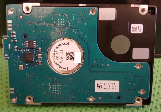

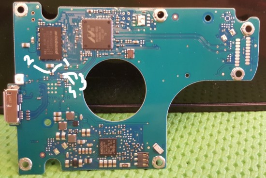

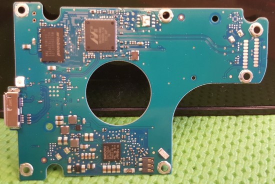

 Post subject: USB to SATA pinout FOR M9T BP
PostPosted: July 24th, 2017, 8:40
Posts: 441
Location: italy
i am looking for a pinout to transfor this pcb into a sata one.
FOR M9T BP
20170724_125101.jpg [ 143.75 KiB | Viewed 10587 times ]
20170724_125045.jpg [ 156.44 KiB | Viewed 10587 times ]
 Post subject: Re: USB to SATA pinout FOR M9T BP
PostPosted: July 24th, 2017, 15:05
Posts: 17323
As a general rule, locate a photo of a SATA PCB with the same MCU, and then follow its SATA Tx/Rx differential pairs from the MCU to the SATA connector.
 Post subject: Re: USB to SATA pinout FOR M9T BP
PostPosted: July 25th, 2017, 0:42
Joined: June 27th, 2005, 8:27
Posts: 615
See attached pic.
DF :)
Inked20170724_125045_LI.jpg [ 1.06 MiB | Viewed 10498 times ]
DF :)
www.datatracksystem.net
 Post subject: Re: USB to SATA pinout FOR M9T BP
PostPosted: July 25th, 2017, 1:16
Posts: 17323
It's not the same MCU (88i1022-NDB2 versus 88i1025-NDB2), but it looks very similar:
https://sep.yimg.com/ay/yhst-14437584971410/91504261-6.gif
 Post subject: Re: USB to SATA pinout FOR M9T BP
PostPosted: July 25th, 2017, 1:53
Joined: June 27th, 2005, 8:27
Posts: 615
It's not the same MCU (88i1022-NDB2 versus 88i1025-NDB2), but it looks very similar:
https://sep.yimg.com/ay/yhst-14437584971410/91504261-6.gif
You quoted Seagate Rom and PCB above are of Samsung USB. both are different.
DF:)
DF :)
www.datatracksystem.net
 Post subject: Re: USB to SATA pinout FOR M9T BP
PostPosted: July 25th, 2017, 2:16
Posts: 17323
darkforce1 wrote:
It's not the same MCU (88i1022-NDB2 versus 88i1025-NDB2), but it looks very similar:
https://sep.yimg.com/ay/yhst-14437584971410/91504261-6.gif
You quoted Seagate Rom and PCB above are of Samsung USB. both are different.
DF:)
As I said, it's not the same MCU, but its pinout is similar. This means that the OP need only follow the 88i1022 MCU pins to the SATA connector. The 88i1025 CPU will most likely have exactly the same SATA Tx/Rx correspondence.
I was not suggesting that the two PCBs were interchangeable.
 Post subject: Re: USB to SATA pinout FOR M9T BP
PostPosted: July 25th, 2017, 10:23
Posts: 3598
Location: Chicago
There are SATA M9T drives in the world
 Post subject: Re: USB to SATA pinout FOR M9T BP
PostPosted: July 25th, 2017, 15:31
Posts: 17323
Doomer wrote:
There are SATA M9T drives in the world
Yes, but which one has the OP's MCU and motor controller (assuming I've read the part number correctly)?
 Post subject: Re: USB to SATA pinout FOR M9T BP
PostPosted: July 25th, 2017, 16:07
Doomer wrote:
There are SATA M9T drives in the world
Yes, but which one has the OP's MCU and motor controller (assuming I've read the part number correctly)?
I'm pretty sure it's PCB number: 100731207
I've been keeping a list of those on my forum too: https://www.data-medics.com/forum/samsu ... t1438.html
 Post subject: Re: USB to SATA pinout FOR M9T BP
PostPosted: July 25th, 2017, 16:18
Posts: 17323
data-medics wrote:
I'm pretty sure it's PCB number: 100731207
I've been keeping a list of those on my forum too: https://www.data-medics.com/forum/samsu ... t1438.html
I had already seen your database. Thanks. However, your PCB has an 88i1022-NDB2 MCU whereas the OP's appears to be 88i1025-NDB2.
 Post subject: Re: USB to SATA pinout FOR M9T BP
PostPosted: July 25th, 2017, 16:21
Posts: 3598
Location: Chicago
Doomer wrote:
There are SATA M9T drives in the world
Yes, but which one has the OP's MCU and motor controller (assuming I've read the part number correctly)?
100767980 and probably some others (aka SATA M9T BP) has 88i1025
Users browsing this forum: Majestic-12 [Bot] and 54 guests
