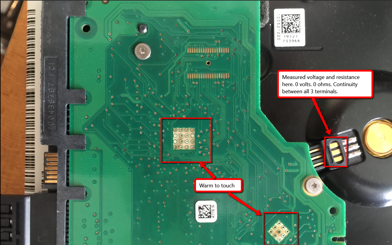

Thanks for the help. The drive really does not make any sound that I can hear.
On defective drive, IC's are warm to touch where I indicated in attached photo. 0 resistance and 0 voltage at motor terminals where measured in photo. Tested between all 3 terminals.
(BTW, as a sanity check, I measured motor terminals on a good drive and got 300 ohm and between 5 -15 milli volts on the good drive, not sure what range is to be expected)
Defective board looks kinda discolored to me at the 2 warm points, even more to the naked eye than in the photo.
File comment: Defective 7200.12
 Post subject: Re: Seagate ST31000528AS 1TB 7200.12, no spin, not recognize
PostPosted: September 17th, 2017, 18:41
Posts: 17326
The resistances between each pair of terminals should be the same and should be of the order of 1 or 2 ohms. I don't know why your good drive is showing 300 ohms. Are you measuring the resistance with power off?
The voltages at each terminal should be pulsing immediately after the spin-up command. The pulses should stop after 5.397 secs.
Is the good drive the same model? If so, does its PCB spin up your patient?
