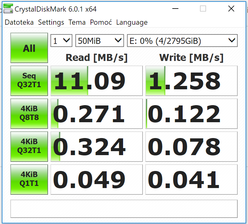

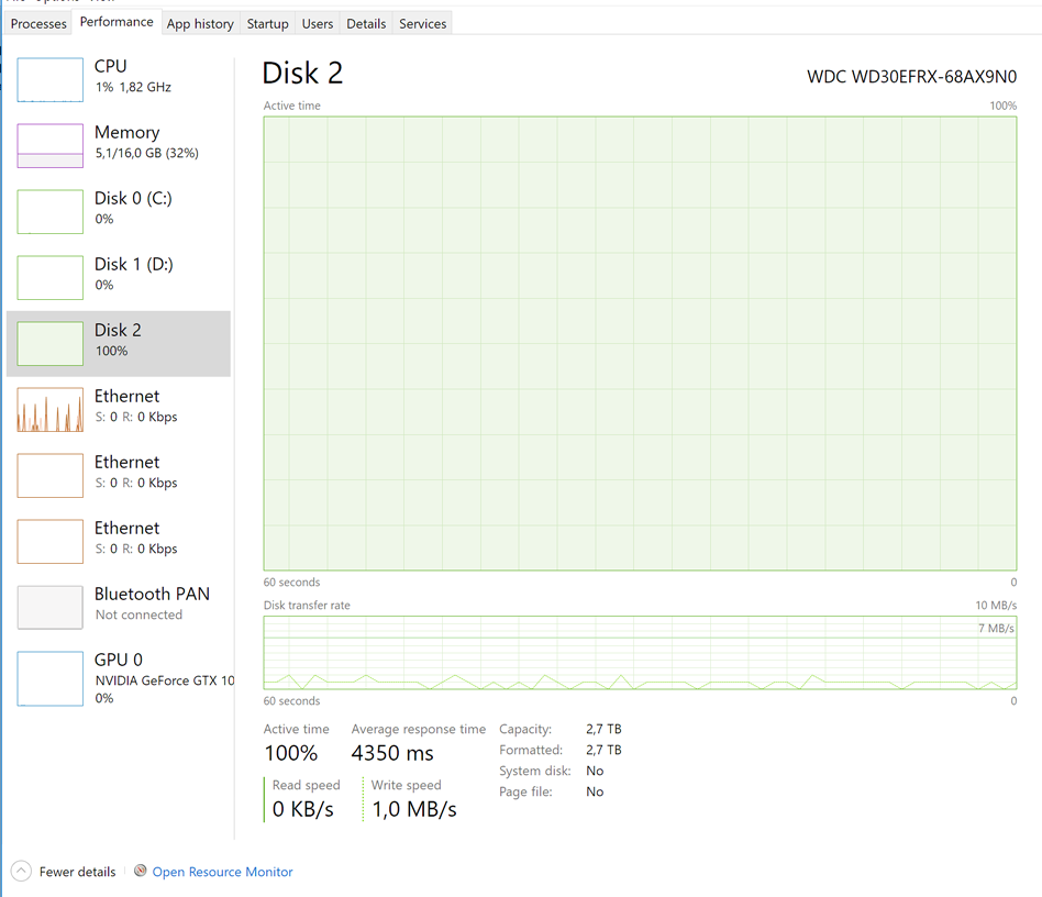

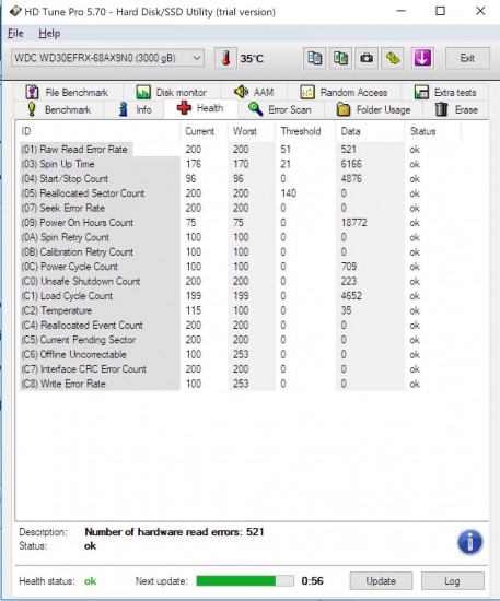

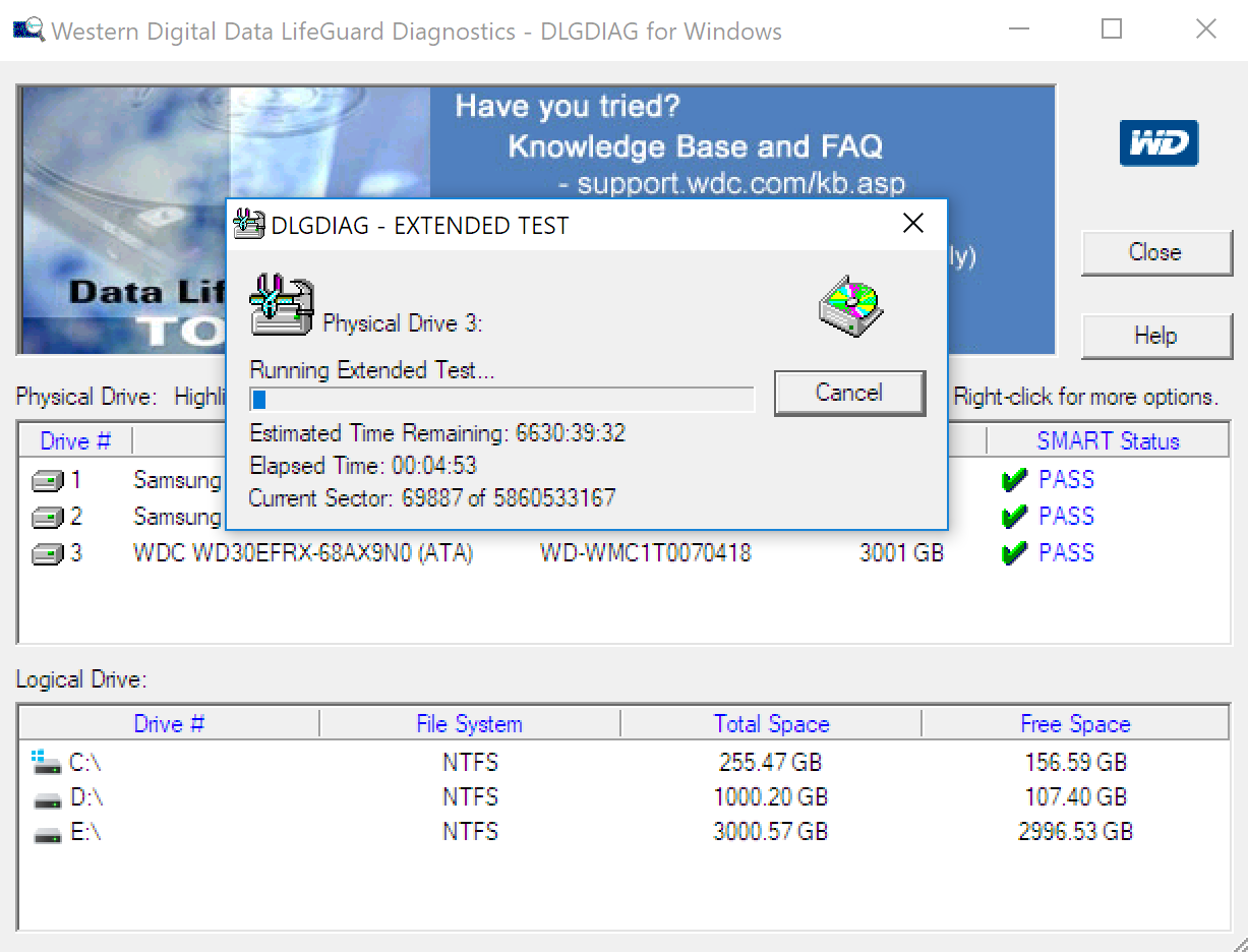

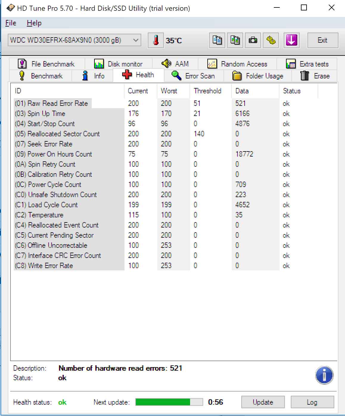

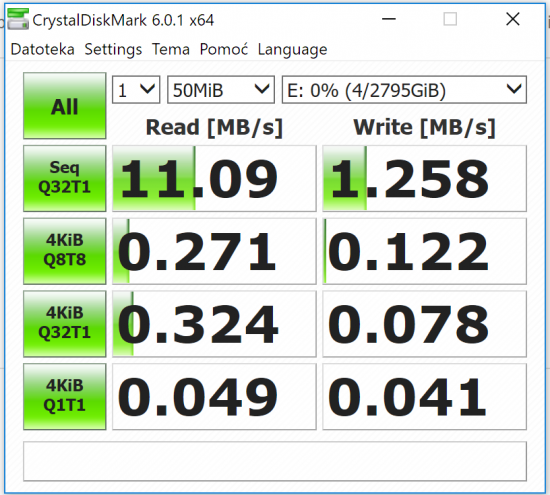

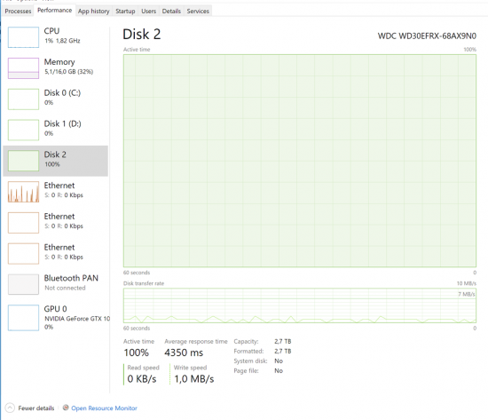

HDD has massive slowdown on reads an especially writes.
Writes are at 1MB/s.
Tried 3 computers, win7/10, free dos, same results.
Tried 3 different cables - same.
Tried different ports - same.
Reformatted, blanked, deleted - same.
Dont know what to do?
Any help would be appreciated.

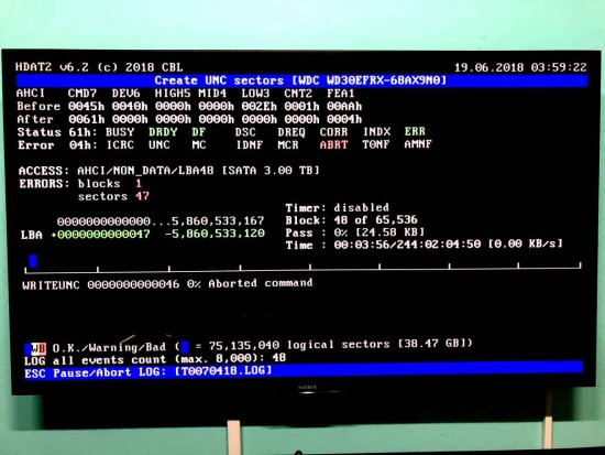

I set it to IDE and AHCI cant seem to find it with MHDD. in IDE mode there are 2 more controllers, but no hard drives...
I have Victoria for DOS and Windows, will check and get back

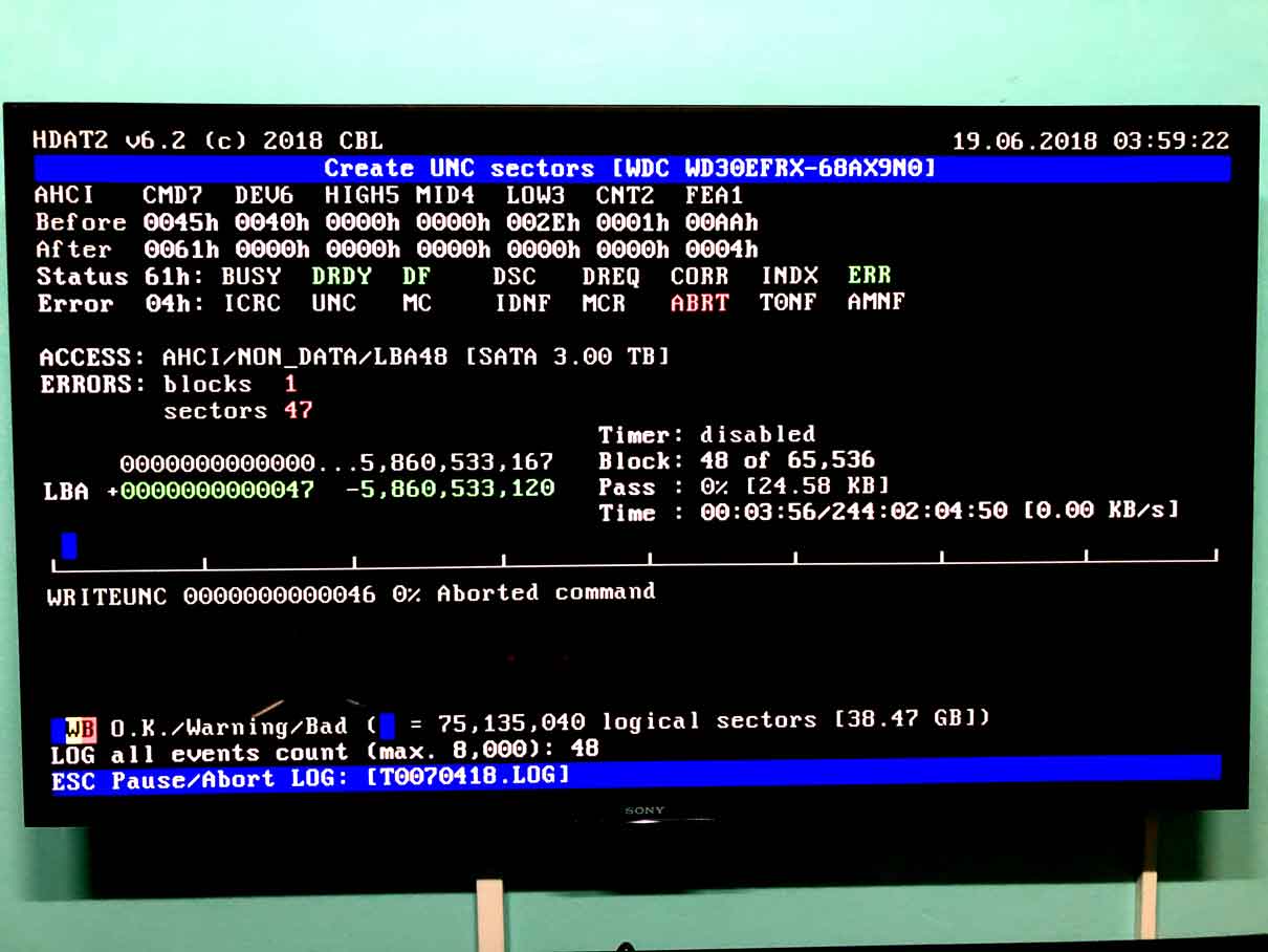

Victoria says
Unk.size; L/A=ON; Wr=ON;
Which means they are both on.
Seek test is like 300ms
Read test 256kb/s :D
Trying WD Marver

 Post subject: Re: WDC WD30EFRX-68AX9N0 Massive Slowdown
PostPosted: June 20th, 2018, 22:06
Posts: 992

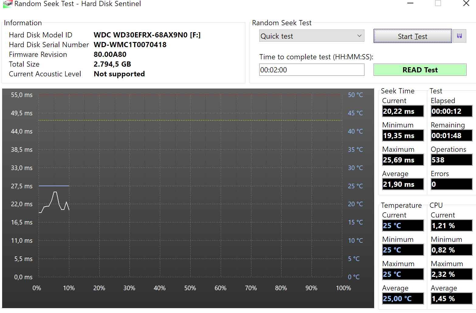

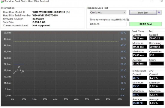

The answer might be in the average response time in the one image, which is 4350ms. A high response time without errors is usually an indication of the "slow" issue. The drive will read some data, then hang while the background scan is doing something, then read again, hang again... And as stated, who knows what the seller did to the drive. It can never be trusted with critical data for sure. But there is a way to disable the background scanning (aka the "WD slow fix"). Do a search on here for "slow fix" and look through the results... if Spildit doesn't post a more direct link before then :)

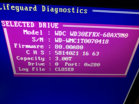

PostPosted: June 20th, 2018, 23:19
Joined: June 20th, 2018, 19:54
Posts: 23
Location: Serbia

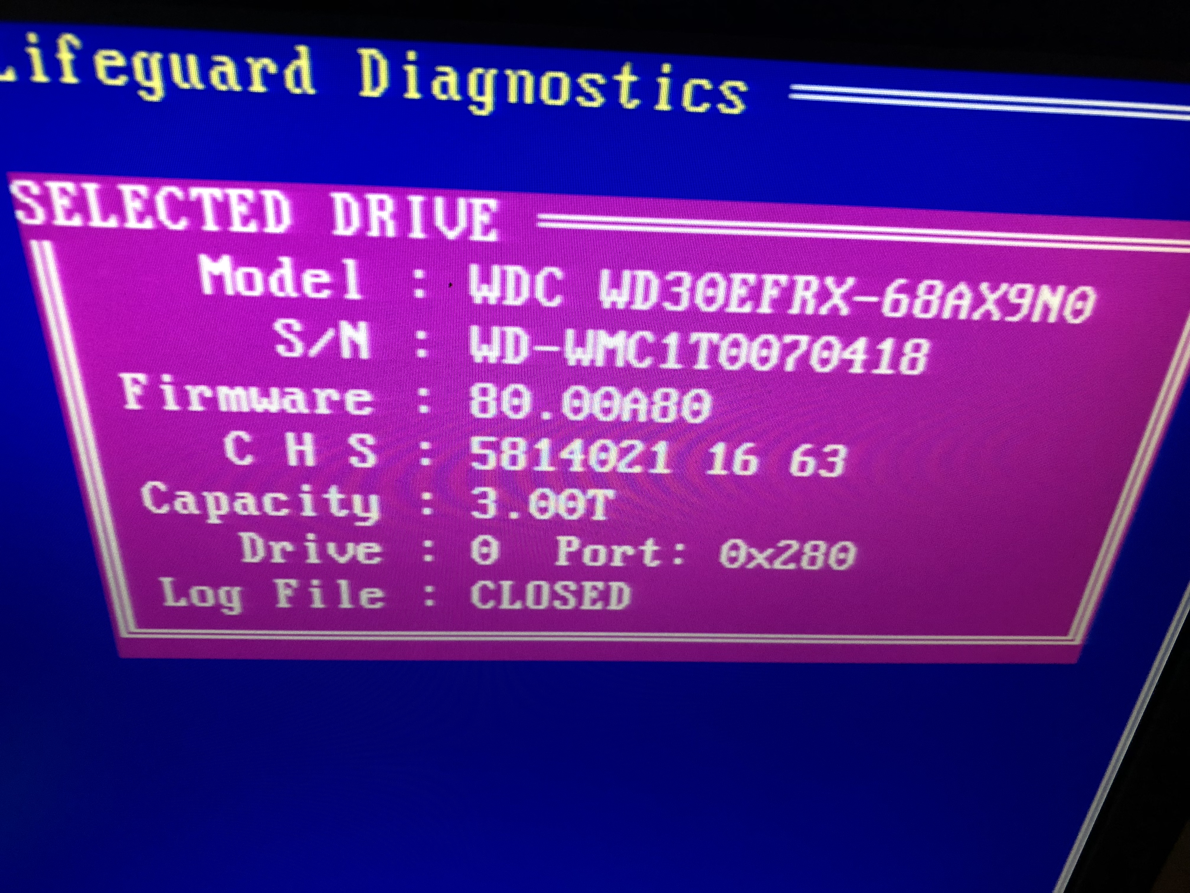

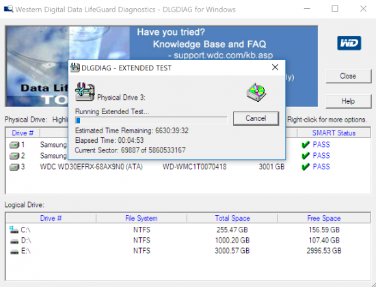

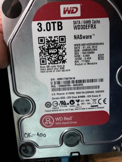

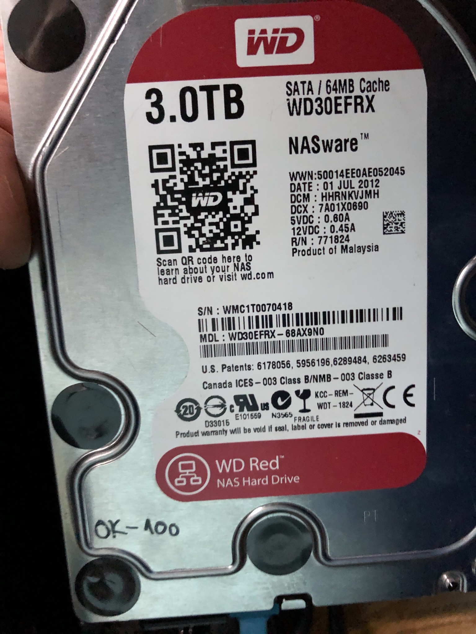

Hm the serial on the sticker and from dosdlg are he same. Does that mean no bad rom from another drive?

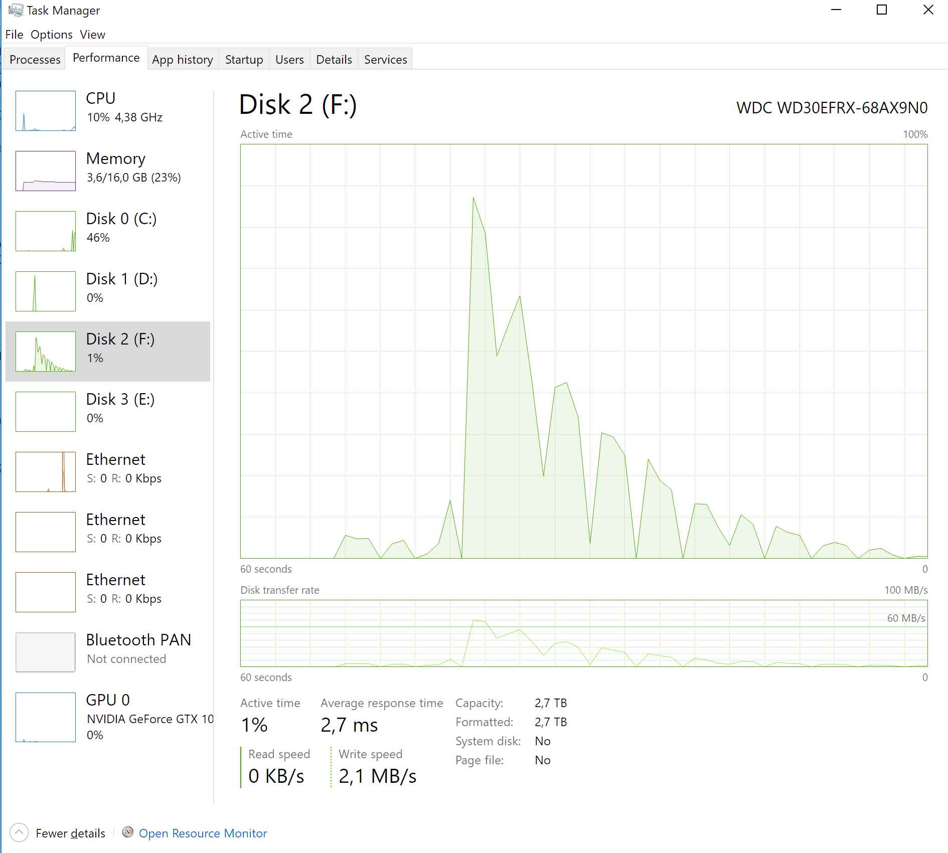

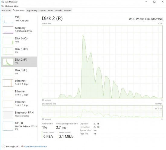

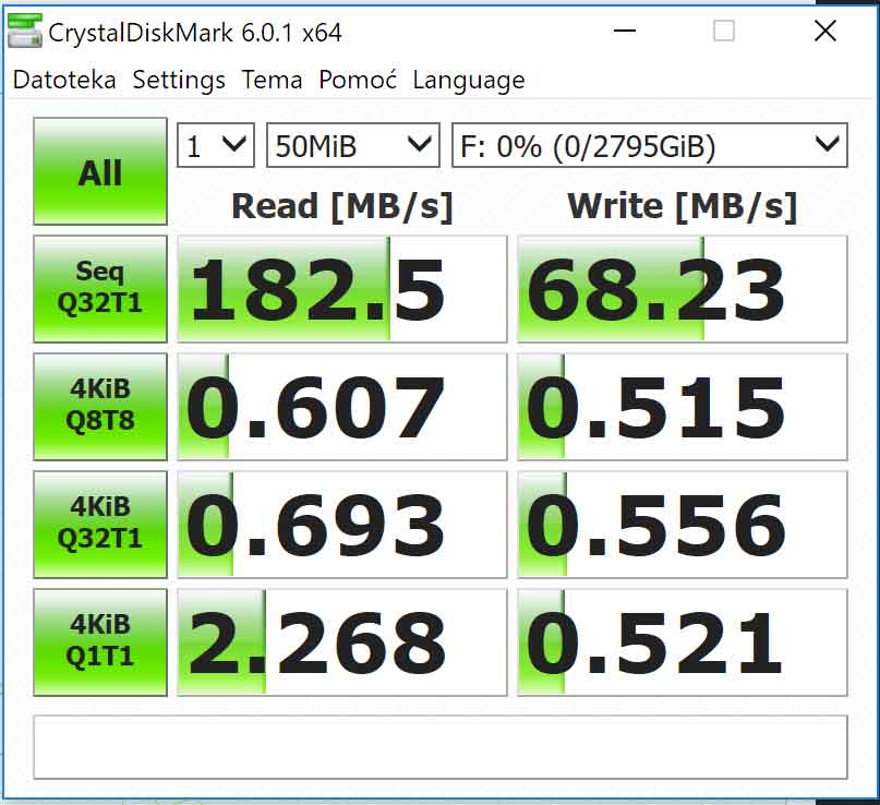

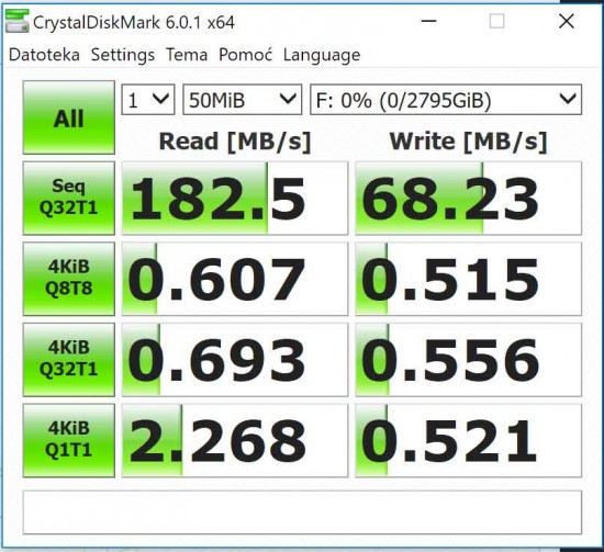

Ok, got something done :)
Found a WDR 6.0 Free version and combined an old PC for Win 7 32bit with IDE compatible mode.
Did bunch of thing on the hard drive (clear smart, p-list, g-list etc) no change.
Did manual "slow fix" and HDD came to life.
Read and Write speed not quite perfect, but seek time is, anyhow much better. Here are some screenshots.
File comment: See the strange ripple on file copy to the drive...
File comment: Bad non sequential transfers...

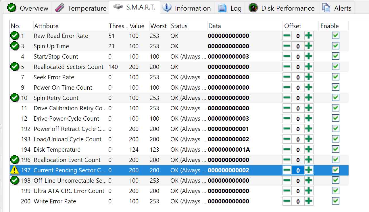

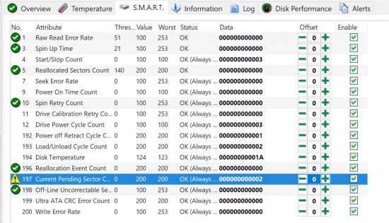

But, now I have another question :D
I have been playing with WDR and "fixing" old drives.
There is a problematic 2TB green drive, everything works fine, but when i did smart reset it would not erase #197 - Current Pending Sector Count.
I did surface test, Self Test, it just stays.
I tried manually changing module 21, even modified a .bas script so it shows me where are those SMART values in block 21 and 24.
While I can change block 24 - I cant 21. I write zeroes, a choose module write (same as i did for slow fix, and module 24) but it wont "take" :)
Any help with this?
Thank You all for opening this part of tech to me! :D
