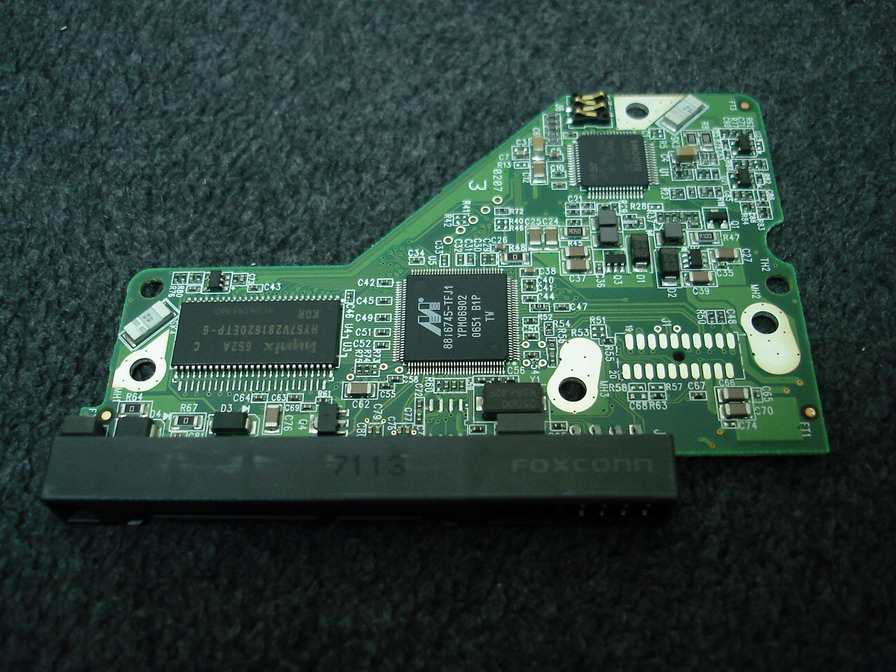

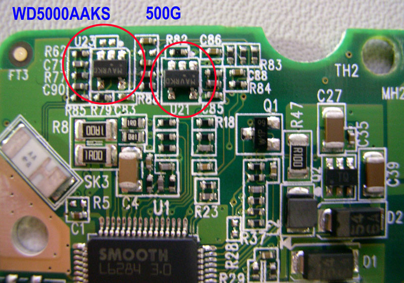

Hi Gurus
I have WD5000AAKS SATA 500G, it sounds like it is not enough power to start the motor, strugling to start.....it is not the motor problem or sticktion i have checked.
I suspect the motor controller SMOOTH L6284 but not 100% sure as i don't have the datasheet, anyone got one?
I have an identical drive with different firmware WD5000AAKS , swapped pcb from faulty drive to good drive, it sound exactly the same strugling to start motor.
Unfortunately WD5000AAKS has no flashrom, i think it is embedded in MCU, does anyone have any experience with this drive? Please look at the photo, what are these chips marked as U21 and U23? There's another one close to RAM but unmarked.
Thank for your help.

if the spindle runs freely, check the motor windings with an ohm meter and compare the values to the working one!
 Post subject: Re: WD5000AAKS SATA 500G what are these chips?
PostPosted: September 14th, 2007, 9:43
Posts: 1241
Location: inside ROM
Hi Pepe, yes the windings ok, 2.2ohms, do you think its the motor controller L6284 problems? Q1,Q2 etc are ok, diodes ok too :(

This is the pcb, can't see any ROM

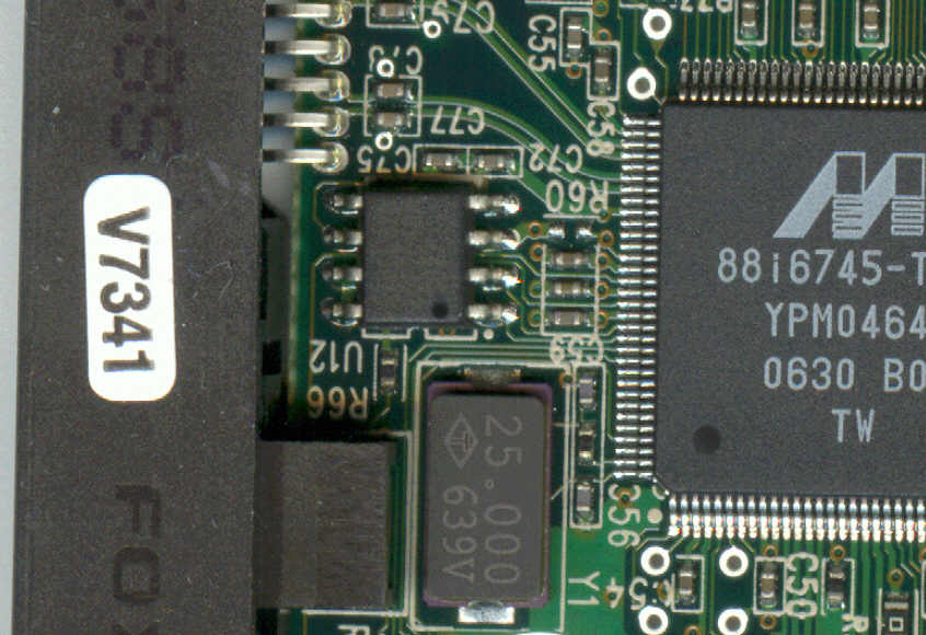

PostPosted: September 15th, 2007, 12:58
Joined: May 30th, 2005, 17:07
Posts: 550
ROM place on this PCB is U12
If drive is recognized as alias with good PCB... U have problem with SMOOTH...
U must replace SMOOTH, or find the same drive with very similar date... (the same ROM version)
PS Can U read ROM in PSV (kernel) mode...?
Mikippp
PostPosted: September 15th, 2007, 21:48
Posts: 1241
Mikippp, my pcb does not have the ROM chip, please see the photo i attached above, noticed the ROM chip isn't installed.

no cry, the new sata WD no flashrom, i have check WDs 320G 500G and 750G SATA all no flashrom

Yes. I have discover that this New Model AKS From WDC have No ROM. Rom was embedded in MCU. I suggest try to change SMOOTH Chip. If Not Change MCU but it hard to do.

Yes. New WDC SATA drives AAJS AAKS BEVS... have No Rom.
(Processor is 88i6745 instead of older 88i6545)
88i6545 need external serial Flash.
88i6745 have Flash memory embeded.
If processor is not damaged - it is possible to read ROM in PSV mode (4-jumpers)
