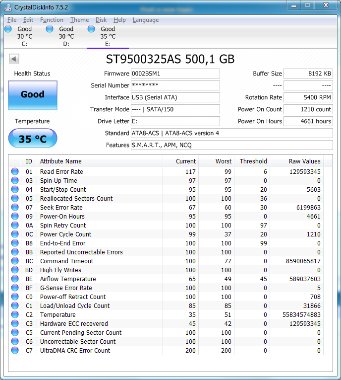

Hello :)
This HDD was extracted from Seagate Freeagent Goflex 500gb external enclosure bougth in 2010. Reason was, this case only supports USB 2.0. I wanted to put it in faster usb 3.0 box.
Then I run CrystalDiskInfo to check for badblocks etc. and everything seemed fine (attachment).
But one thing bothered me - Transfer mode SATA/150(attachment)
This drive should support 3.0Gbps speeds. I checked on other computer and the same thing (and on other usb3.0 enclosure - the same)
Then I remembered that old SATA Seagate drives could be jumper limited to 1.5Gbps. But there is no jumper on pins near sata connector. I tried putting jumper in all possible combinations (3) - no change.
So I connected this drive to UART adapter to work with putty terminal to get some info about it.
Here is Ctr+A log:

and I see this SpdLimit: 1.5Gb
I read F3 Seagate terminal commands documentation and could not find an option or command to change this setting.
Anybody knows if it is even possible or is it hardcoded in PCB or read only firmware?
Thanks for any information!

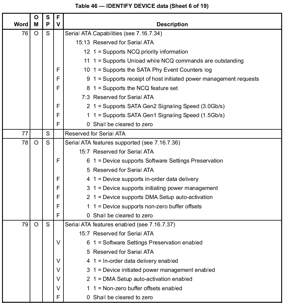

 Post subject: Re: st9500325as SATA interface limited to 1.5Gbps?
PostPosted: September 4th, 2018, 20:25
Posts: 17335
What does the drive report in words 76 - 79 of the Identify Device data block? You could use CrystalDiskInfo to retrieve this information.
In particular, word #76 reports whether the drive supports SATA Gen2 Signaling Speed (3.0Gb/s) and SATA Gen1 Signaling Speed (1.5Gb/s).
The corresponding bytes of the Congen Mode Page appear to be ...
Byte:0464: SATACapabilities = 0E 05
Byte:0465: Bit:0, SATA_NCQ_SUPPORTED = 1
Byte:0465: Bit:1, HOST_INITIATED_PHY_POWER_MANAGEMENT_SUPPORTED = 0
Byte:0465: Bit:2, SATA_PHY_EVENT_COUNTERS_SUPPORTED = 1
Byte:0465: Bit:3, UNLOAD_WHILE_NCQ_CMDS_OUTSTANDING_SUPPORTED = 0
Byte:0465: Bit:4, NCQ_PRIORITY_SUPPORTED = 0
Although the SATA speed settings are not explicitly listed, a value of 0Eh in byte 0464 corresponds to the settings for Gen1, Gen2 and Gen3. That is, all are enabled.

Identify Data for this HDD words 70-79
070: 0000 0000 0000 0000 0000 001F 0502 0000 0048 0040 .................H.@
076 is 0502, from my calculations for SATA 3.0Gbps should be 0504 - correct? Possible to change it?
