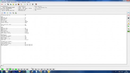

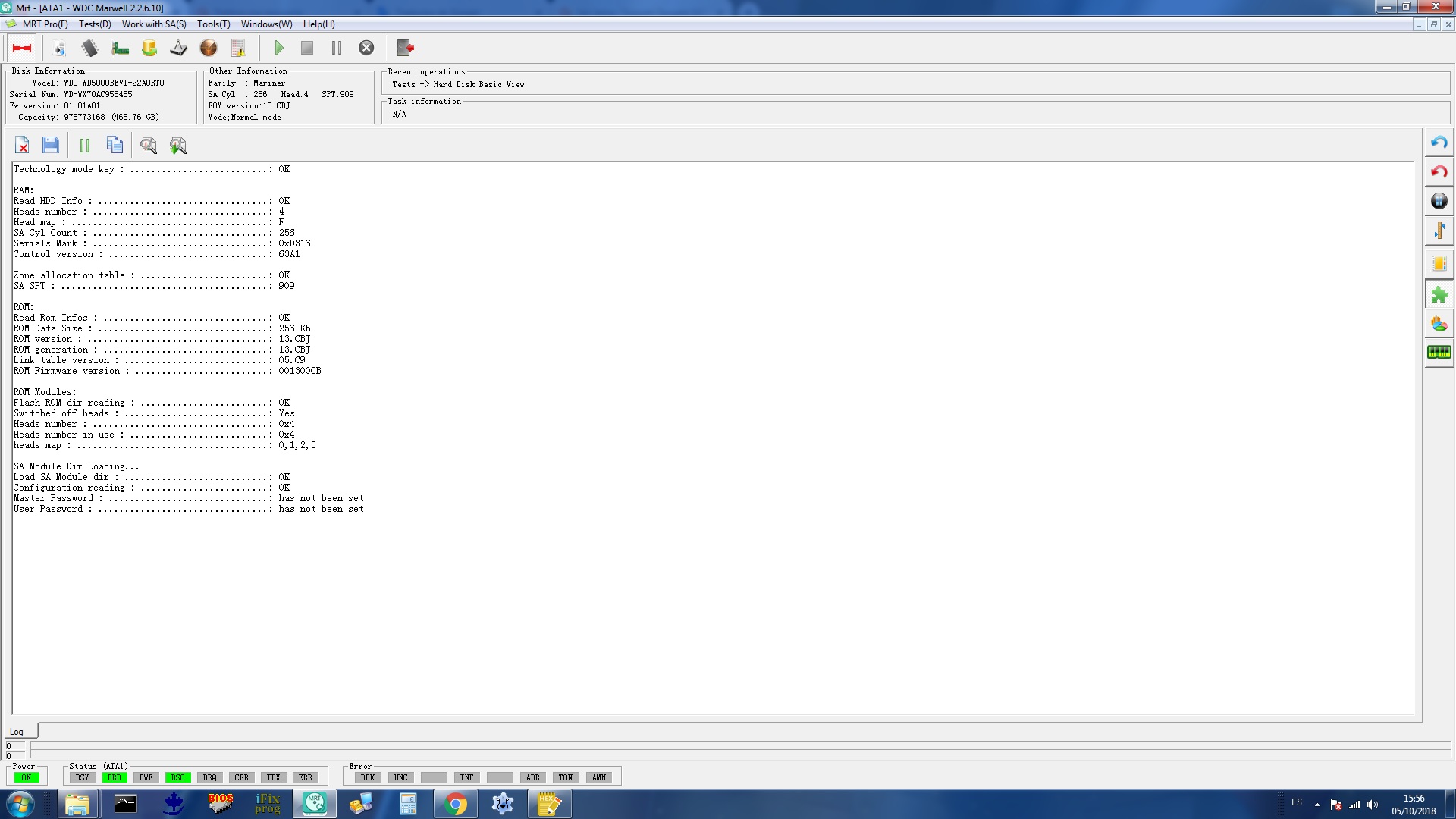

the data that I have of the hdd are:
MDL: WD5000BEVT-22A0RT0
WWN: 50014EE600B137F5
DATE: 28 NOV 2010
DCM: HVNTJVB
DCX: 5A060B4R6
R / N: 771672
PRODUCT MALASYA
The original bio makes the platters do not turn, if I put another bios of a similar disc, if they turn me on and logically I do not recognize it, but if I turn the platters.
The original bio in another similar disc also makes the platters do not rotate.
The original bio does the same thing on several similar discs

yes, I have MRT
Spildit wrote:
Do you have MRT or any other firmware tool ? Can you READ original ROM ? If so please do post it.
Does your PCB have an external ROM chip ? It should have. Can you read it with external programmer ? If you manage to get a dump please post it.
Now with compatible ROM+Loader can you gain access to SA ? If so you might be able to get some modules needed to regenerate the adaptives on ROM that you will be missing by the use of non-native ROM.
Also if the PCB does have external ROM you will NOT have a copy of ROM modules on SA... Or in better words there will be just templates without usefull data to regen ROM and you will need to use other tricks.
 Post subject: Re: BIOS WED5000BEVT-22A0RT0
PostPosted: October 12th, 2018, 4:59
Posts: 474
Location: spain
If with the original BIOS the disk is not set when starting a moment in bsy, and with the other of the same model if, it is that the original ROM is wrong (with a high% chance).
When you place the hard disk donor you must have access to the SA and then rebuild the ROM.
Have you tried this?
