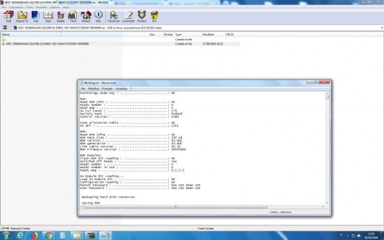

 Post subject: Re: Anonymus WD 3,5" missing label
PostPosted: October 18th, 2018, 7:51
Posts: 1768
Location: Verona, Italy
northwind wrote:
Switched off heads: ...........................: Yes
Heads number: .................................: 0x4
Heads number in use: ..........................: 0x4
heads map: ....................................: 0,1,2,3
it's just a stupid mrt bug, it always say in the log that heads are off.
See example:

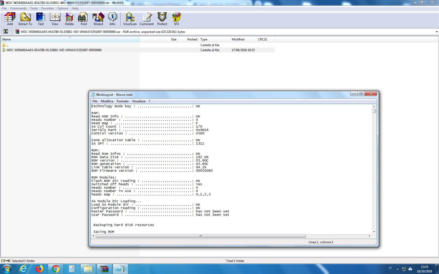

PostPosted: October 18th, 2018, 12:00
For a case like this, I'd compare the serial number (which should be on a sticker on the bottom of the drive) with other donors of the same family. That'll get you pretty close.
I see in my resources some 00500AP firmware versions with serial numbers around WCASY37... I'd bet yours is close to that, so just aim for an Atlantis family drive with similar serial and you'll probably get the heads you need.
PostPosted: October 19th, 2018, 18:24
Joined: September 14th, 2018, 13:41
Posts: 299
Location: italy
This is the serial found on the side : Wmasy3943080
PostPosted: October 20th, 2018, 7:55
Joined: May 5th, 2004, 20:06
Posts: 2782
Your drive WD6400AAKS WD BLUE
