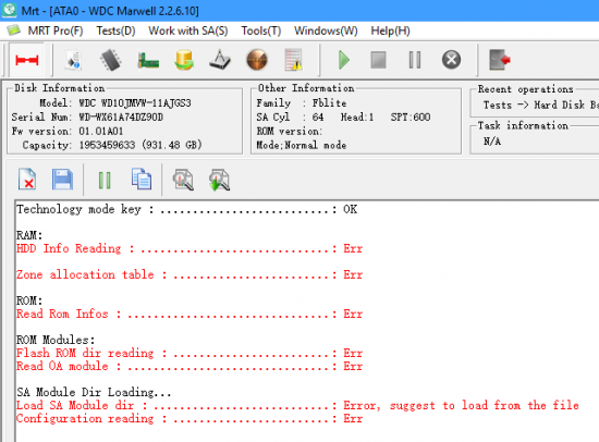

Hi
I have this drive from wd may passport, it recognised by windows and MRT and even I can do logical test, but MRT dont recognised any information about family and etc, I try to write loader using module 1b 11 and 411 and succesfull to do that, but notting changed, any help guys?

Maybe reading is difficult because of issues with pending process, or maybe is SED locked limiting access - without more information any responses will be relatively vague....
That's it.
@OP
You have to bypass SED to get access to FW.

Im new hear ,what is SED, could you tell me how to bypass SED?

this is log from mrt
is there any hope ?
i cant logic scan anymore
