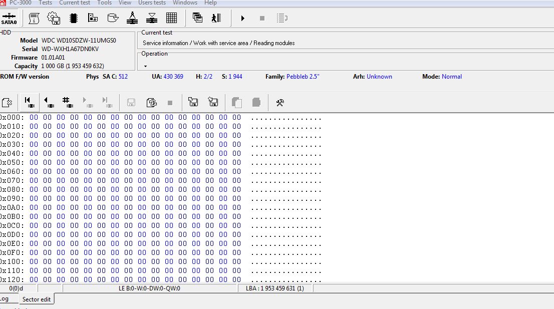

For now Palmer family can't be read SA. Some kind of encryption that still doesn't allow access to modules.
ACELab partner
 Post subject: Re: Wanted: WD USB SED Locked Drive
PostPosted: September 14th, 2018, 11:05
Posts: 3598
Location: Chicago
I can access those

WDC WD10SDZW-11UMGS0
