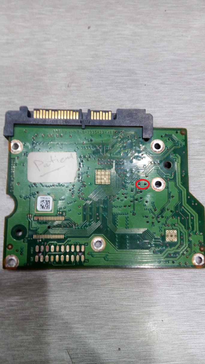

 Post subject: Re: ST500DM000 led BSY all time
PostPosted: December 6th, 2018, 19:59
Joined: July 9th, 2016, 11:31
Posts: 13
Location: Moscow
[quote="hddlab"]Hi all,
I want to share my hardly case with you.
Seagate ST500DM02; fw kc66
Led BSY all time. Can't get F3> with Ctr+Z
Rst 0x10M
MC Internal LPC Process
hdd stays bsy forever
Well could someone gimme a piece of advice which pins are needed to short to get finaly into F3> ?
PCB100535704 rev D
Tks in advance !
PostPosted: December 7th, 2018, 6:44
Posts: 842
Location: Pakistan
roger9 wrote:
hddlab wrote:
Hi all,
Rst 0x10M
PCB100535704 rev D
Tks in advance !

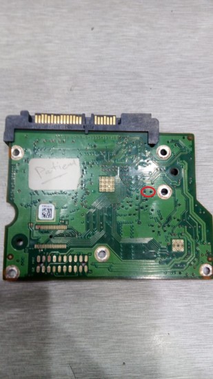

you must start a new thread, however these should be the points.
Data Recovery Pakistan
 Post subject: Re: ST250DM000 led BSY all time<==successfully recovery shar
PostPosted: December 7th, 2018, 15:48
Posts: 17266
Tip: How to identify the Read Channel test points:
http://www.hddoracle.com/viewtopic.php?f=24&t=123
